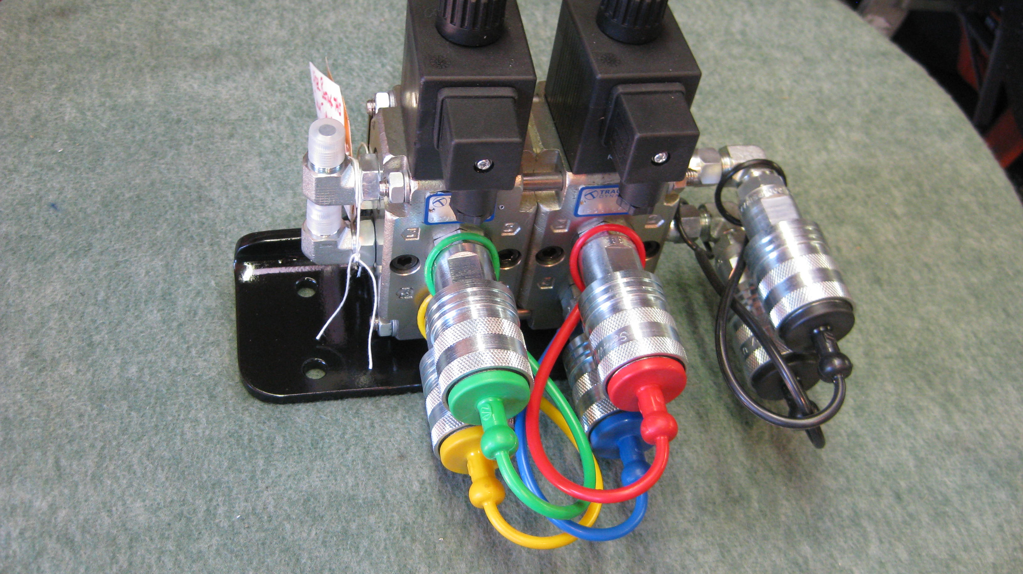

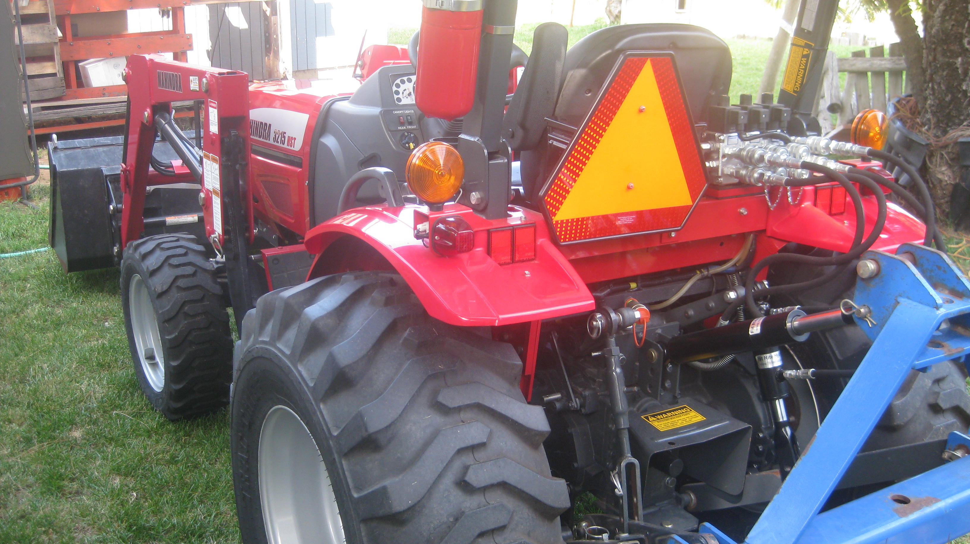

Stack them together.
I have 3 stacked on one of my tractors.
