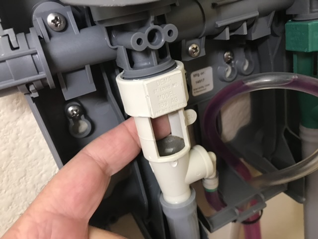

The first thing that comes to mind is a type of 'venturi' device/system.
/ Looking for a Chemical Injector #5
Could you make something like this work? You can put different size tips in to meter how much chemicals you want per gal. This happens to be a air gap version but I should have some older action gap back flow versions. I should have two GPM as well. One of them is 1gal/minute the other would be 4gal/minute.
That's what I've been looking for, but I haven't found one yet. Most venturi devices require a minimum of 2gpm. Depending on my nozzle I am between 1.2gpm and 2.4gpm.
I had to look that up because I had no idea what that was. That seems to be on the right track of what I'm looking for. I'll dig around based on that device and see what I can find. Thanks for the tip!
