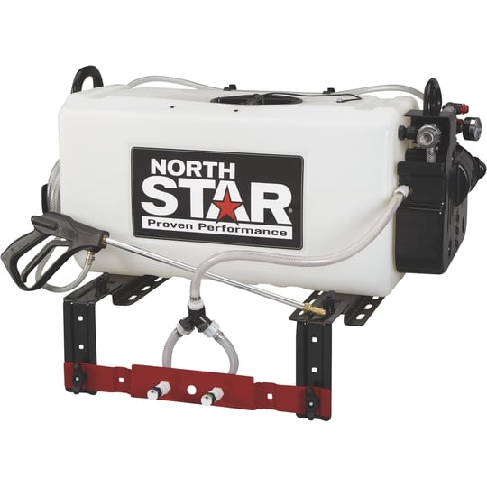

I Purchased, a Northstar spray rig 26 gallon tank with a 5 gallon a minute pump. I started calibrating it yesterday and it appears to me that the 5 gallon a minute pump is a lot more than I need for what I am doing on our place. Basically small food plots and I was setting up to control grass burrs in a couple of spots, but with a 5 gallon a minute pump in just a few minutes it would pull down half of the tank. I tried running the pressure way down, but it didn’t seem to make much difference. Is there anyway I can Reduce the flow output to where I would probably spray 12 to 15 gallons over an acre at 6-7 mph on my side by side. at the current right I am thinking I would have to drive 10 to 15 miles an hour to be able to put out the recommended amount of chemical per acre. The only thing I can think of is changing the boomernator 1400 ps nozzles to something smaller. Any suggestions are appreciate. I’d rather not have to buy $150 2 gallon a minute pump and replace the 5 gpm. Thanks

Is this your sprayer? I have this one, I mounted on a rack on my 3 point. It doesn’t have a boom but two spray nozzles that make a pretty wide pattern. Mine seems to spray out at a rate much slower than 5 gpm if I use the broadcast nozzles. If I use the wand it seems like it’s spraying at a much higher rate.

Is this your sprayer? I have this one, I mounted on a rack on my 3 point. It doesn’t have a boom but two spray nozzles that make a pretty wide pattern. Mine seems to spray out at a rate much slower than 5 gpm if I use the broadcast nozzles. If I use the wand it seems like it’s spraying at a much higher rate. View attachment 804623
Yes that’s my spray rig dual boomless Boominator 1400ps L&R nozzles I should have given more detail

I’ve never really timed mine but with the spray nozzle’s it just doesn’t seem to be putting out 5 gpm. In the picture above I was testing the spray pattern with water. I suppose you could fill it with water and see how fast it gets pumped out. If it’s really 5pm it should empty the tank in less than 5 minutes.

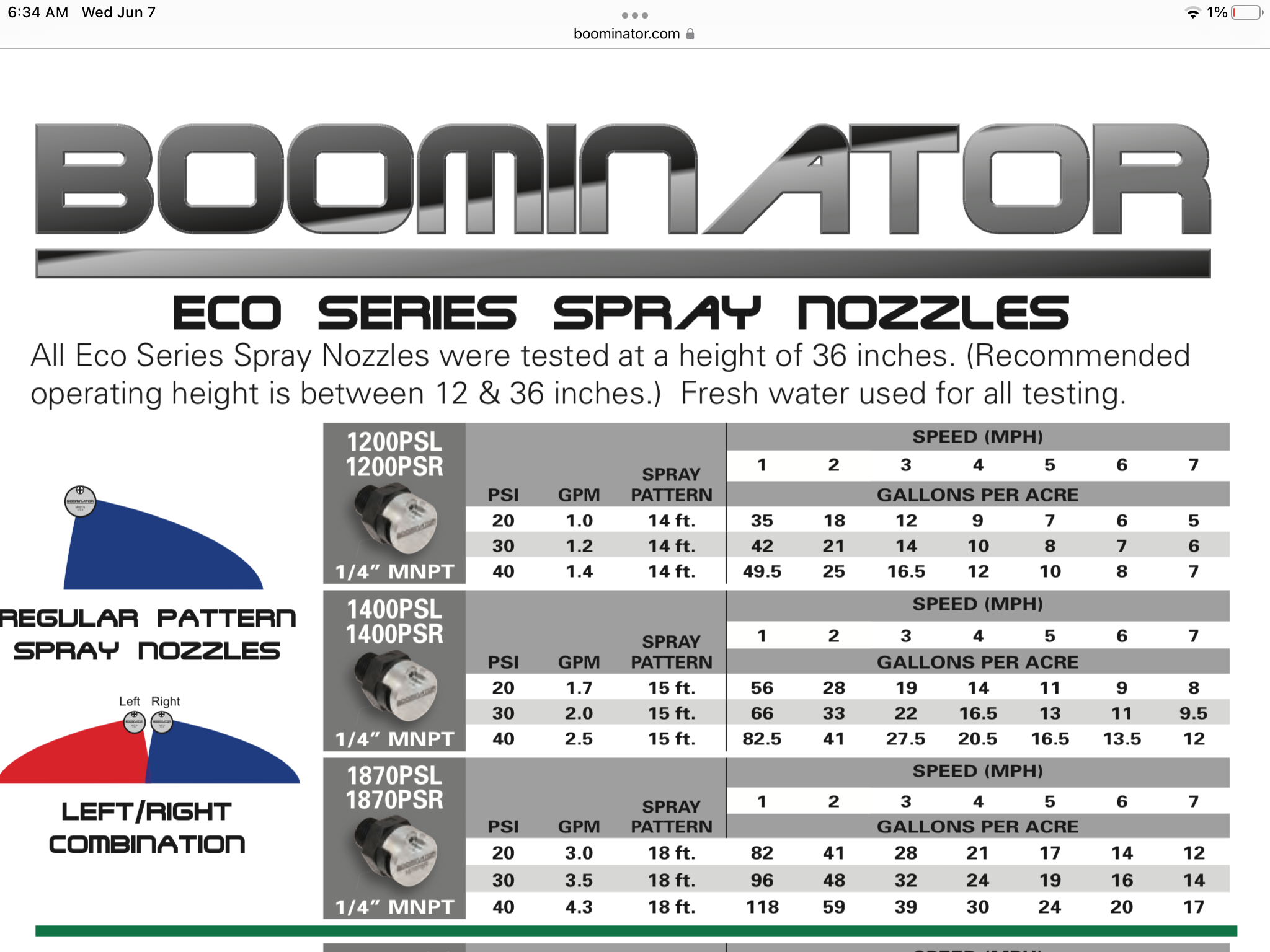

If you study the boominator nozzle chart that TractorTech left it tells you what you need to know. You’re 1400 size nozzles put out 13.5 gallons/acre @ 40psi traveling 6mph. This is based on a 15’ band width per nozzle, you would just raise or lower the boom to get your 15’ spray width. I’m assuming you can regulate you’re pressure down to 40psi. With sprayers large changes in rates per acre need to be made with nozzle sizes and then fine tuned with pressure.
Interesting tidbit; To double the output you have to quadruple the pressure
Thanks for the input. That makes sense. I’ll use this. Thank you
