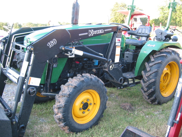

PS, my 01 Agricat 35 h.p 4x4 was a AWSOME very crude but AWSOME little work horse, well worth every dime I paid

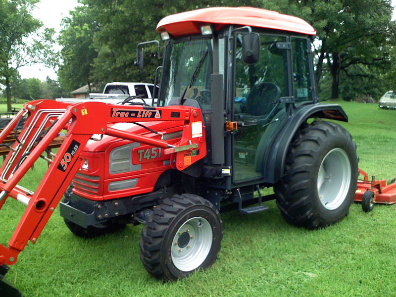

Here you Go, my Agricat, and my new 451

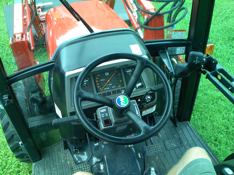

I want to also explain the fit, if you notice on the tym, the sterring colum contains thh throttle and the Shuttle and the PTO, and this Whole column, is tiltable. This brings 90% of the controls you need into your lap, you tilt the column via a foot switch, so if you operate a tractor long days like me, you stay put up right in the seat and the controls are at your finger tips, you do not have to lean way over to switch, this was a major problem with the montana tractor. I can say one thing TYM is trying to obtain a great fit. the left Sub shifter is too cloose to your leg, but at least they thought ahead and the close position is HIGH. I never thought I would say it but I LOVE the automatic PTO, what a great invention, now I hope it does not break, but with a 5 year warranty, I guess I do not worry. Also the Humpeloc has Skid Steer quick attach, that is a great bonus, and the loader no kidding goes on in off in less than 2 minuest it is very easy.
Negative, the tractor is VERY front heavy, no weight in rear as most new tractors. I wonder if TYM makes wheel weights. I dont like fluid filled tires.

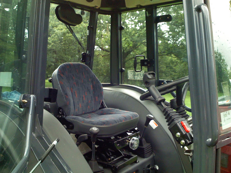

One more complaint, or wish I had, if the tractor had arm rest, I think I would sleep in it. TYM heard the comliants, "you need a cloth seat in a cabbed tractor, the 07 has a cloth seat". Now armrest. Oh the power steering is NOISY, it has a independent pump which is GREAT, but the orbital valve is noisey as can be. Oh and the Hydraulic seat is one of the BEST I HAVE EVER SET IN AND THAT RIVALS THE $1000.00 SEATS IN OUR BIG MASSEY'S... NO KIDDDING, IT CAN ACTUALLY SUPPORT A 200LB MAN AND NOT BOTTOM.

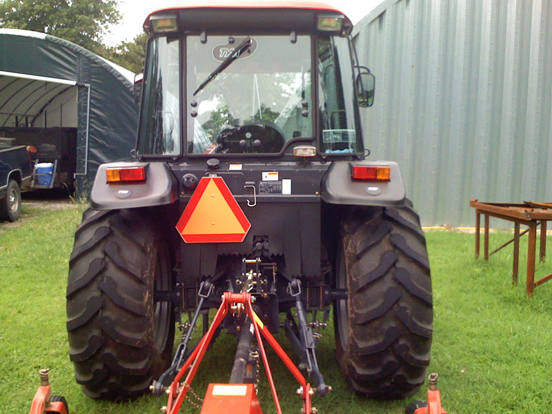

One more complain the rear lift does not go low enough, the finish mower you see on that tractor is a Buhler 72, and the front wheels are off the groun 80% of the time and that is as low as it will go. I do not like that. Also cab view rivals HIgh end John Deere and Massey cabs, with curved rear windows and concaved front. Massey makes a cheaper line of tractors with flat glass. This is a PLUS.

Nice looking tractor. Cab looks slick. Something I noticed that I didn't like is that the loader looks very petite. The FEL arms look very thin & light. Maybe they're thicker walled steel to make up for it.

I think the Loader is SUPER HUGE, it is a Humpeloc they are made in the Czech repulic and they are used on the Zetor, it is MUCH heavier than my Koaker loaders, and would compare in build quality to my MF and Bush Hog loader, The loader is VERY VERY heavy at least 1/4, I will post some better pics, it should be the loader was **** near 5 grand. It is not a Korean or Chineese loader,.

I wish the seat swiveled. Oh and the rear lift does not go down far enough, I am going to put a turnbuckle on both sides so I can lower it some more.
