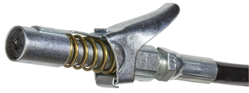

Now you need to put a LockNLube coupler on that long hose: http://www.tractorbynet.com/forums/oil-fuel-lubricants/304889-locknlube-cupler-grease-gun.html
I put a hose on my lever gun, works great, lock the coupler on, then use both hands on the grease gun. :thumbsup:
/ LONGER GREASE GUN HOSE #9
I just got one of those for my expensive DeWalt grease gun referred to here. It really is the ticket. Pricey for what it is but well worth if for what it does.

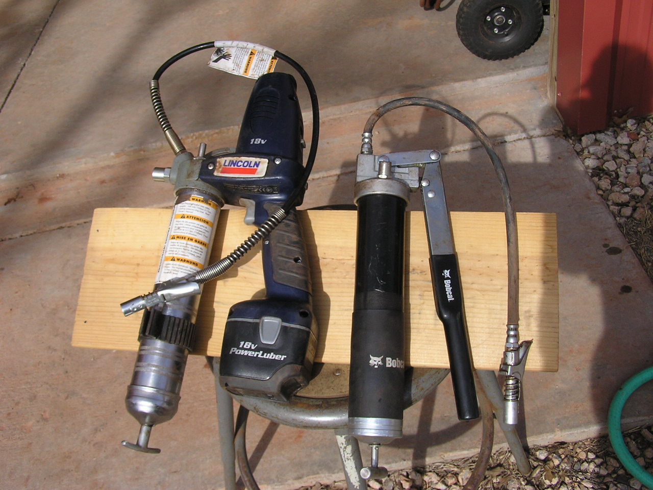

You don't need separate gun, just buy a 1/8 inch NPT zerk and screw it into the old coupler that you are using now. Lock onto it with the LockNLube and hold it into those places.
I made an extender from the pipe that I removed from the lever gun:

The lock on coupler looks great and generally gets high reviews, but on the Ventrac the hand space to get a coupler onto the zerk for the front drive shaft universal is so very limited that I am not sure I could operate the thumb lever.
There is one on my contour mower deck that barely clears for coupling with the smallest diameter zerk coupler I could find and even at that it is tilted. Sometimes smaller is better.
