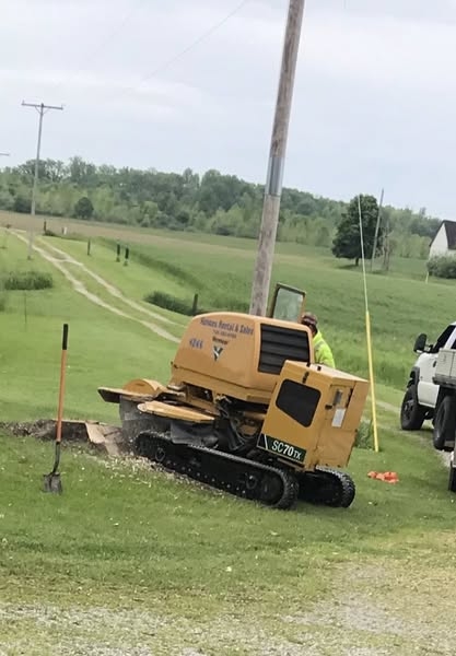

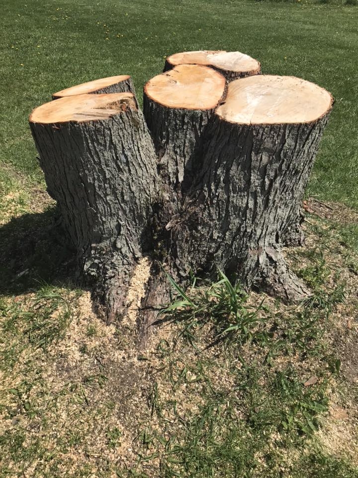

I use a stump grinder myself, No putting a chain in the dirt, what a carbide toothed stunp grinder is for.
You aint stump grinding all of this off. :ROFLMAO: 🤦‍♂️
Hazard tree was no way to drop as one. But you wouldn't understand that.
Thats why it was stumped by me so I could have my guy bring his grinder in.
Once stumped then grinder work. 🤦‍♂️ :ROFLMAO:

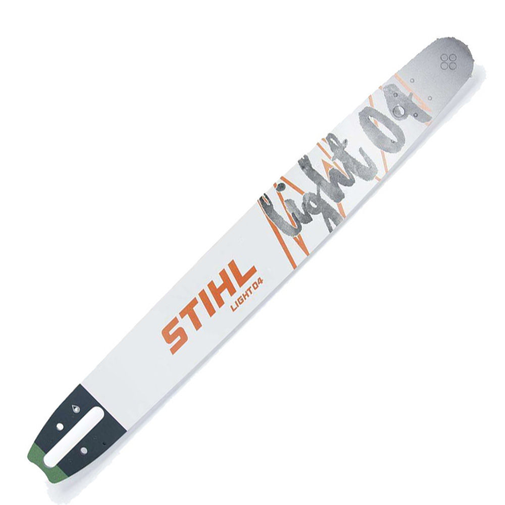

The new Stihl lightweight bars are supposed to be pretty good, good enough that I might ignore the lack of a greasible nose and the silly foo-foo design that looks like it belongs in my mother's kitchen, ca.1995.
I have a Stihl 25” lightweight bar and there’s no such nonsense on it.

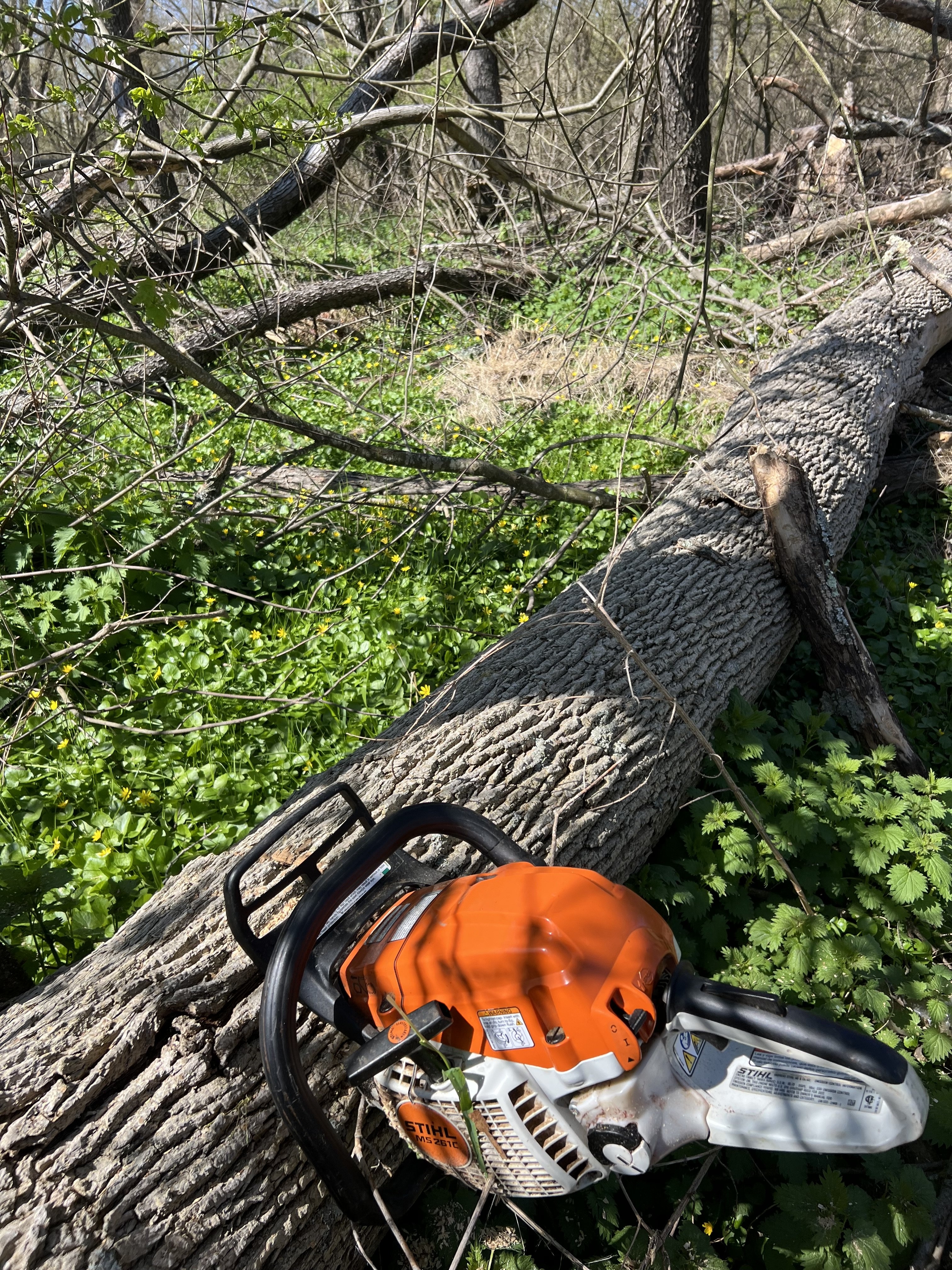

I haven’t found that to be the case, but to each his own. I definitely wouldn’t want to run a 261C in hardwood all day, but haven't had much trouble running mine through 18” to 20” hardwoods like this ash. Cut this stuff like a champ.
Yeah, yours is a lot better. The bar about which 5030 was writing, and to which I was responding, is these goofy things:
I can only assume Martha Stewart was somehow involved. :p
Two things:
1. Yes, it'll do fine. But like you said, a 20" bar buried beyond the nose on a modern high-speed 50cc saw is not something I'd want to run all day.
2. I was really referring ot the case of cutting larger diameters, when I said "nose buried". The horsepower required to keep chain speed up really spikes as soon as the diameter of the wood exceeds the length of the bar, as pulling that chain around the end of the bar while in a blind cut creates a whole heckuva lot more drag. So I believe you, cutting 18" hardwoods with a 20" bar on a 261 is probably fine. But cutting 30" hardwoods with the same bar is going to be much harder on that small motor.

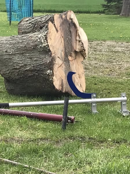

Back when men were MEN!
Actually I didn't know until I looked you can still buy a 2 man saw like that.View attachment 3558095
They are called misery whips and I can tell you from experience they are just that!! The art of sawing with them is to only pull from your side and never push.

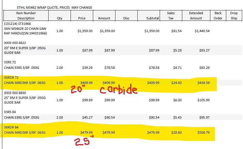

This is the quote I received for a Stihl MS462 wrap handle.
1 - 20" bar with 2 extra chains
1 - 25" bar with 2 extra chains
I went ahead and asked about Carbide chains.... well... THAT won't be happening.
1 - 20" - $409.99 + tax
1 - 25" - $479.99 + tax

Their chain and bar prices are about 30% higher than elsewhere. Heck, you can pick up Stihl 33RS-72 chains on Amazon for $30, and no one ever claimed Amazon is the cheapest source for anything.
No comment on the powerhead price, I haven't shopped new powerheads in years, but if their chain pricing is any indicator...
I'm willing to pay 10% more to support local business, but usually not 30% more.
