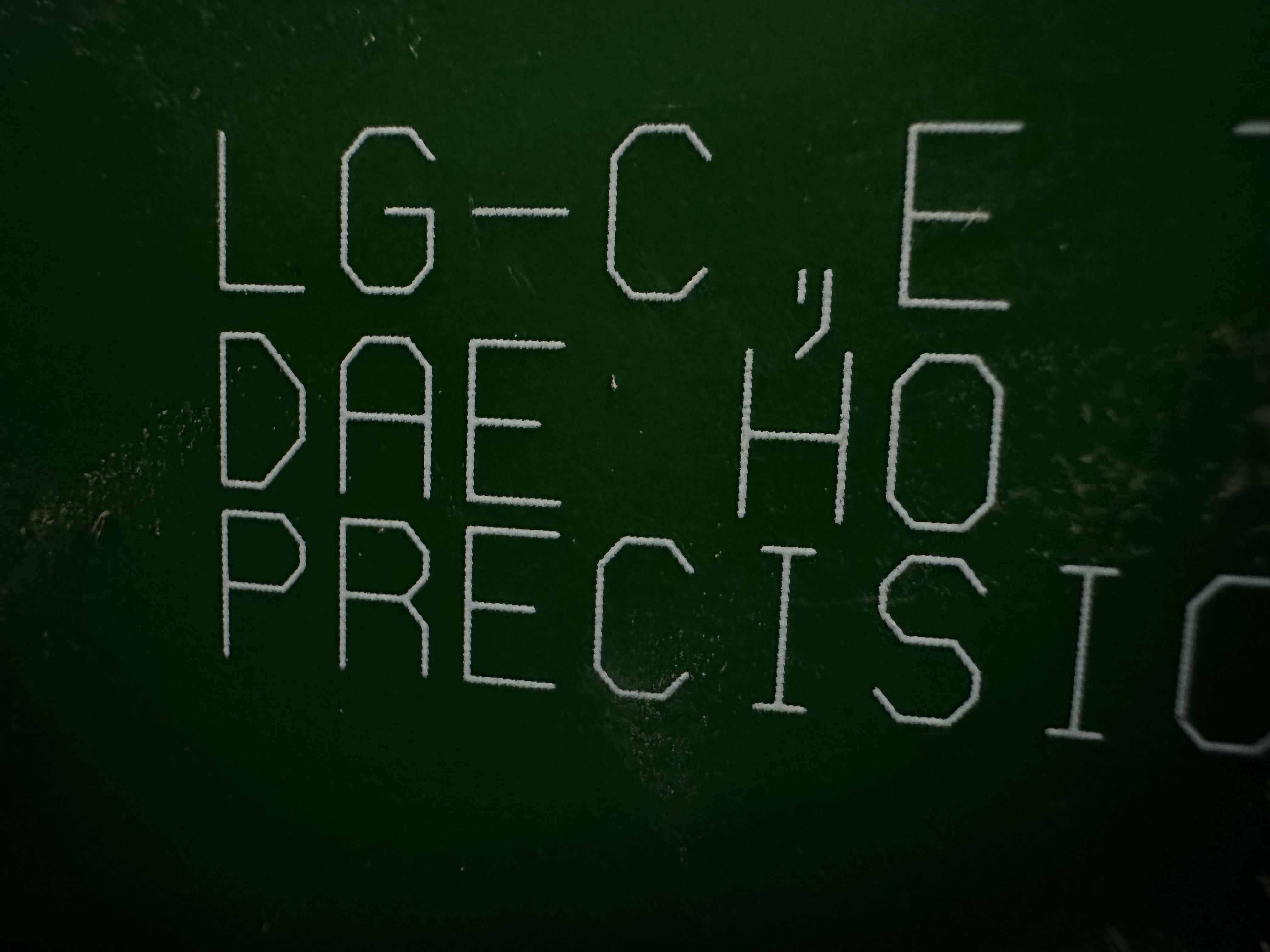

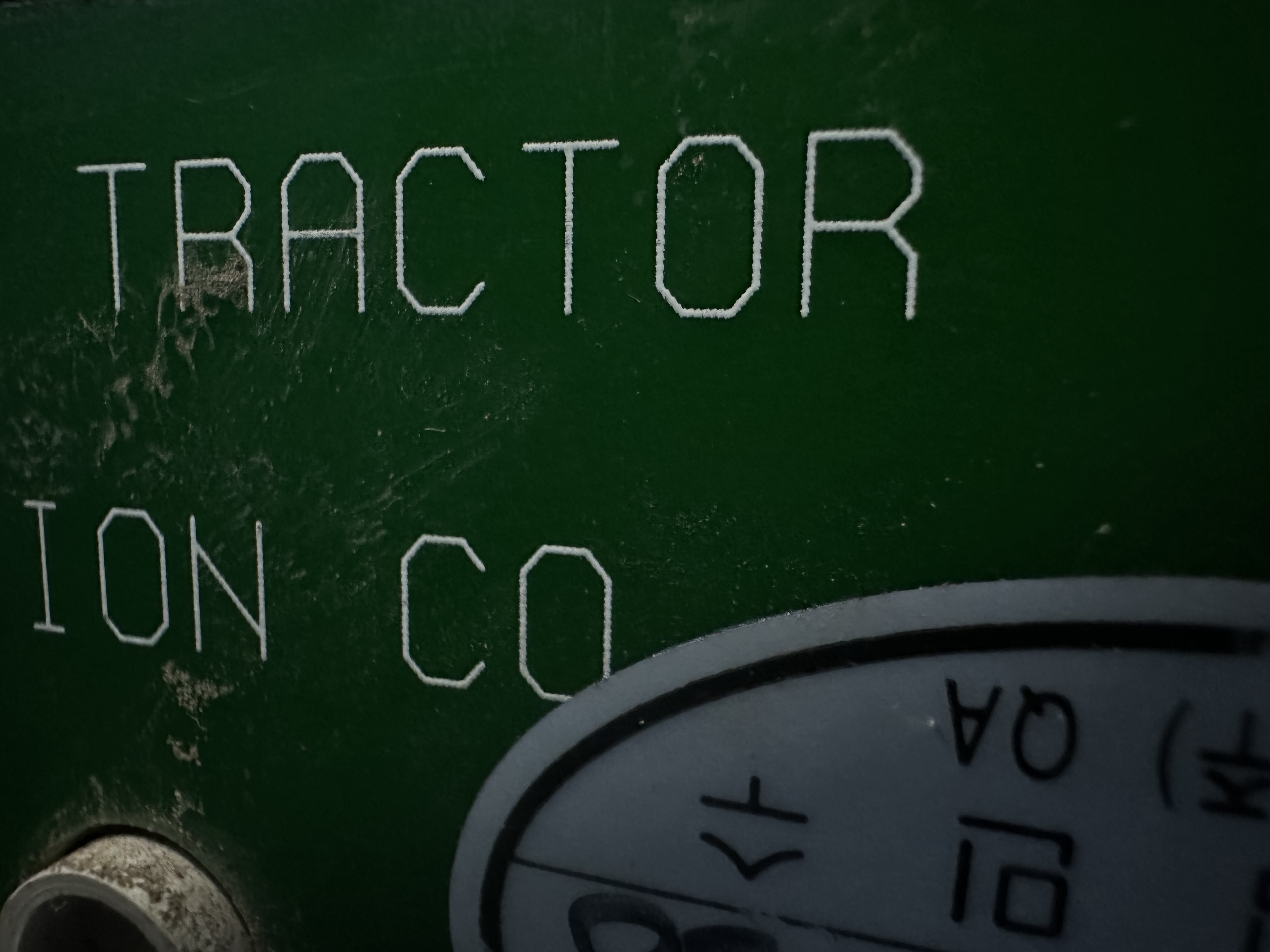

I bought a used 2001 long landtrac 530, I am trying to find manuals on it as well as determine the type of Mitsubishi 3.3 liter 4 cylinder diesel that is it, currently for the purpose of figuring out which freeze plug hole I would be able to install a block heater in. Also I am not sure the type of fluid for the hydraulic system. Any help would be greatly appreciated
Update since posting this for anyone searching down the line, I did atleast figure out the motor is a Mitsubishi S4S 064297

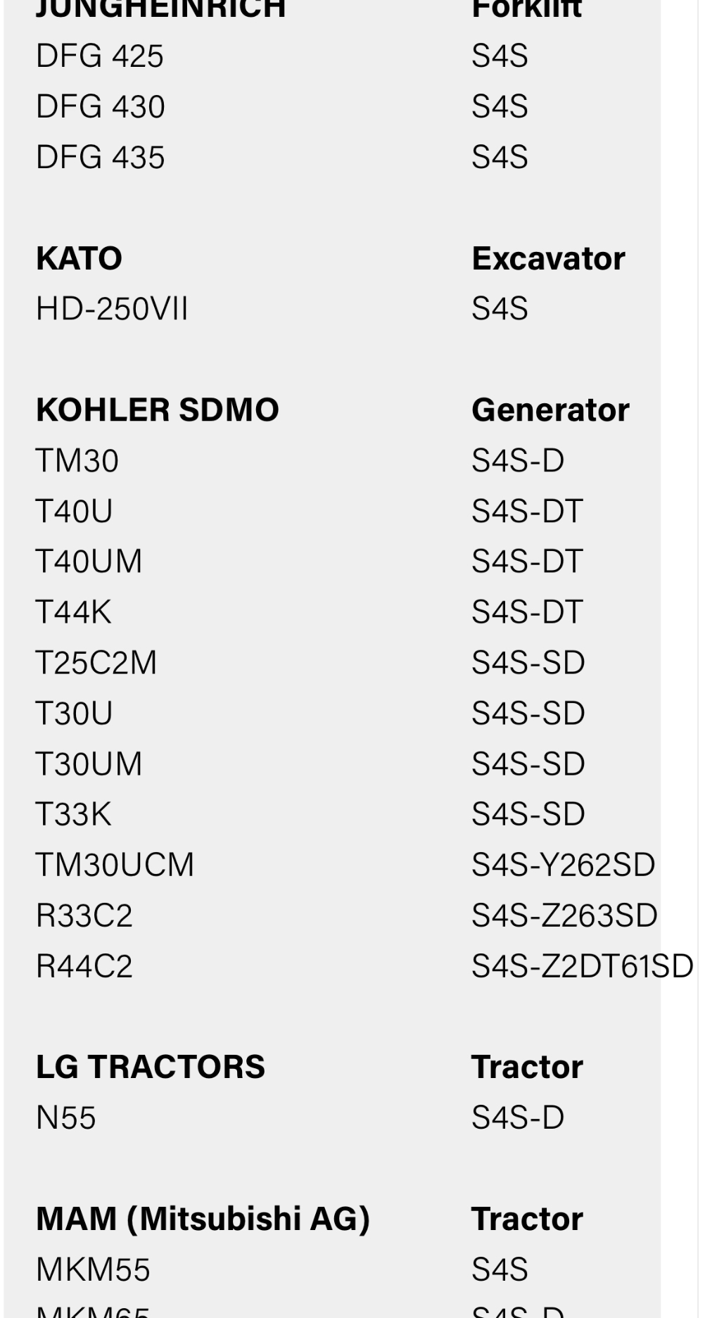

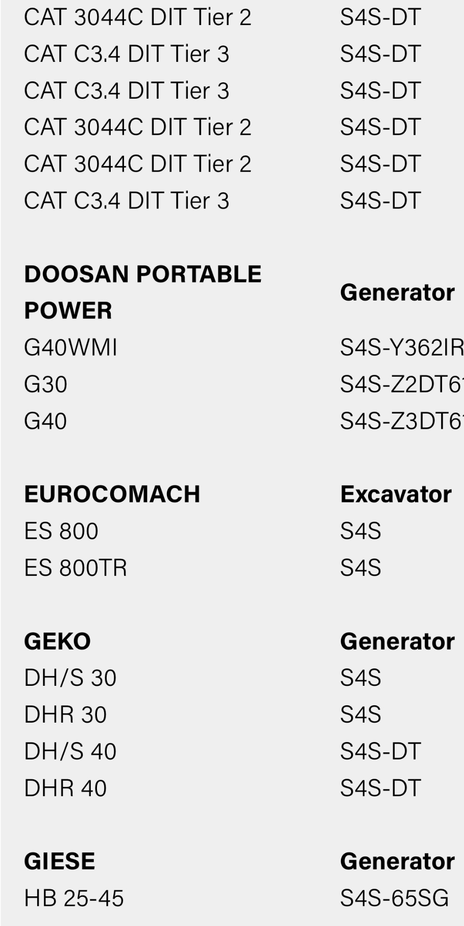

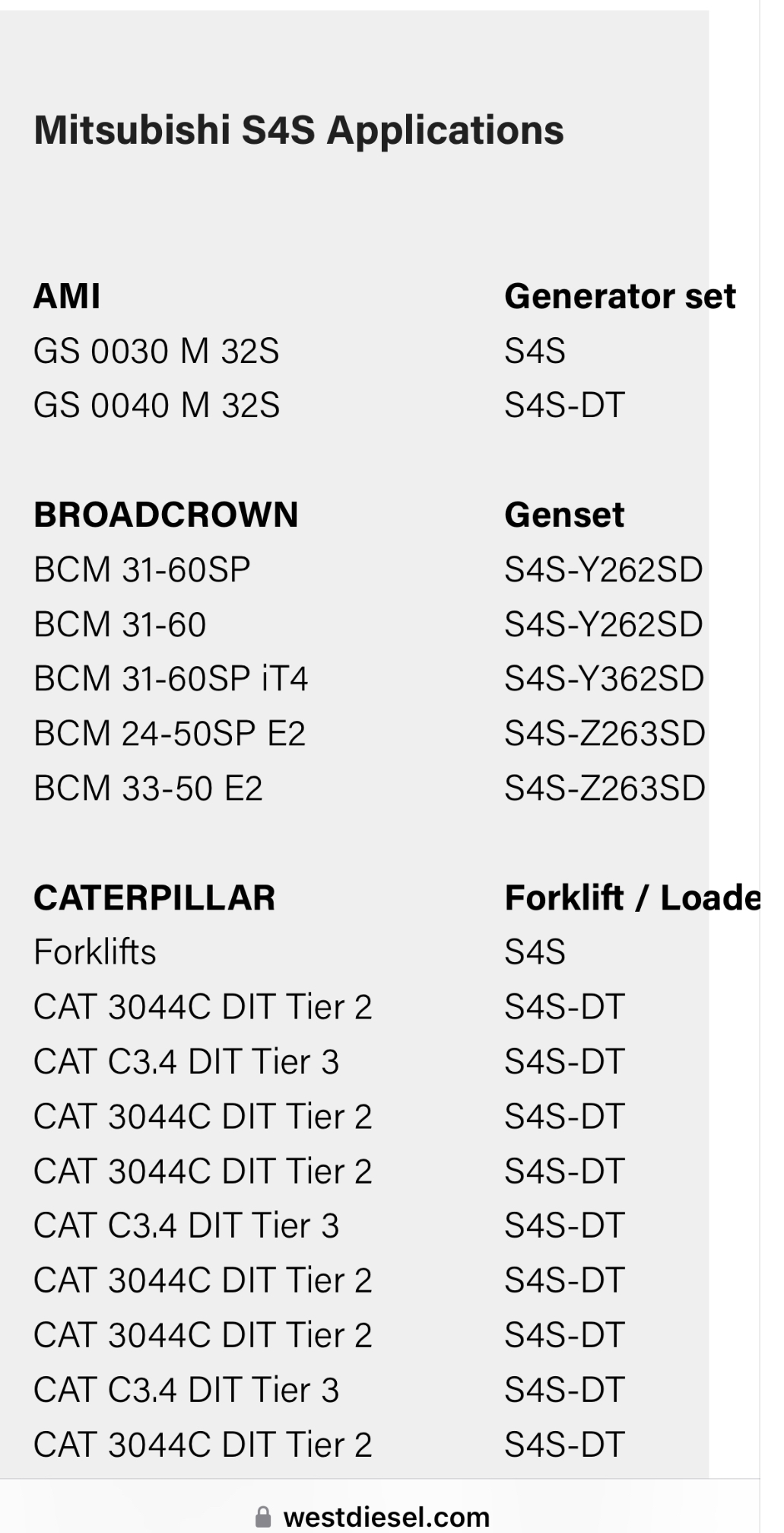

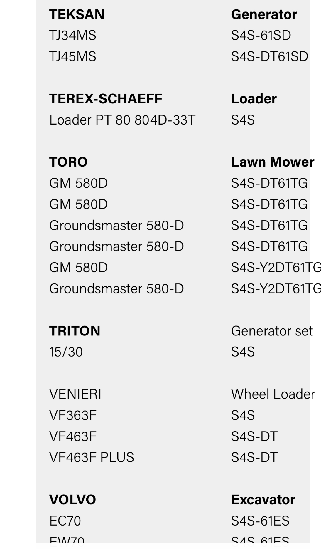

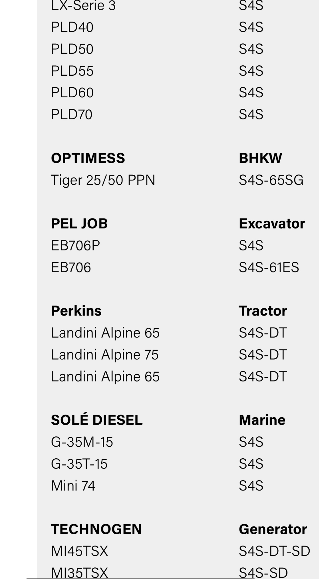

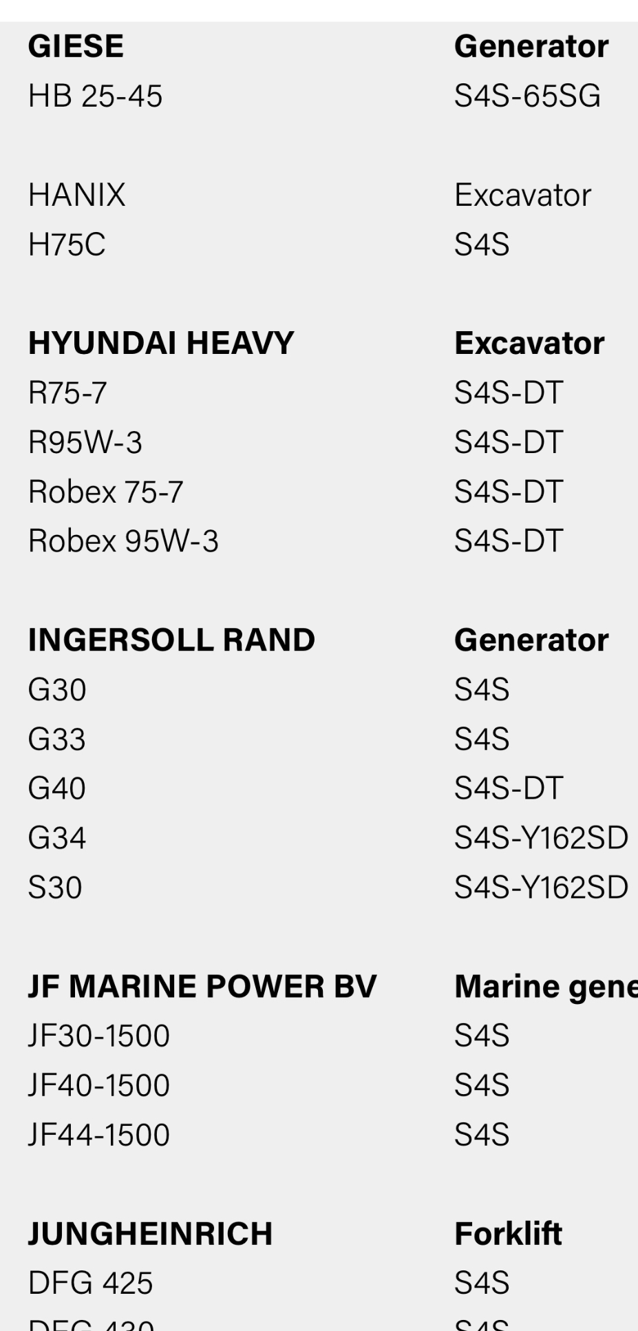

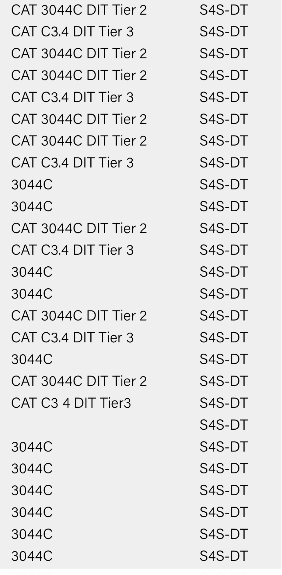

Update: here are photos of all the equipment which has the s4s motor in it for possible part numbers and such. I found it on westdiesel.com

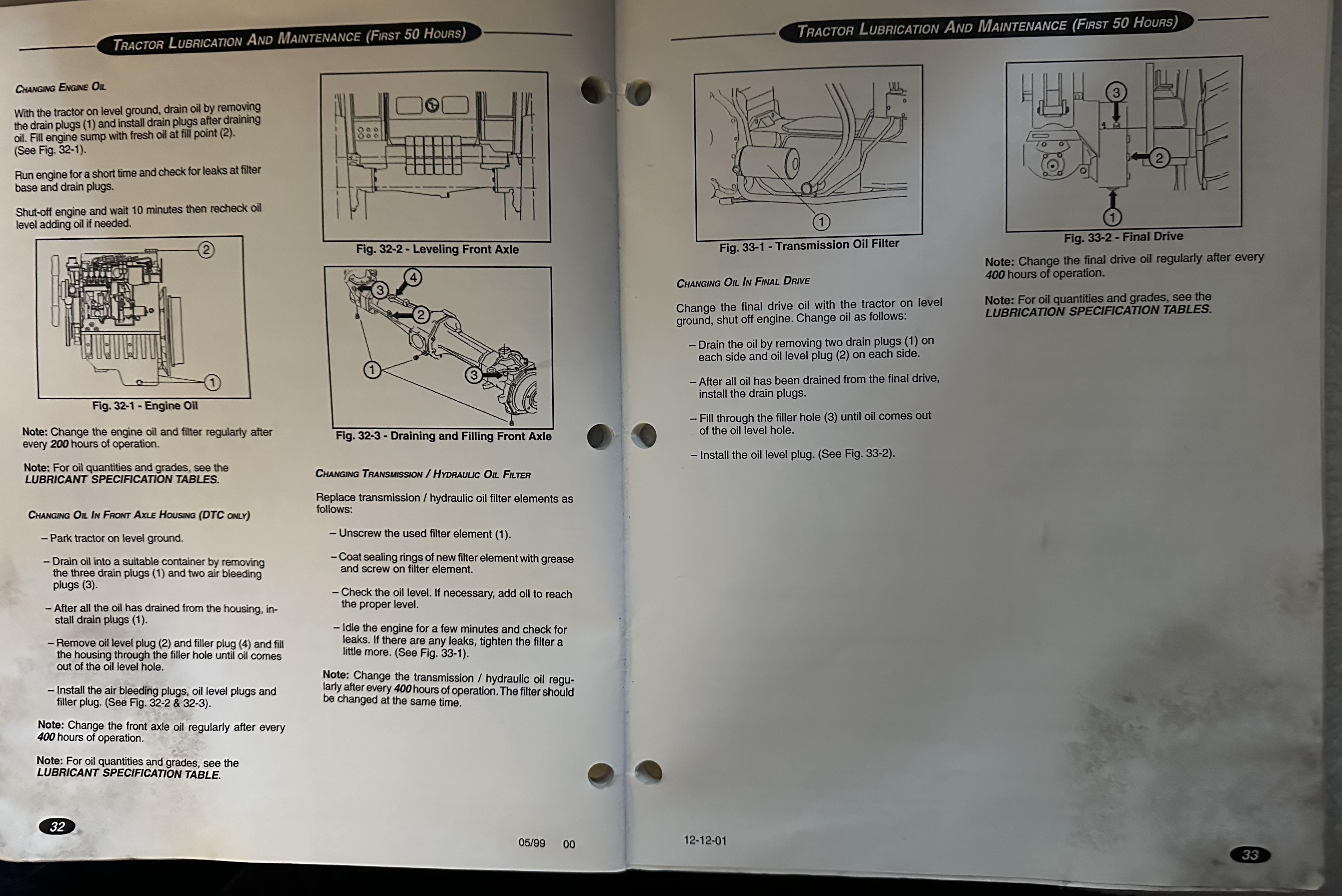

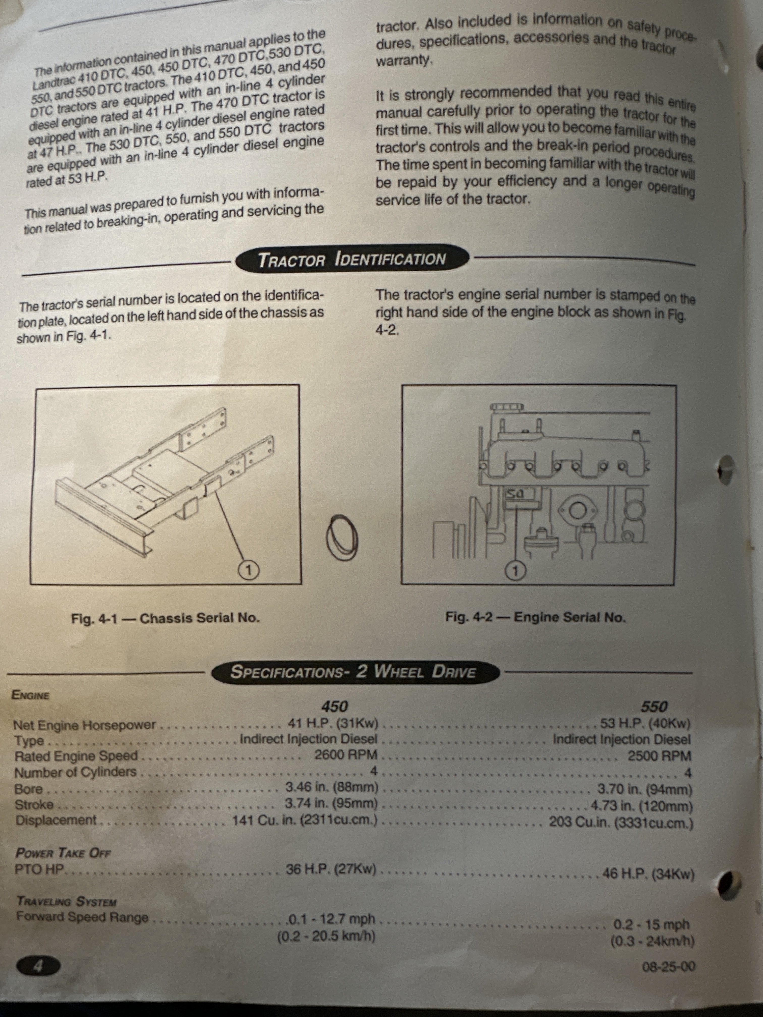

Update since the company went bankrupt and discontinued all manuals, Here are some of the very hard to find information for the landtrac 410 dtc/450dtc/470dtc/530dtc/550dtc

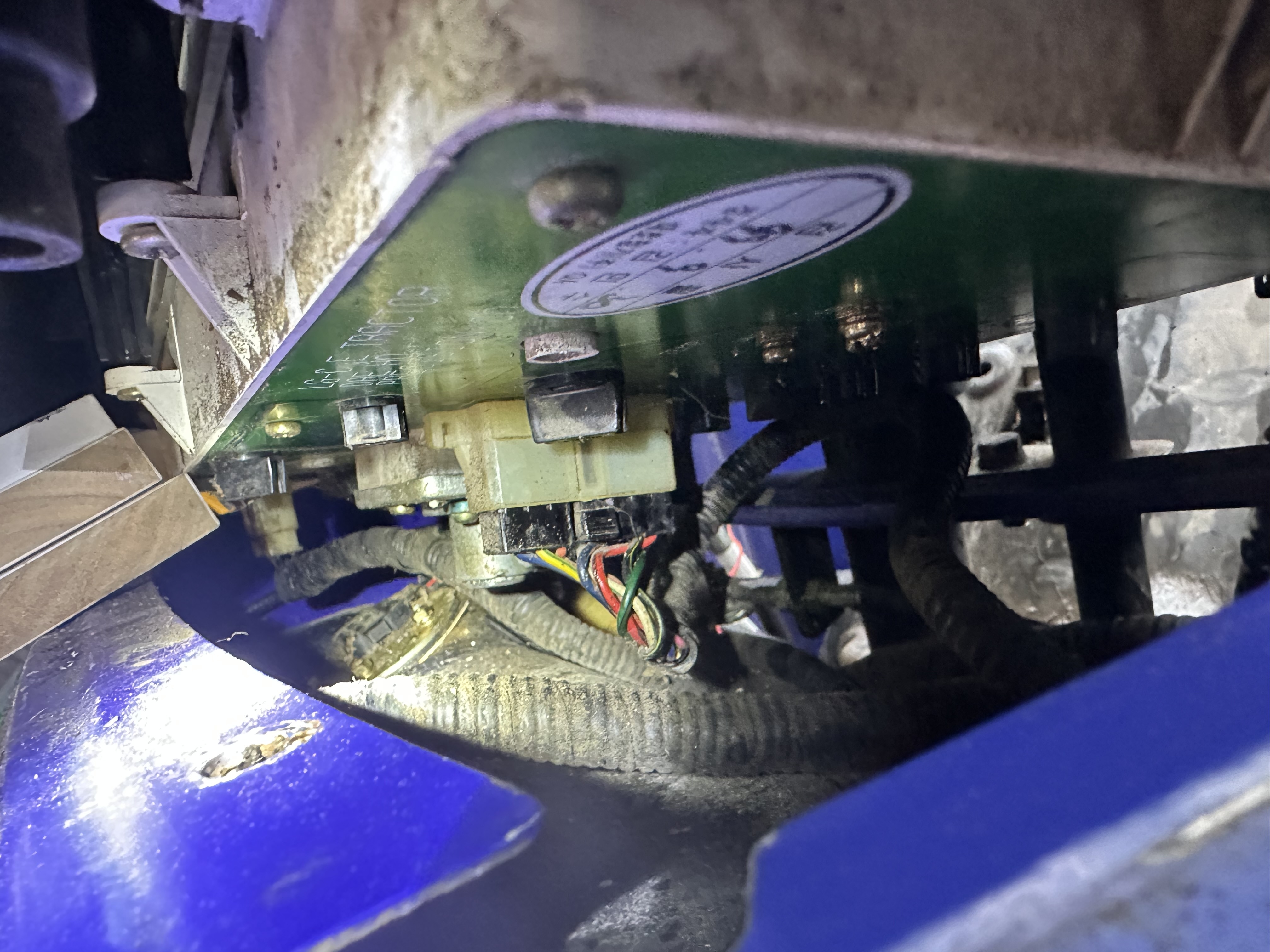

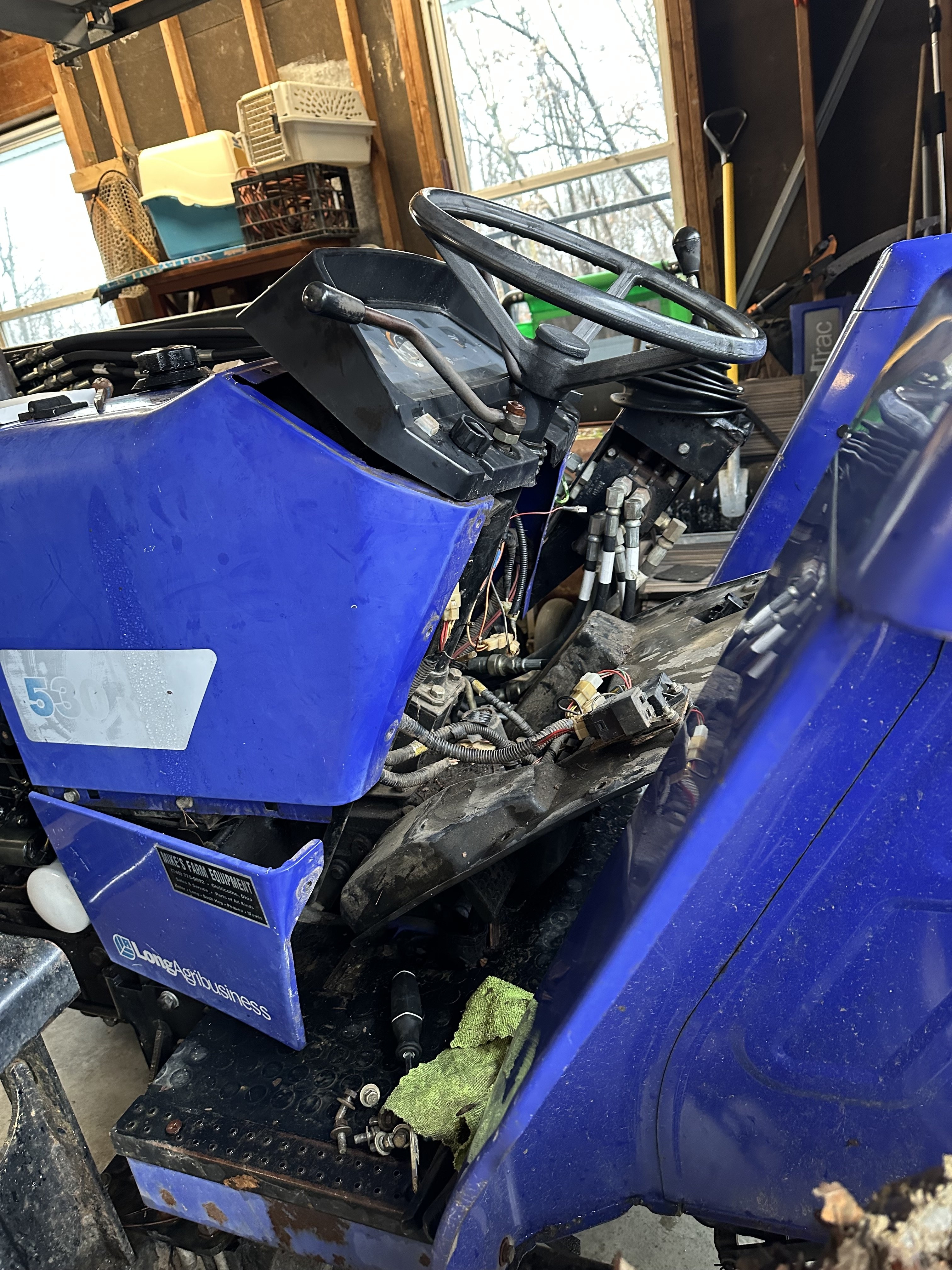

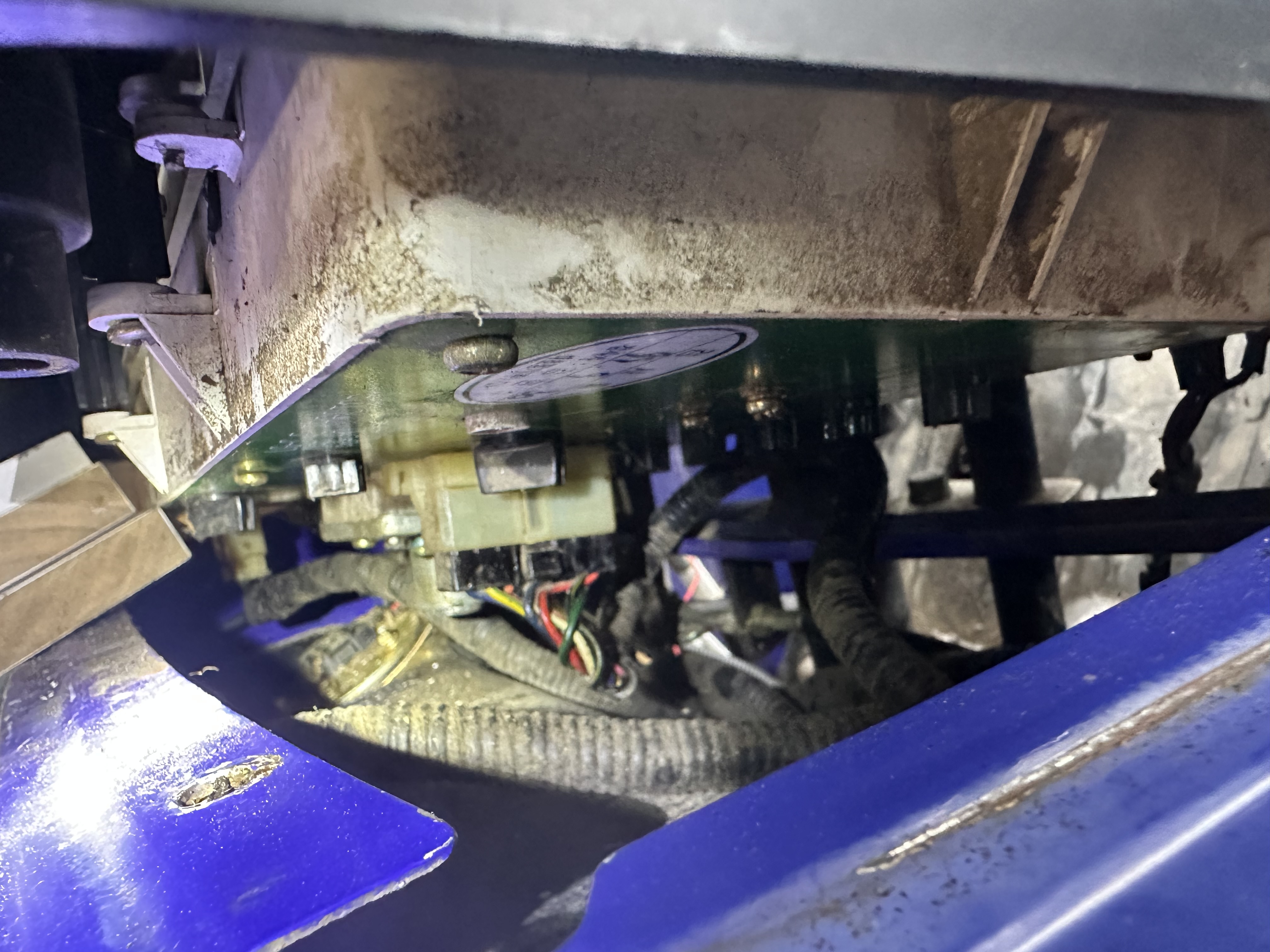

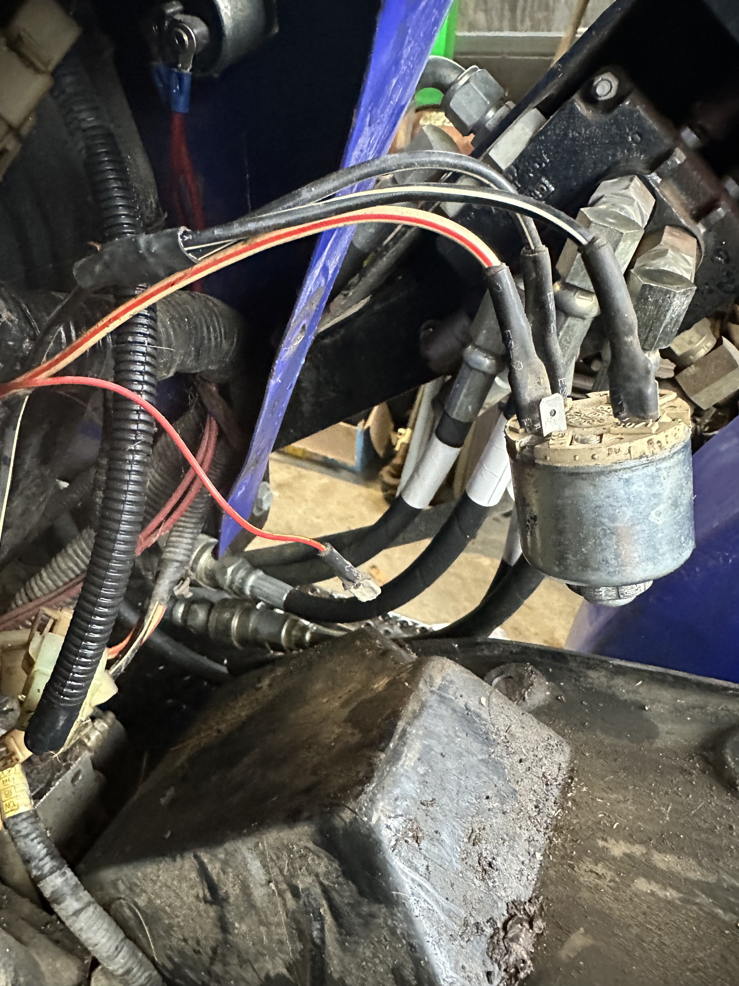

If you was wondering what a landtrac 530 wiring looks like around the steering column, here are a few pictures of mine(already had wires rerouted etc from the former owner) also there is a photo of under the instrument cluster.
