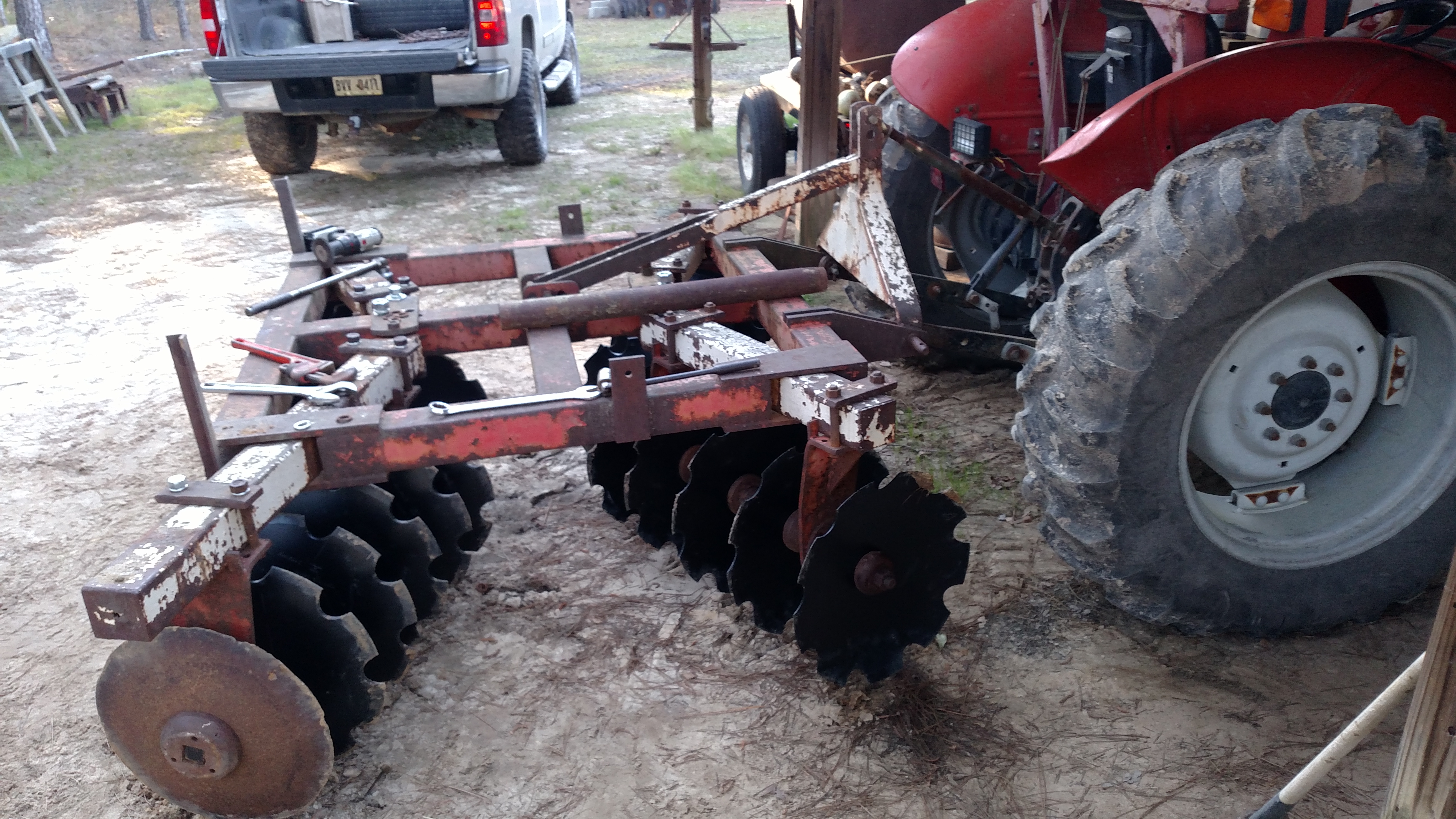

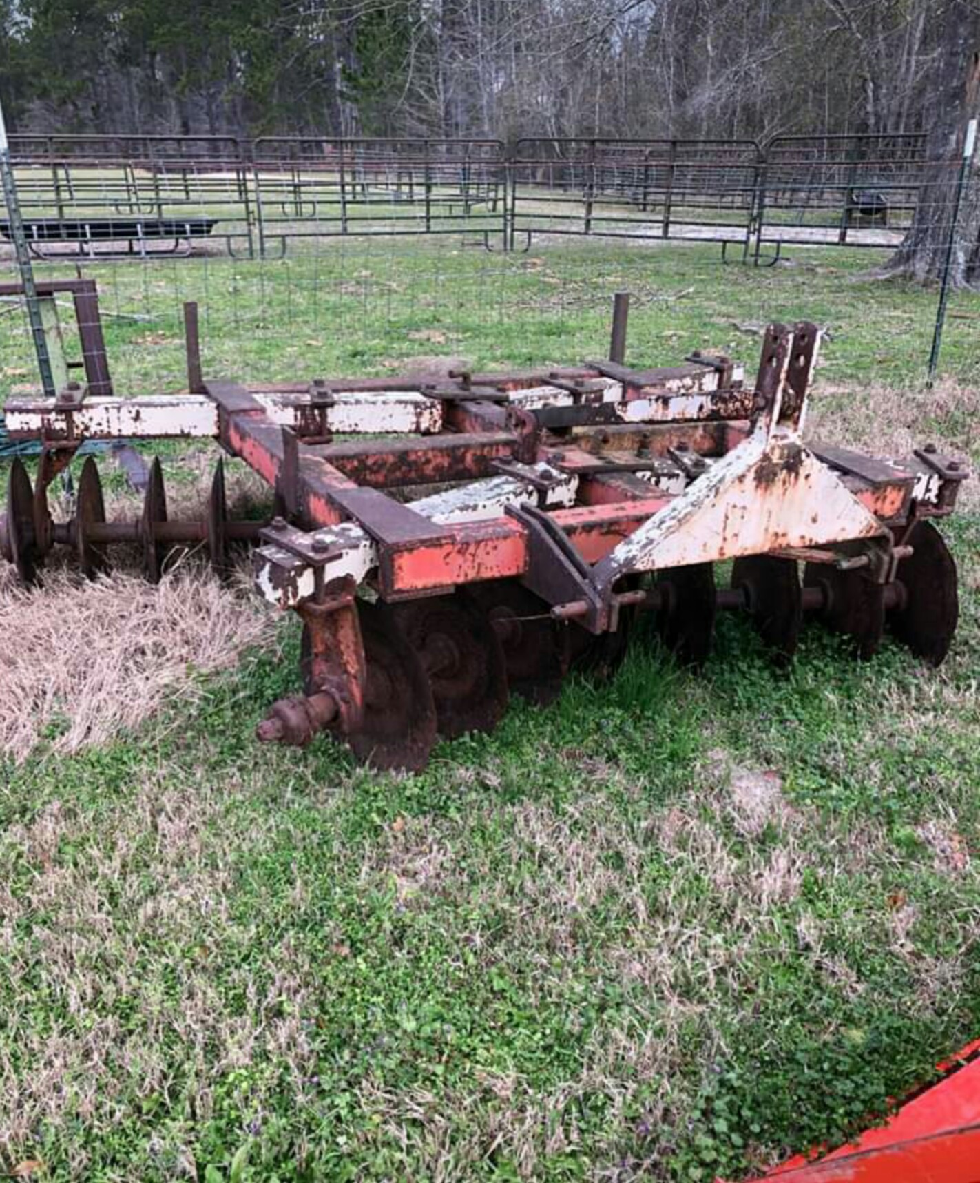

I recently acquired a set of Long 960 harrows ($650)
I've been working through them the frame (4x4) tubing
Hangers, 3pt hitch, some bearings and axles were all in good shape but my issue is the axles seem to be 41" front and back. The fronts are 5 disc on about 9" spacing and the rears are 6 disc on about 7" spacing is this common or just a product of coming off a farm visiting the parts pile? They were road hard and put up wet . And the half spools were a hogpile of assorted spools pieced together it seems..

The best I can tell the spools look like King Disks and may work for you. If you are near an Agri Supply take yours with you and you may find ones you need. The difference in spacing is used I think for the front ones to help cut any trash and then the rear ones can cut it smaller and also the front ones are hitting normally more solid dirt while the ones are in "disked" dirt allowing more weight on the front blades for penetration on the heavier trash and undisturbed dirt.
/ Long 960 Harrow #3
Several Monroe Tufline and Dirt Dog disc harrows are configured as yours.
Nine inch spacing on the front, cutting gang improves disc penetration in new ground due to less float.
Seven inch spacing on the rear, smoothing discs theoretically results in clods chopped finer as output.
I have a Monroe Tulfline with same front/rear disc spacing. I like it.

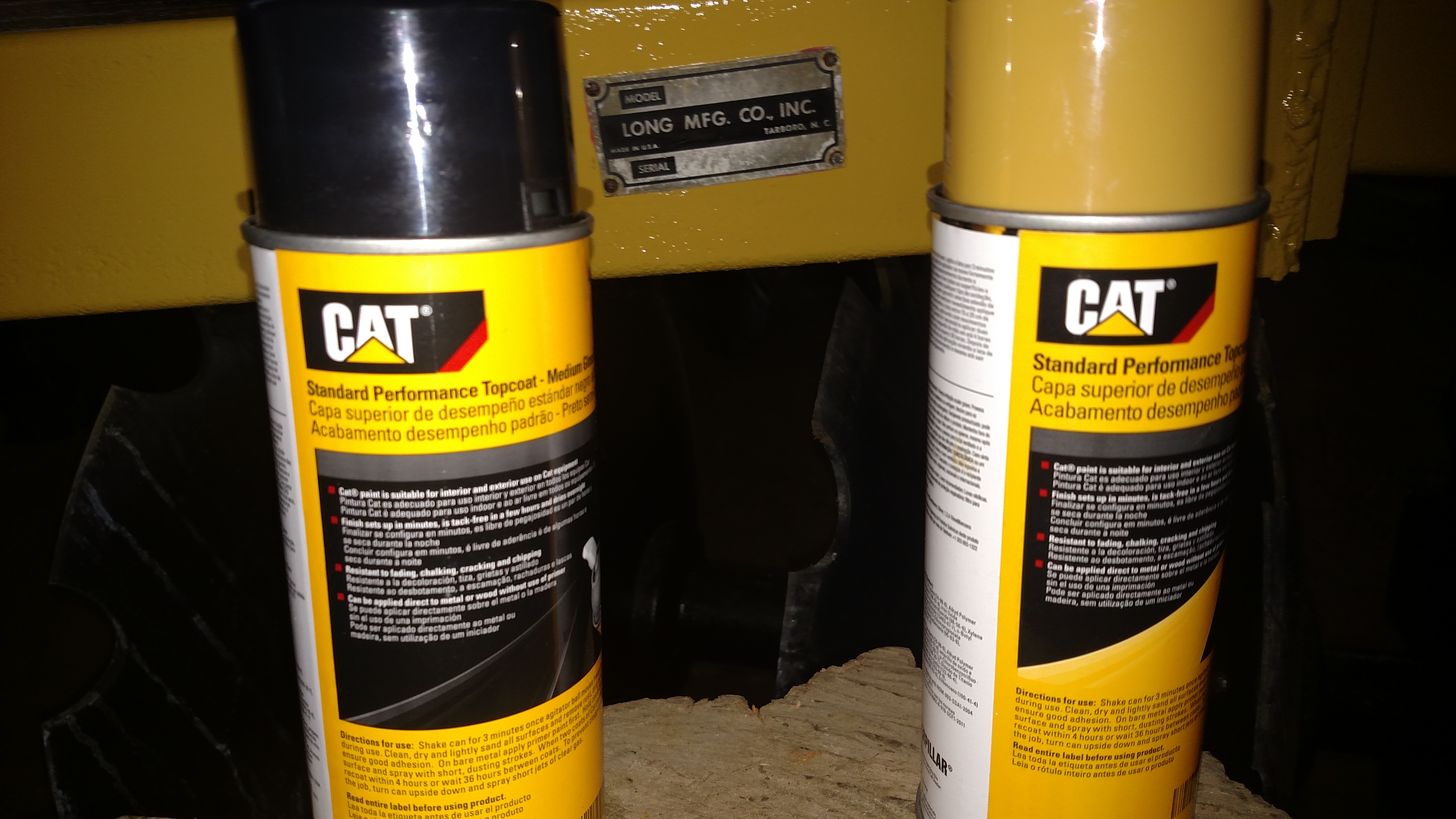

I'm thinking of starting some prep for paint soon...
I can get some Caterpillar yellow and black paint for basically free ... Paint the frame yellow, the 3pt hitch and hangers black? Sound like a good color combo?

I thought about taking a needle and dipping it in black paint and trying to outline the model no. And serial number (which is stamped) but they're almost non-readable anymore... Thoughts? Suggestions?
/ Long 960 Harrow #8
Forget about it and start using it.

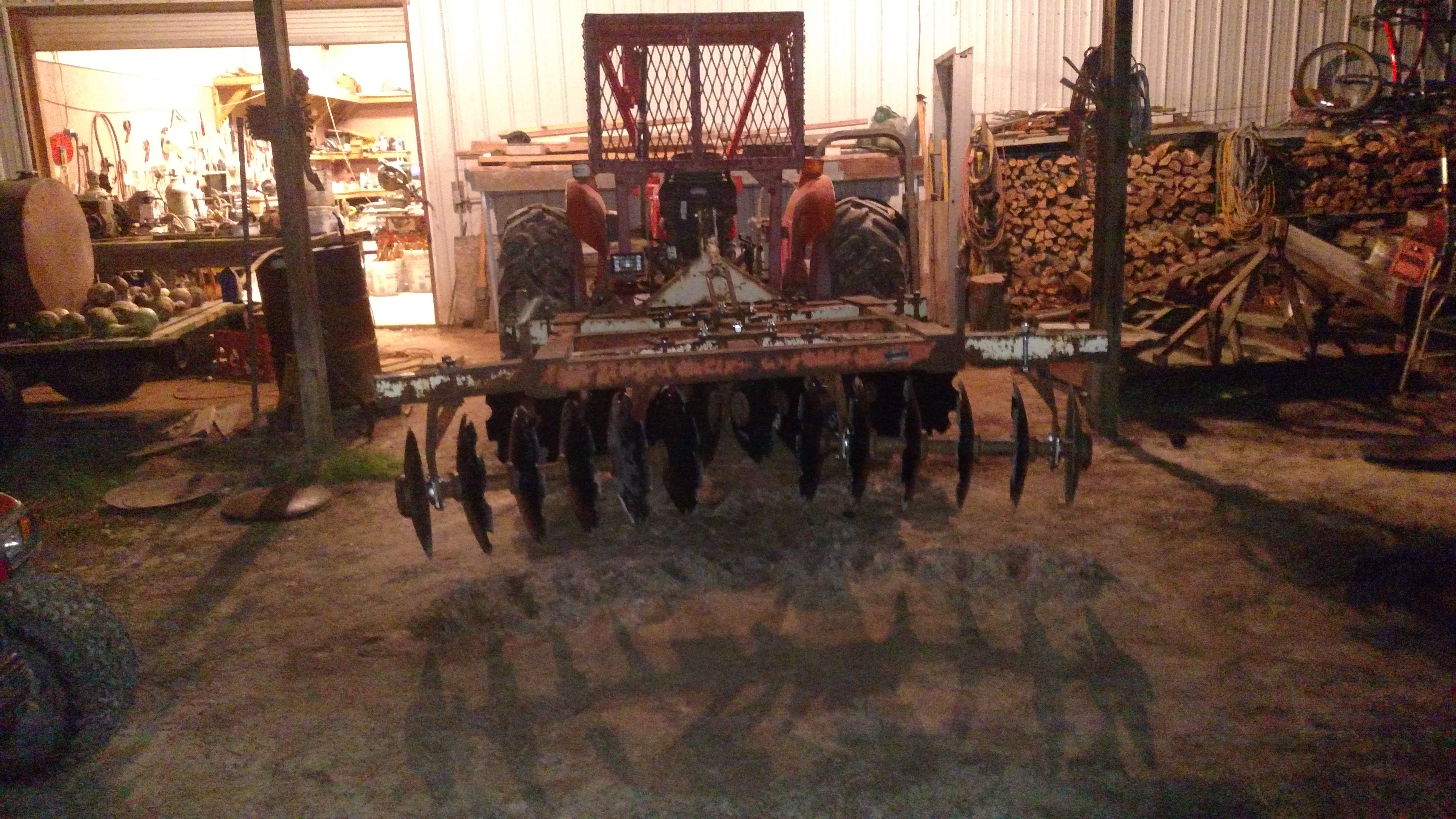

#11
Huge change from what I started with, I'm happy with them. Ran them through the dirt shortly after, cut very well.
