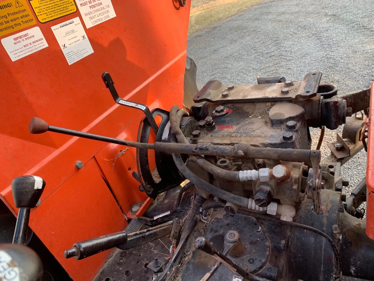

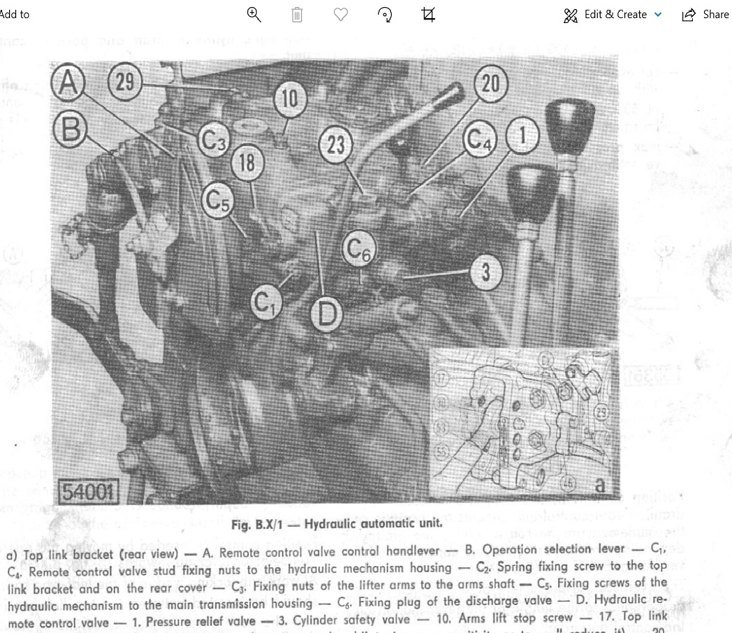

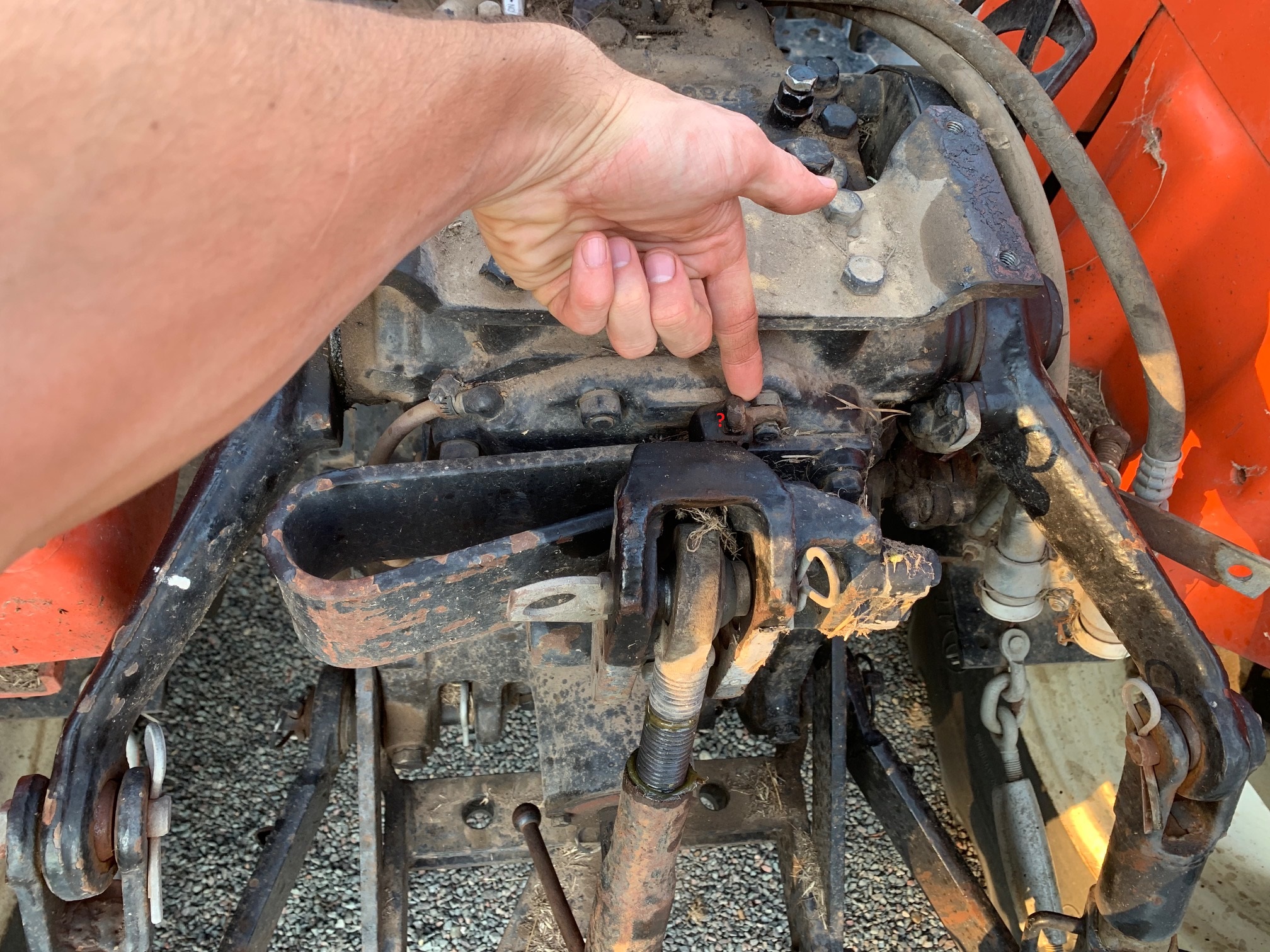

Hi guys,
I have a Farmliner/UTB 445 and having a similar issue, did this ever get resolved?
We bought a farm that came with this old tractor, front end loader and power steering work great. Came with a slasher fitted to the rear. We recently took it off so we could borrow a friends ripper or plow, but couldn't get the 3 point linkage to lift. I can lift it by hand but it slowly drops back down after I let it go, and I can push it down pretty easily.
Had a look in the manual and apparently there is 3 settings, was currently set to Float. I lifted the 3 point linkage by hand, raised the handlever to the top, and then while holding the linkage I moved the smaller handlever to the bottom position. Took a small amount of force to engage. It's stayed engaged but doesn't seem to work any differently. I suspect there is a stuffed valve somewhere, or the internal workings of the lever are out of whack.
I've attached a few photos, can anyone tell me what some of these other items with question marks do?
Thanks in advance :)

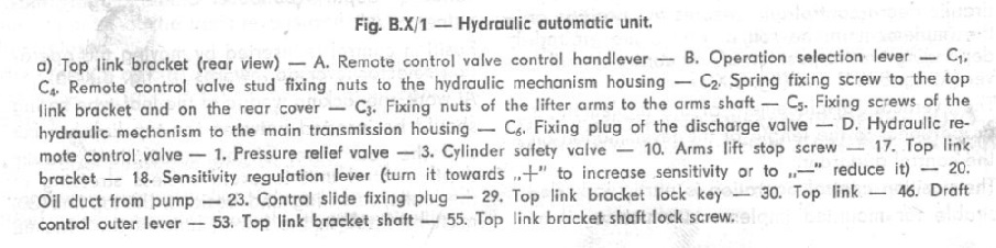

maybe this diagram helps.
its the sensitivity speed at which the hydraulics go up.

Awesome, cheers for the reply!
Ended up finding the right combination of levers to get the slasher to go up, only lifts a foot or so, but more than I need, and probably height limited by the length of the chains and other stuff down in that area.
