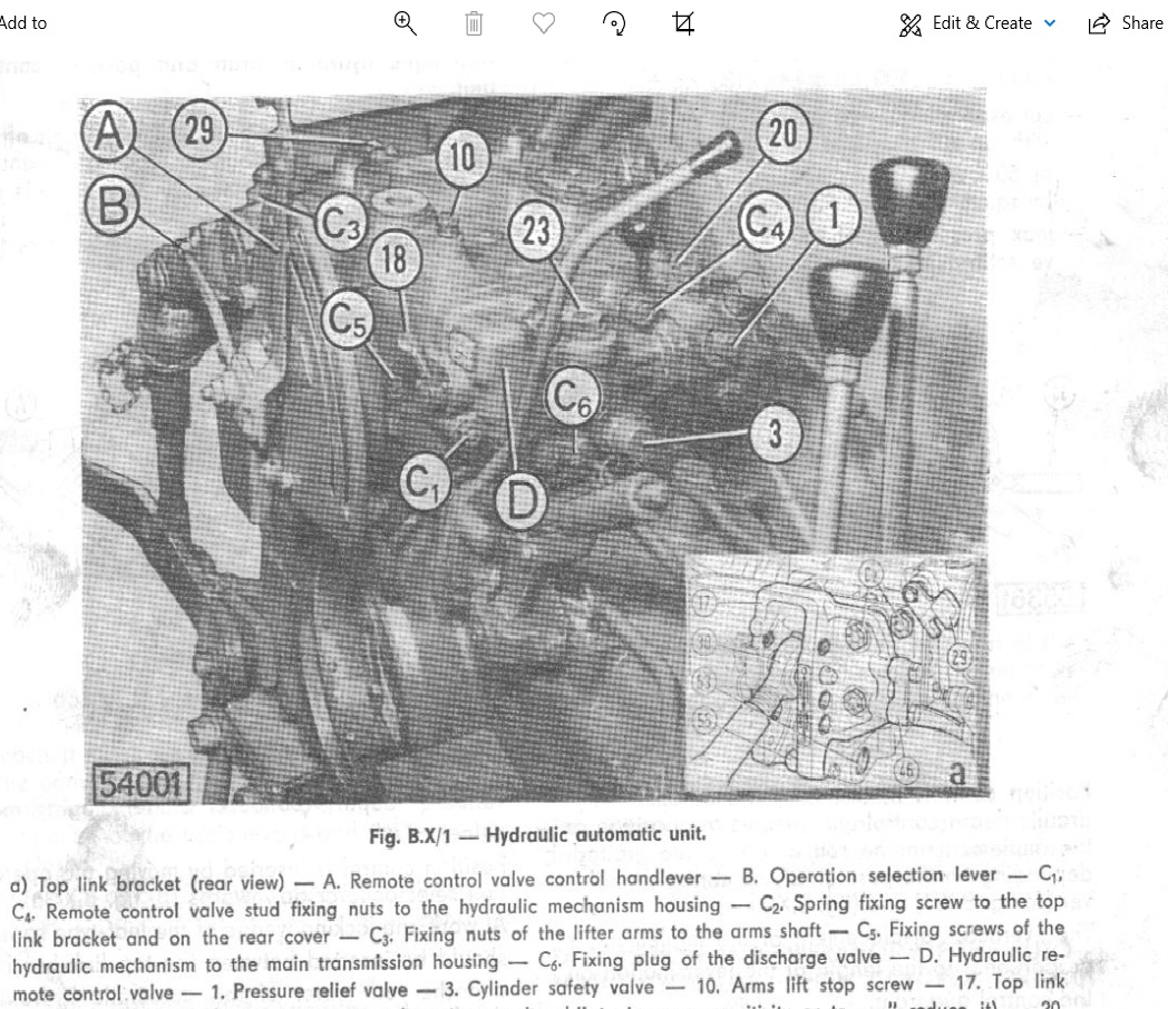

Hi guys,
I have a Farmliner/UTB 445 and having a similar issue, did this ever get resolved?
We bought a farm that came with this old tractor, front end loader and power steering work great. Came with a slasher fitted to the rear. We recently took it off so we could borrow a friends ripper or plow, but couldn't get the 3 point linkage to lift. I can lift it by hand but it slowly drops back down after I let it go, and I can push it down pretty easily.
Had a look in the manual and apparently there is 3 settings, was currently set to Float. I lifted the 3 point linkage by hand, raised the handlever to the top, and then while holding the linkage I moved the smaller handlever to the bottom position. Took a small amount of force to engage. It's stayed engaged but doesn't seem to work any differently. I suspect there is a stuffed valve somewhere, or the internal workings of the lever are out of whack.
I've attached a few photos, can anyone tell me what some of these other items with question marks do?
Thanks in advance :)
/ Long 445 3pt problem #25
maybe this diagram helps.
its the sensitivity speed at which the hydraulics go up.

/ Long 445 3pt problem #26
Awesome, cheers for the reply!
Ended up finding the right combination of levers to get the slasher to go up, only lifts a foot or so, but more than I need, and probably height limited by the length of the chains and other stuff down in that area.
