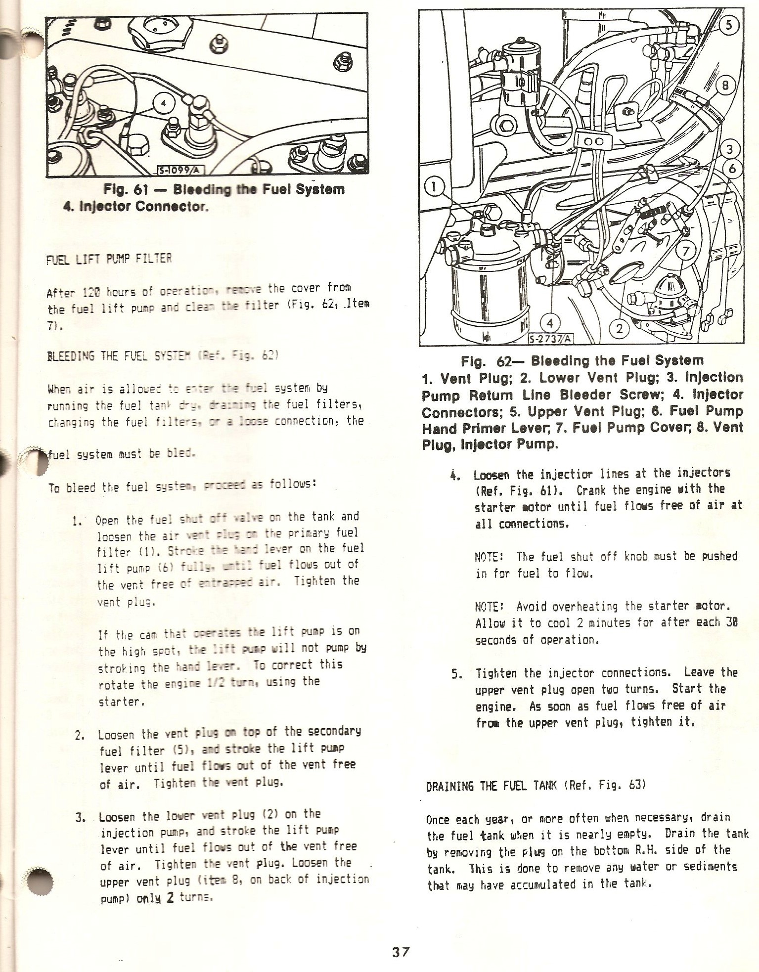

A friend has a 2360 and he is happy with it. It only has one set of hydraulics on it and coming off that he has a loader on it. if you have not already, do a title search on this site using 2360 some members have provided me with info on it, before I serviced it for him this year. Do you have an operators manual, if not I suggest you get one, I have seen them on the web. I have attached the page on how to bleed. In step 5 it says to leave the upper vent plug open. While I may have done something wrong, I could not get it to start until I closed the plug.

Thanks I have the manual, my folks still had that. I have pretty much read it cover to cover already several times. Like I already said this tractor has sat for at least 2 yrs it has 810 hrs on it my folks used it for bushhogging mainly on their 40 acers until they got too sick to work the land. We had someone using it for hay until this fall when they decided to not renew the contract without telling me, but enough about that. I just want to get the tractor running and keep the farm land up so I don't get in trouble with the county or my neighbors.
