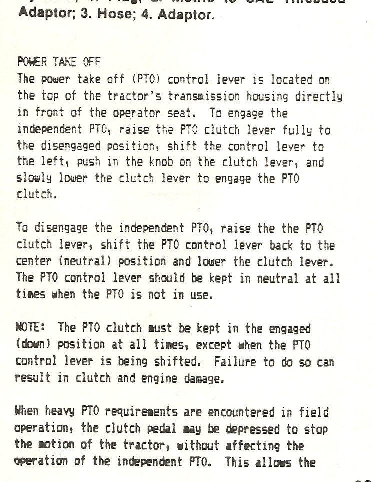

A friend of mine owns a Long 2360, the PTO lever located in front of and to the left of the driver seat no longer turns the PTO off. The lever moves freely up and down. Before I start to do anything, I thought I would ask and see if anyone has any suggestions as what could be the problem.
Thanks in advance for any help.

About all you can do from the outside is follow the linkage and determine if the cross shaft through the bell housing is actually rotating when the lever is moved up and down. If so, the problem is internal. Release bearing, clutch levers, maybe the setbolt anchoring the fork to the cross shaft backed out. Don't know if Long put an inspection plate under the bell housing, but you might check for one. You may have to split it to find the problem.

I remember that lever but that has been 20 years ago.. Also there is another lever at the floor level, that goes left and right, I can remember if it had a neutral position or not but its function was to switch between synchronous ( with the wheel rotation) PTO and independent PTO. check that little lever to make sure it is engaged properly. That's all I can remember, sorry not much to go on.

Went and looked at my friends Long 2360 yesterday. I brought home the manual and I think his problem is one of not looking closely at the manual. I have attached info from the manual.
