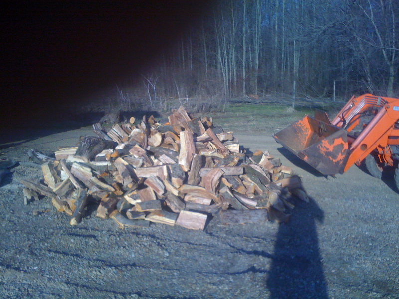

The apple wood:
This is the pile I wound up with after we finished this afternoon except for about 4 bucket loads that we stuck behind the house to burn. It really needs to season :rolleyes::

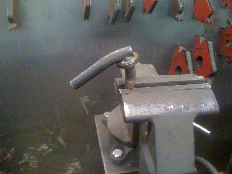

Spent most of last night working on finishing things up and fixing things on the splitter.
What happens to a log lift hinge pin when it gets in the way of the push block :D:
Dang thing rotated handle up ... and the block caught it.
Heated it up with the torch and straightened it out ... after I did the same for the log lift brackets. Drilled the pins as well, for some hitch pin clips.

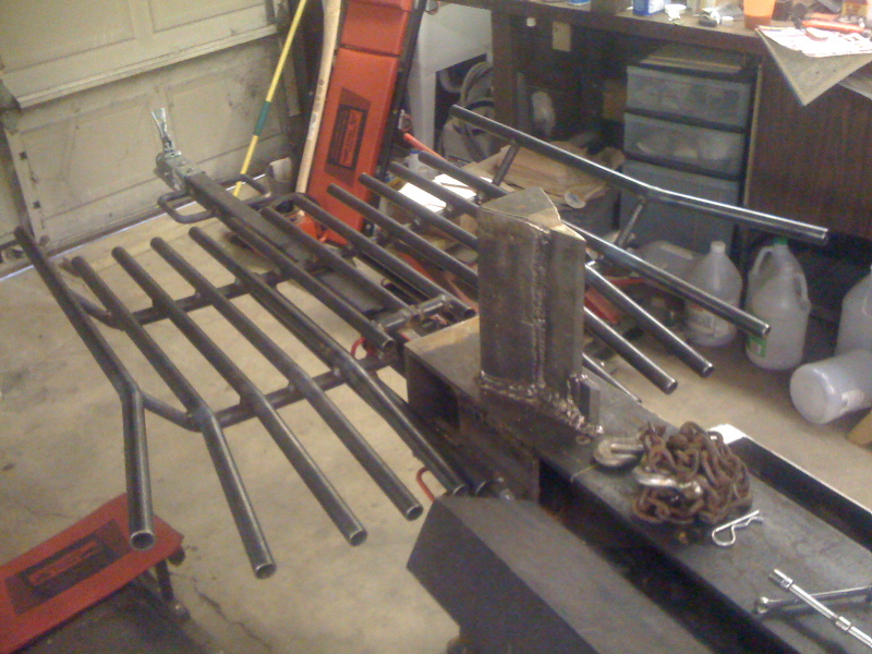

Heated up the pipes on the table grate and bent them into position.

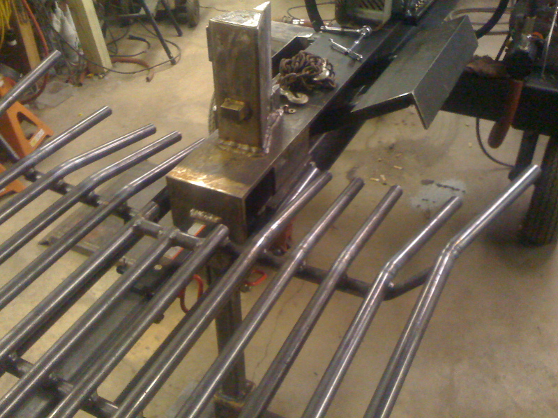

Table grate with pipes bent. Also did a little mod awhile back to the center tube so that it would clear the wedge when folded up into the upright position:

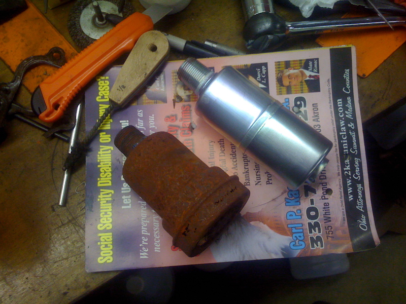

Managed to get the old muffler off yesterday by heating the crap out of the pipe elbow that it screws into. Here's the old muffler and the new replacement:
Made sure to use anti-seize when I installed it.
The new one sticks out a little beyond the stock heat shield ... I had to replace the sheet metal on the front section of the heat shield because it was rotting out. Took a win on that because I was able to weld it successfully without blowing holes in it (it's about 18 gauge sheet) Still have a couple of small tabs to weld on, so the heat shield can be screwed onto the muffler as an anchor point.
No noticeable difference in the noise level with the new muffler ... but I was in an enclosed area.
