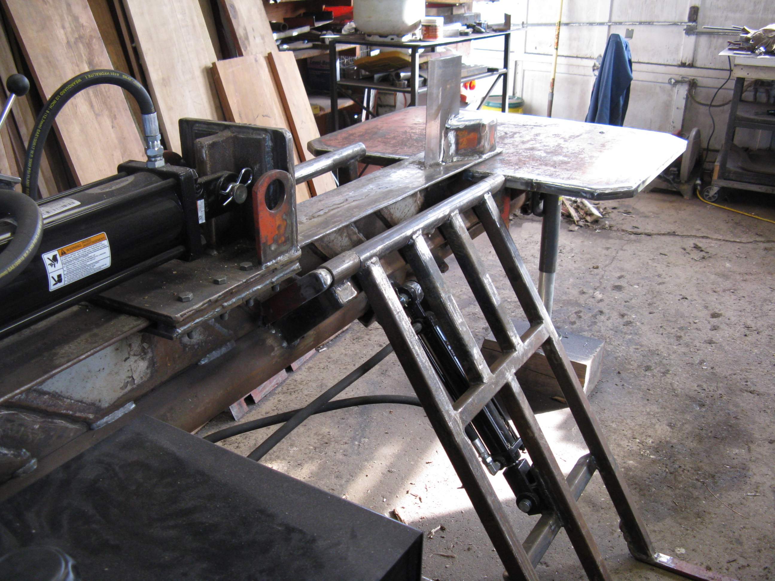

Here's a couple of items that, in hindsight, I would do a little differently:
1. Log lift hinge.
I used 5/8" hot roll solid round for the pins ... seems a little undersized to me now. Probably would have been better to use 3/4" or 1" pins and used some bosses on the brackets (which are 3/8" thick) or on the log lift frame tubes. The hinge and pins aren't really greasable at this point ... and I suspect they will probably wear pretty quick.
Another thing is the actual location of the log lift itself when it's raised - it's high and close enough to the beam that the push block will hit it if the push block cylinder is extended while the log lift is up. In fact, I've already managed to do that ... fortunately I was at least paying enough attention to stop it ... otherwise I would ripped the brackets completely off the beam. I could handle this pretty easily by trimming about an inch or so off the top of the log lift frame.
2. Fold-up table grate. By choosing to locate the bolts, which the table grate pivots on, at the very end of the table (nearest the splitter beam), the table grate cannot be folded up all the way when the log lift is in it's raised position. This could have been avoided by relocating the bolts which provide the pivot, a few inches further out towards the end of the beam.

I think you will end up wanting to re do the log lift hinges. Either before or after someone accidentally tears them off;)
On my last splitter I used pillow blocks.... This time I used pipe over round stock. There is to much play in them to make it worthwhile to even grease them. In practice the lift gets relatively little use so I think they shouldn't wear too fast. Hopefully I have a lathe to make replacements by the time they wear out

I used pipe inside of pipe. With the pipe at the end of the log lift table there are no pinch points. I did drill and tap the log lift pipe and installed a grease fitting.

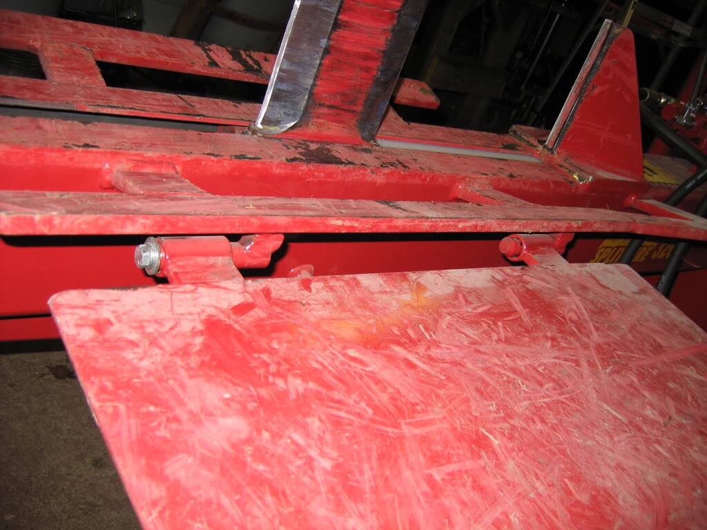

Here's the split fire design that I borrowed. I don't think they have fittings... The hinge looks to have a lot of play. image.jpg
LOL ... yeah ...
I've managed to hit the lift twice more since I last posted about it ... too many Homer Simpson moments ... :laughing:
Good news is my welds appear to be holding ... :D
But I think modification for clearance is on the "to do" list for tomorrow.
Now that's an idea ...
Right.
Makes sense.
I can see where here it might not get used all that much - if I'm gathering wood here off the property. The rounds - which tend to be smaller - go into the loader bucket ... which is it's own "log lift" ...
But I've been using it quite a bit today with what I had on hand ... load it with 6 - 8 rounds and then use it as an infeed table.
Of course, that does have it's (potential) downsides ... :rolleyes:
There ya go ... :thumbsup:
Nice ... looks good ... :thumbsup:
Like it - nice and simple ... plus it allows for having a cradle/support on both sides and not just one (something I can already see the benefit of)
