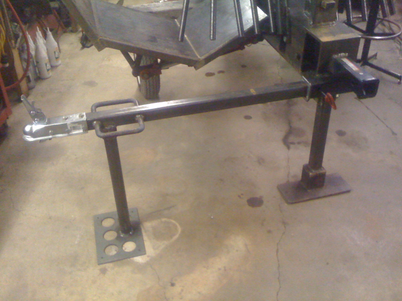

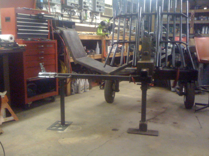

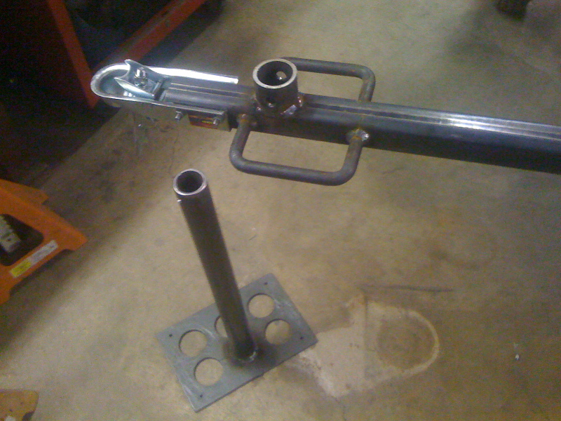

I cut a 2" long section off a drop of some 2" Schedule 80 pipe I had lying around for the receiver cup and a 22" or so long piece off of some extra 1 1/2" Schedule 80 for the leg. Drlled 5/8" holes in both for a retaining pin.
Then I welded the receiver cup onto the drawbar and welded the leg onto a piece of 1/4" plate that had previously been a mount for the head/terminal of a Qualcomm satellite tracking unit:
/ Logsplitter 2.0
#272
Still have to weld up a retaining pin ... and I'll probably use another short piece of that 2" Schedule 80 pipe to make a storage bracket for the leg/foot assembly, but the log lift outrigger/stabilizer is mostly done at this point:

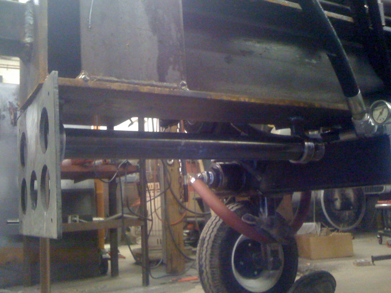

I did manage to get the engine to run at an idle last night ... by removing one of the springs attached to the governor arm.
It's not right - since the spring should be there ... but at least I have confirmed that the engine will run fine at an idle.
Also fixed the clearance issue between the log lift and the push block.

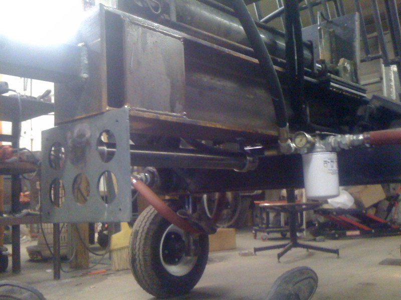

Storage setup for the leg/foot of the outrigger/stabilizer for the log lift:
