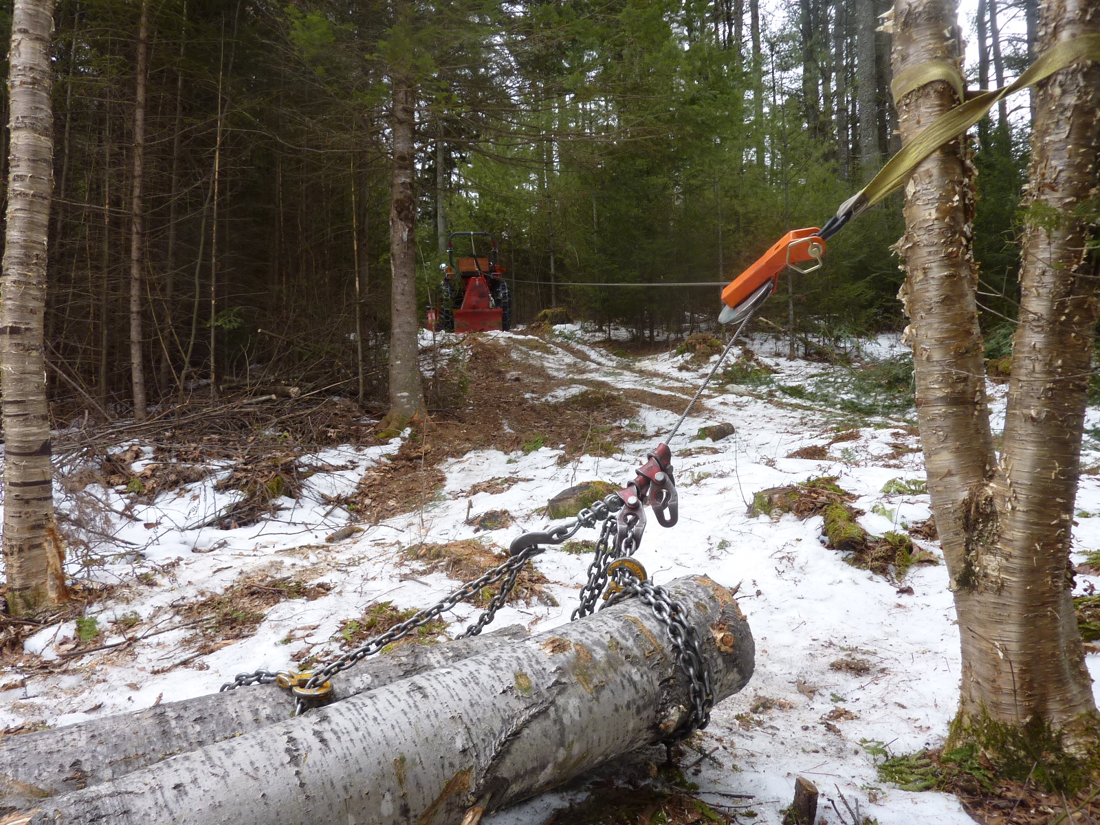

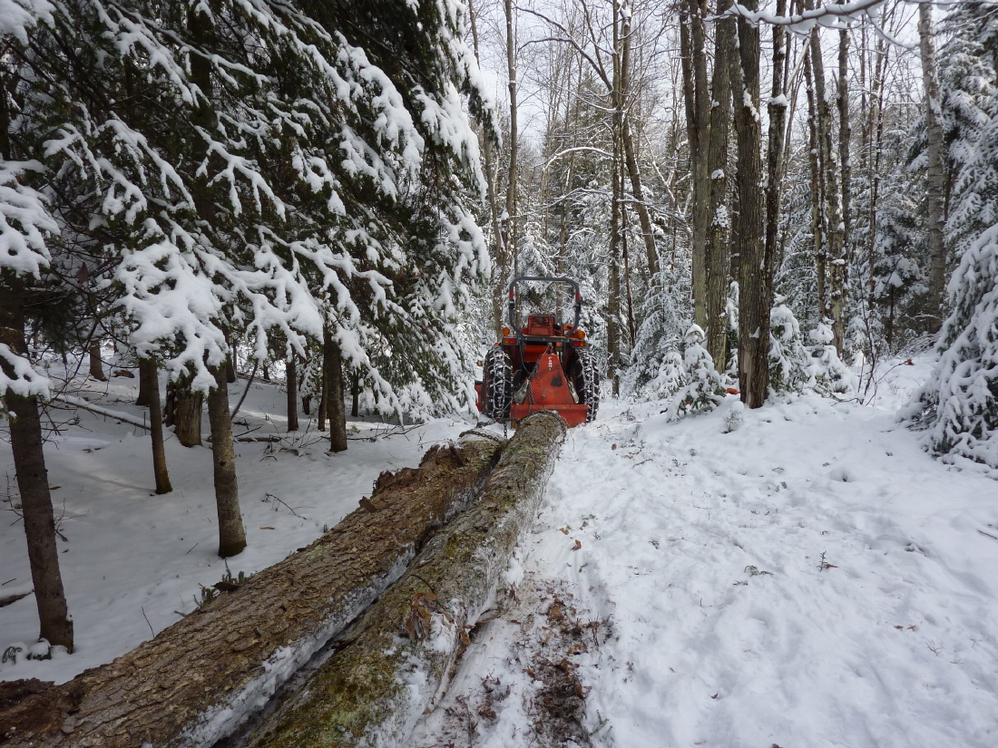

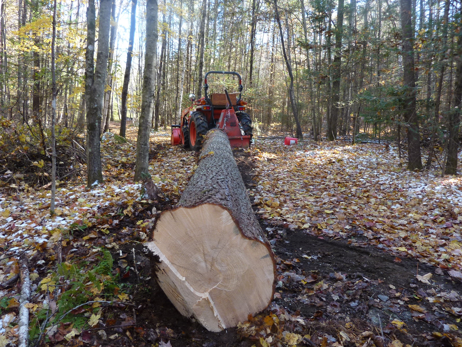

/ Logging winch? #3
Just to give you an idea of what a small winch will do I pulled this log out with a Farmi 290 which has a 6400 lb pull. My tractor weighs 5000 lbs the way I have it set up. IMO that size winch is a perfect match for my tractor. Tractor hp is at the high end of the winch specified range.

/ Logging winch? #6
Looking at Gordon's pics - I have a question. Wouldn't a stout chain/cable connected to the tractor's drawbar do the same job? In other words - what are the advantages of using a logging winch over just pulling with the drawbar?
/ Logging winch? #7
An anchored winch will pull MUCH more than a tractor will pull...
The anchored winch doesn't have to worry about traction...
SR
/ Logging winch? #8
AH..... thank you SR. I knew there must be a valid reason.
/ Logging winch? #9
So we have two different opinions - that is life. Our opinions for the most part are made up from our experiences.
Yes I try to anchor the winch in the ground. When the winch anchors deep it is a beautiful thing. But there are many many times that a winch will not anchor itself enough to hold in a hard pull. Anyone who has used a winch much has had their tractor jerked around during a hard pull or on a snag. Plus where I work the ground is frozen solid during the best part of logging season - you don't anchor in that and it is the best time to get clean wood.
Some times you are forced to work in a slash pile, or where there are roots, or ledge, or a super thick duff layer loaded with branches - you don't anchor well in that either.
You have a great big strong heavy tractor and it will handle a big winch. You probably would have a hard time finding a winch to big for it. The OP and I have small tractors it would be easy to get a winch that is to big.

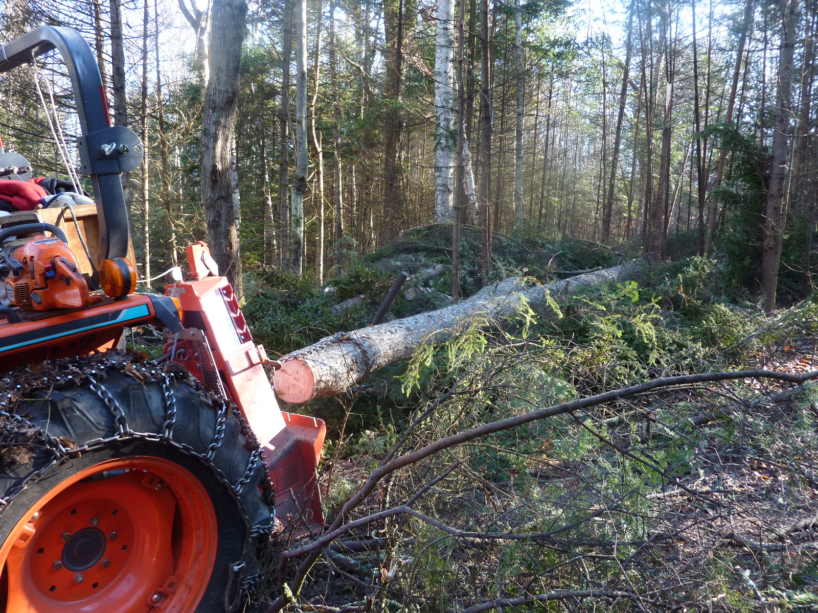

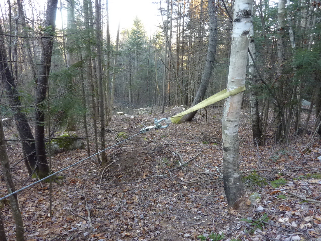

Rob is right that you can pull more with the winch than a chain on the draw bar. But you can also just cut it small enough to use the draw bar. It has been done that way for ages. To me the real advantage of the winch is that you can get wood that is inaccessible to the tractor. You can reach into the woods from a good trail. This is especially important when working hills and ravines with a tractor.
