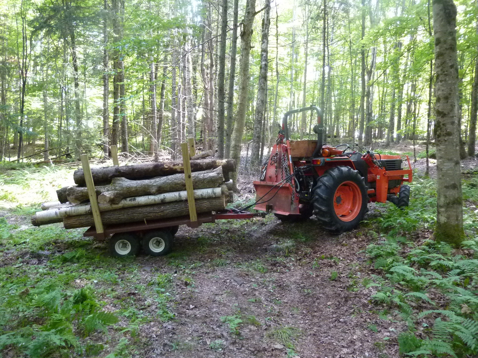

Op - I have a Farmi JL501 for my tractor. Bought it used several years ago, and it has been one of the best tractor purchases I've made. The only thing I would have liked it to have is a 2" square receiver tube built in. That would be super handy for hooking up a supply trailer without having to take the winch off. I think the larger Wallenstein's have it, but I haven't seen it on the smaller ones. Either way, the winch makes logging so much easier. I mostly use mine for firewood, but it keeps the tractor on the trail and safe as compared to trying to traverse hillsides or muddy areas.
If you want to make some extra chokers, check out Mytee Products. They had good prices on the hooks and other parts when I made mine.
I read this as an excuse to buy a welder. :ROFLMAO:
Once you own a welder, anything you own becomes anything you want.
I have welded hitch receivers onto more than one of my past and present tractor implements. Tractor supply stocks two nice weld-on options, or at least they used to.
/ Log winch #49
You are right - a receiver hitch on the winch is super handy. If you can't weld you could bring your winch to a welder or a welding friend and have them put one in. It's not a big job. I put a 2" hitch on my Farmi JL 290 winch and a 1-1/4" hitch on my trailer.

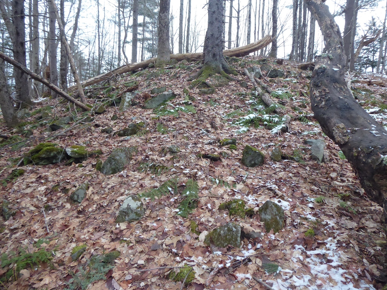

Have an older Farmi winch with a L3600. Works great, I have very steep hills that a winch can pull the logs up, I could never get a tractor close. The learning curve using a winch is very steep. Make sure to stay out of the way of the cable and never, ever try to winch a single log down hill. It will not end up good. 2+ logs ok, 1 log, NO. The winch can pull faster that you think, and can really move the tractor when(not if) the log hangs on something. But it is an awesome piece of equipment.

Was winching 28"x 12' log down a double sloped hill ( sloped in 2 directions, not straight down). Log started rolling down the cross slope, tried to slow it down with the winch, not a good idea. When it started to move the tractor sideways, I just let the winch freespool. The log flattened a welded wire fence (just T post) launched over a 10-15' bank, down onto a road, as in numbered highway. We are very rural, but I was lucky no traffic. Landed in the middle of the road, still hooked to the winch, so I just pulled it into the ditch, unhooked, drove around, rehooked and pulled it down the road to the mill. Butt section, big white pine, no limbs to stop the roll. I had taken logs down the same hill with a logging arch, which was also interesting.
I was lucky, but the lesson will not be forgotten. Learning curve with equipment is sharp, just like our mountain curves.

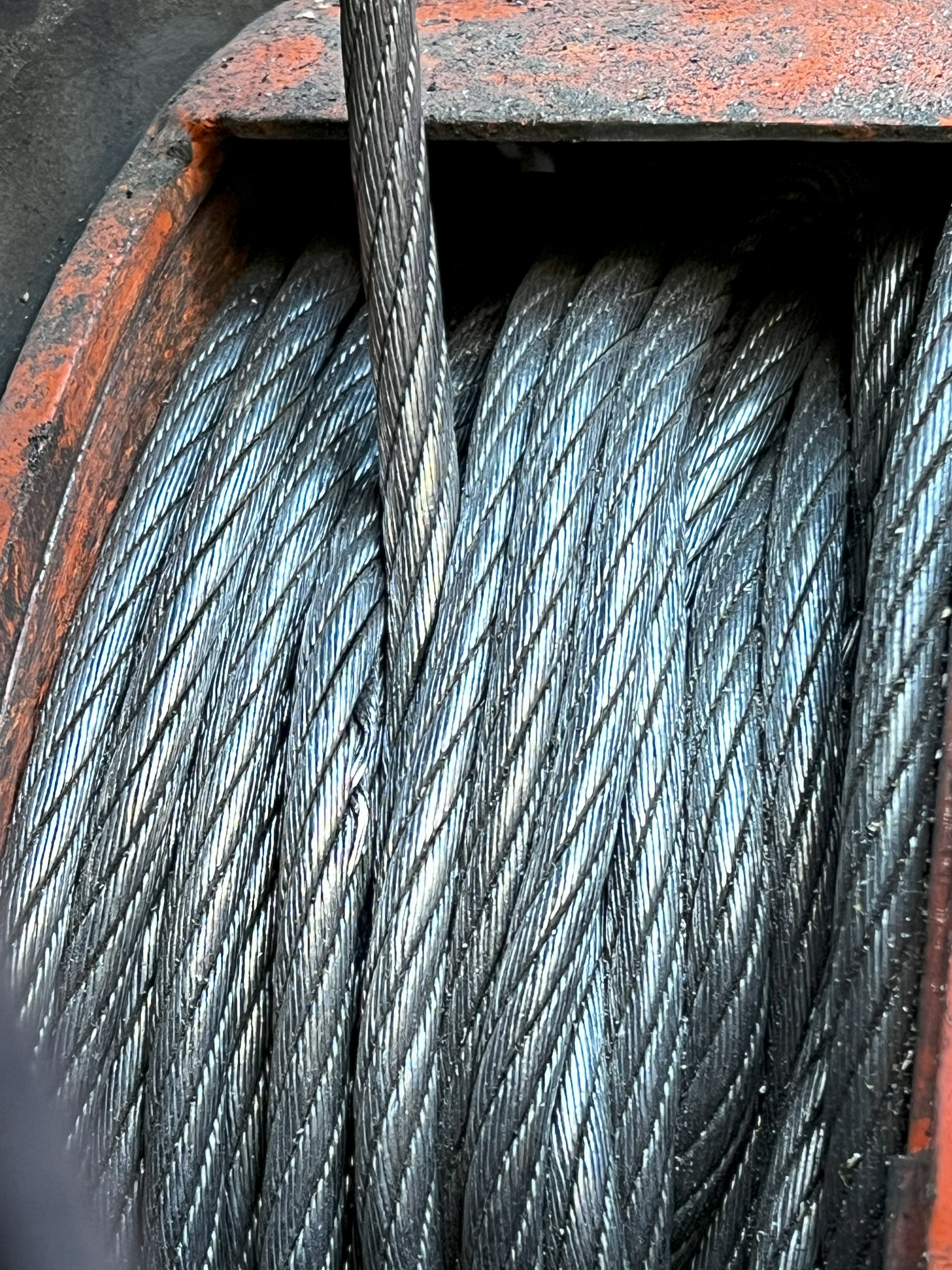

I have an identical twin of the MechMaxx FW8800, designed and made in China. Mine is sold by TMG. The manuals for both share the same inaccurate exploded parts diagram which show many parts on the wrong side of the frame. It is a thoroughly mediocre winch, but priced accordingly. It lacks nearly all the features that make more expensive winches worth their price. Here are a few tips for this Volkswagen Beetle of winches:
1. Manage the wire rope! If you spool it loose, do not pull hard with it that way or you'll damage the rope. Unspool it back out and then respool under tension; you can do this by letting the winch pull the tractor up a 5-10% grade.
1a. Don't 2-block the rope! I.e. don't pull the end of the rope into the winch. It'll dead end on the head pully and put a permanent set in the rope. Any rope damage will make it difficult or impossible to unspool it by hand.
1b. Don't unspool the base layer of rope from the sheave. If you do, or when installing new rope, respool it under tension and avoid overlap. Make sure the base layer is neat and tight.
1.c. When installing new wire rope, match the direction of curvature of the shipped rope to the sheave axis. In other words, bend it in the same direction as shipped.
1.d. Lubricate the rope. The individual wires need to have relative movement.
More expensive winches have features that automate rope management. A rewind brake ensures that the rope winds with tension. An anti-2-block device prevents the end of the rope from deadheading into the winch.
2. Don't reinstall guard 65 as shown attached. Without the guard, you can see the drum and thus monitor any malfunctions such as overlap. You can also see whether the chain and sprockets are skipping. (But if you're an employer, reinstall all guards.)
3. Tighten the chain immediately if it skips teeth, and preferably before it skips teeth. Grease the chain, sprockets, and rope.
4. Don't pull to the side. The winch will easily roll the tractor.
5. I'd sit in the tractor on the PTO rather than next to the winch on the clutch lever.
6. If MechMaxx is anything like TMG, they know less about the winch than you do even if this thread is all you know. In other words, they know exactly zero. They've never used this winch or any other.
