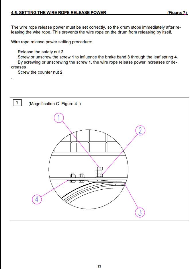

   / Logging winch- New user with questions! #62
I have a drum brake, but in order to release the cable I need to put in in "neutral" so its free spinning. When I reach the log the operator put the brake back on but there is always extra cable that got rolled out and I need to take the slack out before winching. I could roll the tractor forward to eliminate it but once the back blade dug itself a nice rest spot id rather leave it there.
Many winches have a separate "drag brake" that puts a slight drag on the spool, preventing it from completely freewheeling as you pull out cable. Some cable (especially newer cable) wants to "self unwind" (almost like winding up a spring and then letting go. Also, if you are pulling cable out quickly, the spool has some momentum and can keep turning, throwing a bit of slack in the wraps on the spool. On my winch, that drag brake takes the form of a thumb screw with a lock nut. I loosen the lock nut, and set the drag do that the cable is still easy to pull out, but things stop turning when I stop pulling.
I think the type of slack noted above is what Agvg was thinking of when he asked about your drum brake. This is not the main brake that holds the cable when you are not actively winching or pulling out cable.
My impression is that you are talking about slack from a different cause: when you pulled out more than you needed to reach some logs you will be winching (or as I mentioned in a previous post, when slack develops for other reasons, such as releasing a snatch block). In Agvg's case, the key is preventing one cause of slack from happening in the first place. In the other case, it's about what to do with slack that is already there on the ground.

Ok thanks I will check to see if its set-up properly on my winch. But if for some reason too much cable was pulled out what is the best way to prevent a snag on the drum?
You must retention the wire from time to time, attach the wire to a tree, drive untill you have a couple of turns of wire, then pull the tractor in, is it flat push the brakes so it is some resistance.
