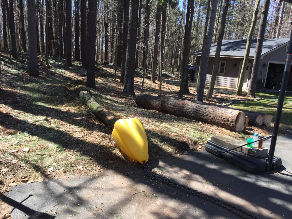

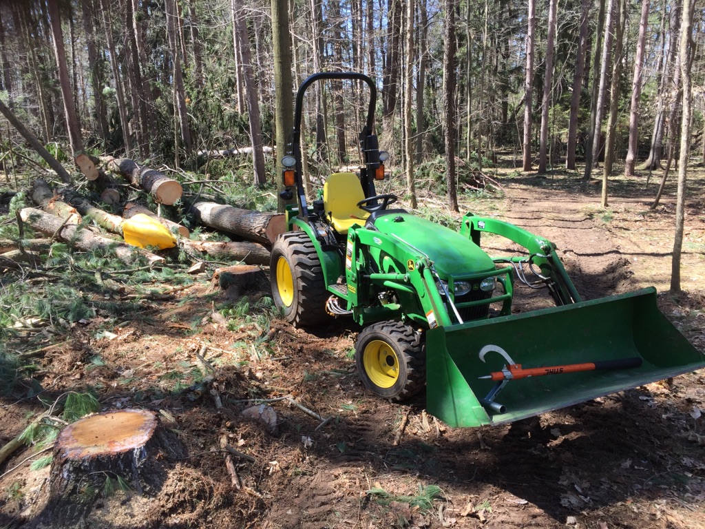

Thank you for the excellent info, Oldpath. I never knew there was such thing as a skidding cone. Definitely going to look into that.
I used this one and it worked well. It's not inexpensive but it is fairly indestructable.
