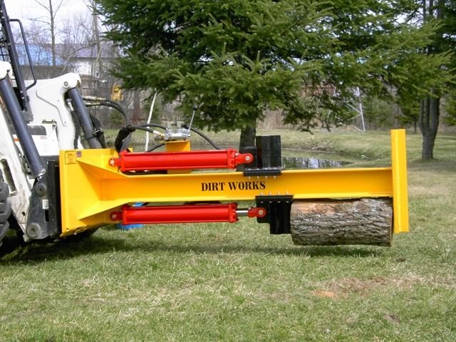

/ Log Splitter #14
American Bulldog,
The single or the dual log splitter on your Pt-1460, would be awesome. You have more than enough hydraulics for them. Just add a log lift, and make little wood out of big wood.

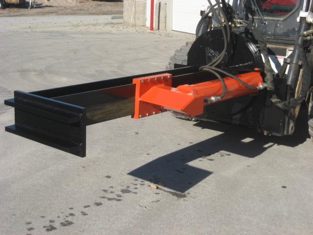

/ Log Splitter #15
Here is a 360 degree splitter, so you can cut trees down., plus any other position.

Thanks for all the tips. JJ that dual unit is pretty clever.
I talked to Timberwolf and their unit really seems like the best one. I can get it with a log lift, and a hydraulic 4 and 6 way wedge on it. I guess that the pressure on the PT, listed at 3000 psi, is higher than most skid steer pto's. The Timberwolf is rated for 3000 psi max. The biggest drawback is the resale value. If I buy a Tiberwolf TW-5 and keep it in like new condition, I can sell it for 75% of what I paid. The skid steer attachment with a PT QA plate on it would be a bit tougher. I would be lucky to get 50% of what I paid.
One advantage with the PT is that the pump can still put out the GPM even at 3000 psi. Typical hydraulic splitters have two stage pumps, and the GPM number is only on the first stage, at much lower pressure.
I need to give Terry a call a verify the specifications from the website.
/ Log Splitter
#19
Actually JJ I looked and the Dirt Works are only rated for 2500 psi.
They may have a regulator available though.
