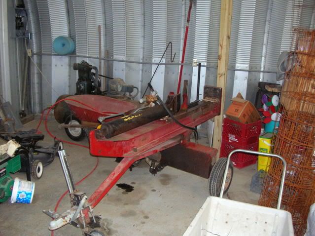

My 8 hp splitter is an older TSC Husky and is horizontal or verticle. About waist high horizontal and that's how I use it the most. With the 5 hp or the 8 hp splitters, I've never tried it on anything that they wouldn't split. I burn lots of hedge, it's very twisted and gnarly but good wood, burns very hot. Here is the 8hp, not a very good picture (sorry)
