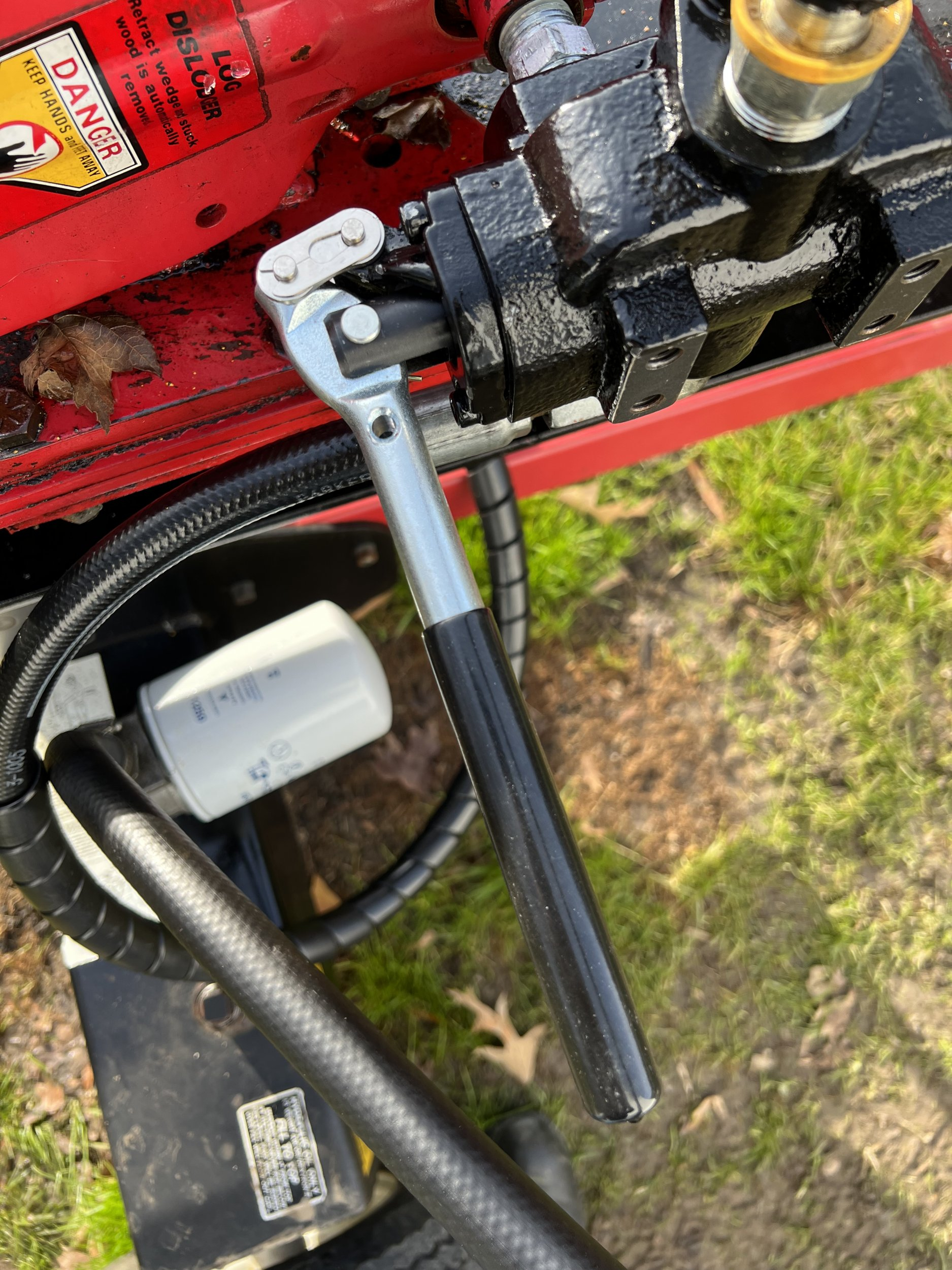

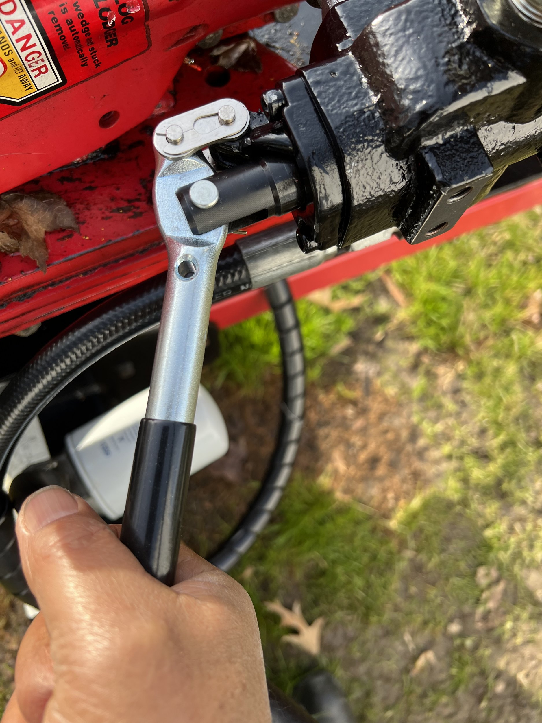

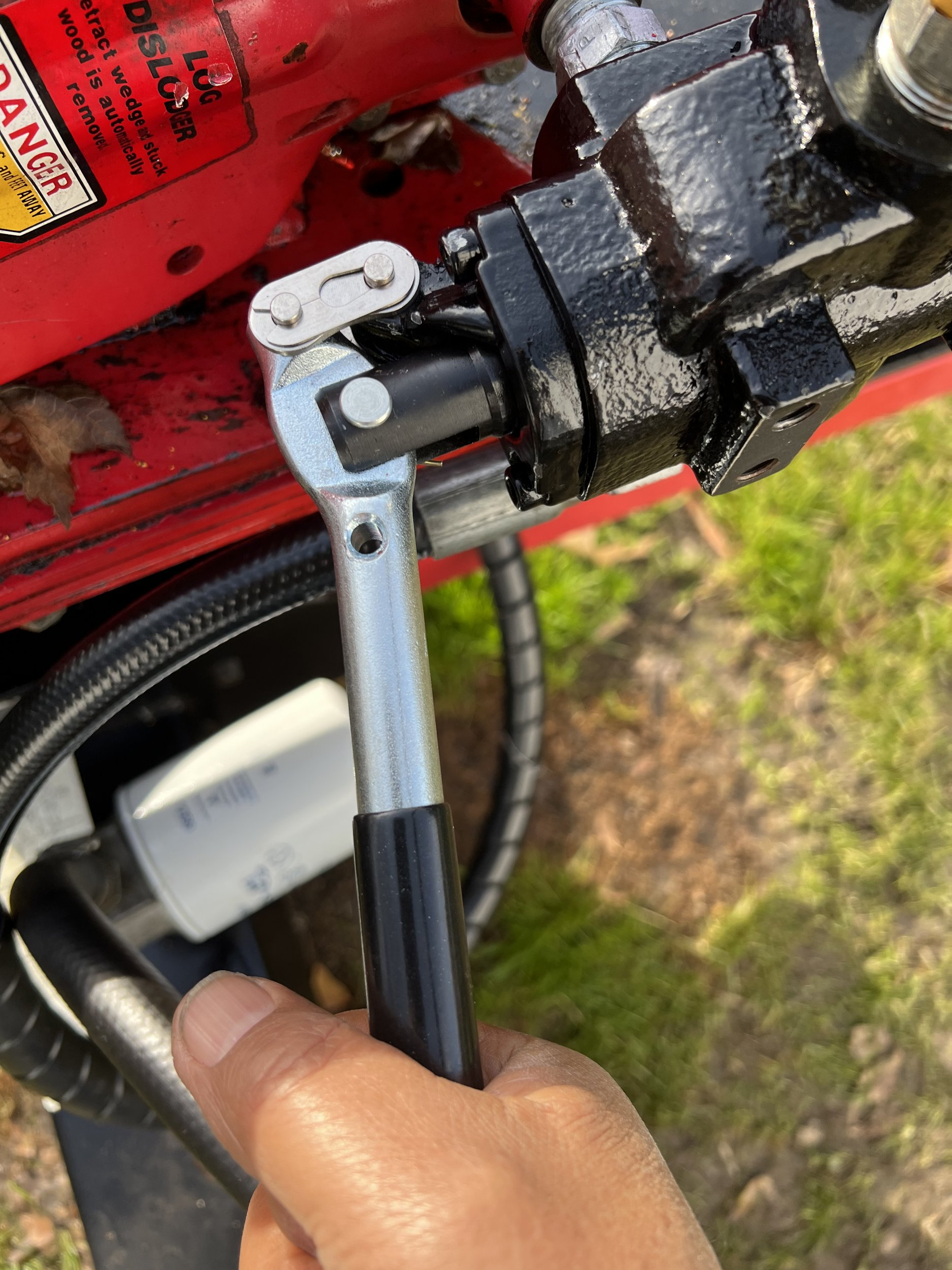

The reason I wanted to upload a video was to show how the control handle made contact with the valve body which would not allow me to apply the pressure cycle. Please look at my finger pointing.
/ New log splitter control valve. #22
The handle can be set to operate in different directions
#23
I tried to mount the handle differently to no avail. At any rate, tomorrow I am going to try a new handle. I will keep you guys posted.

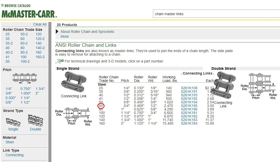

Problem is the "link" is to long.... Made for old valve.....
610fd4ca-ad37-4e76-8c77-a65035afc136-jpeg.774305
You probably have enough material in existing link to cut it back and drill new hole....
You really need is a chain master link or fabricate link that is shorter.... As in your second picture....
7ee98b7a-981e-4fb7-8513-5395b51e6d18-png.774306
Master link can be available at most any "Gear/Bearing" distributor/shop.... Take handle in so you can gauge pin size of chain to fit it properly...
p1020239-jpg.772323
Chain master link is #60 (3/4 inch) on my control valve ...

/ New log splitter control valve. #25
I'm not seeming to follow everything here - of course I could be lost way off base - but looking at your picture in post#8, why couldn't you just flip the valve around - to the left, mount as same - and then your "flexible" hoses would be inserted into the correct ports and valve would respond as expected? All this modifying of the valve would not be required? Yes the handle would be slightly off from original, but so what?
#26
Good morning, the hydraulic connection have been corrected. The problem now is with the control lever. I am getting a new lever and linkage today. I will keep everyone posted on the new linkage install.
#27
New updated handle and linkage to match the new version control valve and now everything is working perfectly.
My thanks to all for their time, patience and suggestions on how to solve my problem.
Best regards
Melvin.
