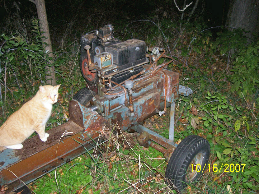

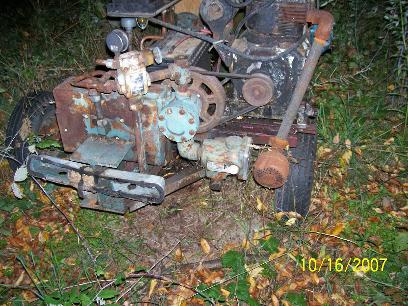

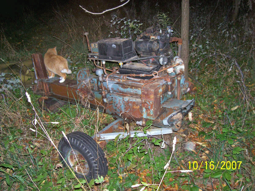

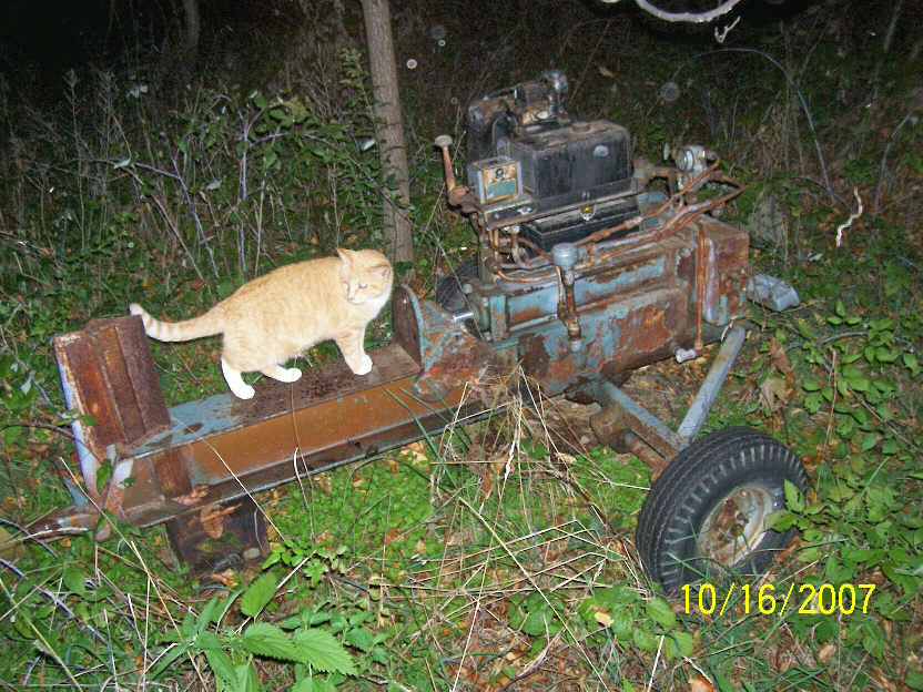

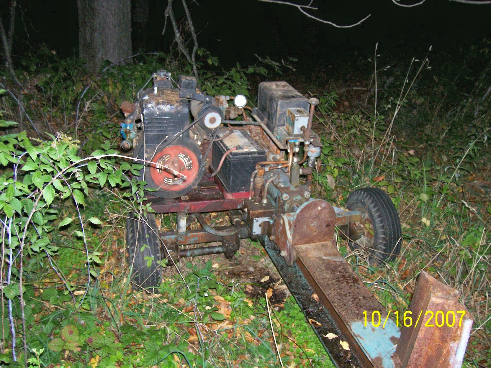

Back to this log splitter issue...The lines are steel but have some sort of copper colored paint on them. I guess it did work well for many years. And it does have a filter! Never saw one like this before, as it has a dial indicator on the outside showing when it's cleaning time!! The cylinder base was swapped out to a 2" thick steel plate. It has MANY holes in it! No idea what it was originally used for, but it works well for this application. Much of the plumbing goes to this plate. It's a very heavy beast and VERY well balanced.
I agree with the idea of having wings straddling the cylinder/wedge guide. Also some wing extensions past the wedge is a must. Wish I had an extra cylinder to work a wing lift. Now THAT'S the ticket! Maybe in the future I can fab one up.
By the way, I just noticed I posted this in a topic right above the more appropriate hydraulic one. If the moderators would care to move it, that would be fine....
Thanks for the suggestions and help. WIll take it all into consideration....

Your splitter looks to be very well built. With a little maintenance and upgrading I think it will give you years of service.
In regards to the wing issue. When I built mine I wanted a platform to catch the split wood. Also wanted some sort of wings along the beam to make it easier to hold a large log on the splitter. I made mine flat with the beam and still catch the table occassionally with a very big log so I'm glad I didn't raise the wings or angle the platform. My platform is removeable and uses square tubing of two different sizes so you simply pick the platform and wings up in one piece and they come off. My platform could be a little larger but I didn't want it to interfere with splitting from either side. Here's a couple pics for ideas. If you look at the last one you can see that if I had angle my platform or built my wings raised above the beam I would have had trouble with this log.
