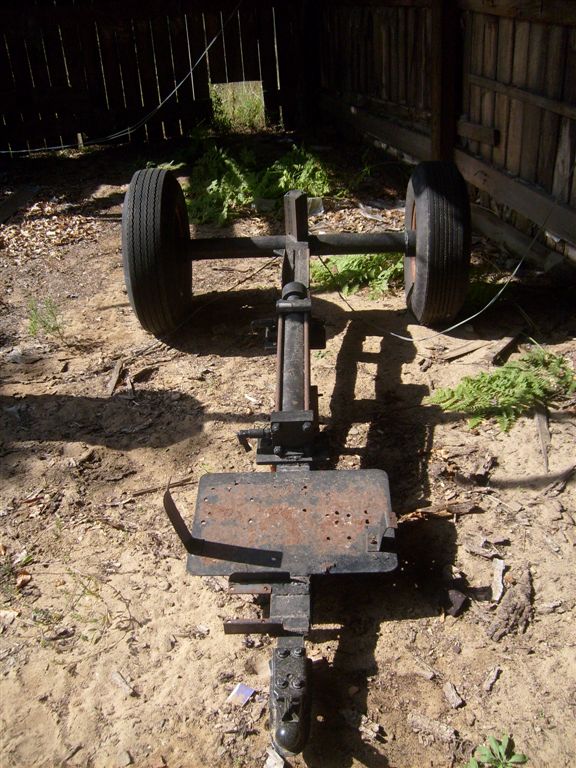

I've been looking for a log splitter to use with my tractor, but on a very tight budget (burning wood is supposed to save money right!). I supplement with a wood-burning fireplace insert and consume 9-12 face cords/season (3-4 full cords).
I've been watching craigslist for a log splitter with a bad pump or engine but good cylinder using the hydralics from my tractor. I finally came across one for $50 (see attachments) without a pump or engine nor hydraulic valve which seems like a good price. I plan to bring it home and then connect it directly to my rear aux. hydrualic quick connects (1/2"?) pioneer quick connects, controlled by an a/b valve with detents on the tractor. That will be enough to test the function of the splitter and get started splitting for this year! If it checks out okay I plan to remove the axle and get it setup for hooking to the 3-point and then clean & paint. I like the idea of the new regenerative-type hydralic valve and plan to add that after I determine the splitter to be good.
I need some help ordering the right hydraulic lines, seems like everyone likes surpluscenter.com: which size is appropriate? I have a Kioti CK20S which has "7.66 GPM total flow", not sure how much is available at the aux. outlets. When I add the regen. valve should I use short pieces of larger diameter line to/from the valve due to the increased flow?
Thanks!
Josh

Just match the hose size to the port size.
/ Log splitter on a budget project! #3
I would run 1/2" hoses to match your qd's. I hope you are in no hurry. Your 7.66gpm will be your most limiting factor. GPM is rated at the pump. By the time you run through your hoses and valves, you can cut that back. It will work, but it will not be a speed demon.

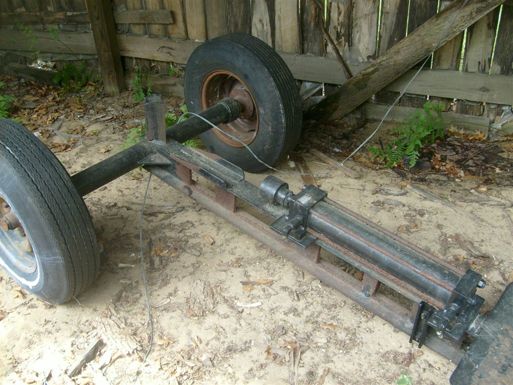

Well I picked up the splitter yesterday. 3 1/4" cylinder, 18" stroke.
I stopped at TSC on the way home to match up port sizes, it has 1/2" in and out. I bought swivel connectors for the cylinder side, 1/2 hose (one 8' one 10'), I already had pioneer 1/2" connectors, and then a set of dust caps. About $70 for those pieces, so I'm ~$120 deep into the project.
Brought it home, flushed some clean fluid into both sides of the cylinder by moving the ram back and forth, and then connected up the new lines. Started the tractor, engaged the valve and waited a few seconds for the fluid to fill. The ram moved! Great I thought, it works!
I retracted the ram completely and fetched a piece of Ash that was already cut & split to size just to make sure it works. The ram moved up to the wood and just stopped moving...Has no power. It can split small pieces of kindling wood but that's it. I had the tractor's hydraulic pressure checked with the 50 hour service that was done a week ago and it checked right at 2,250 psi. With the 3.25" cylinder I figure I should have over 9 tons of force...
Does this mean the internal seals are bad or could I have air in the system somewhere? I topped off the tractor's hydraulic reservoir, it was 1/2-1 gallon low from filling the cylinder and lines but no change. I can hear it go into relief when I retract the cylinder completely but when it stops extending at the wood the sound of the tractor pump changes very little...
I attached some crappy camera phone pictures of the rig.
Your thoughts?

Bummer.
Can you detail exactly how you have it plumbed to the tractor?
What valve did you use?
...snip snip...
So if it's bypassing internally it only happens in the extend direction. Could you be going to a "float" detent on your remote valve? Try reversing the hoses.
McMaster Carr has seals listed by dimension if you can't find the exact kit.

Thanks for everyones input.
The splitter is plumbed to my rear remote circuit, which is controlled by a dual acting valve with detents in both directions. I wanted to verify the cylinder was good before buying a regen valve (and it looks like it isn't!).
It is made by the Peninsular brand Mich Iron mentioned below. It's a MMHC-505, 3.25" cylinder diameter. I've been working with Bob @ Michigan Iron on how I should proceed, he has been very helpful as always! He got pricing for a rebuild kit and it's obnoxiously priced at more than $140!
I may go the McMaster Carr/custom route, or just replace the cylinder with a 3.5". So much for the budget! Agggh.
