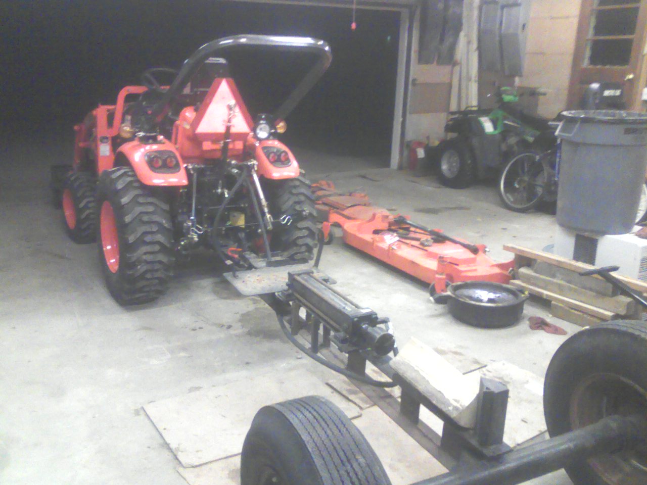

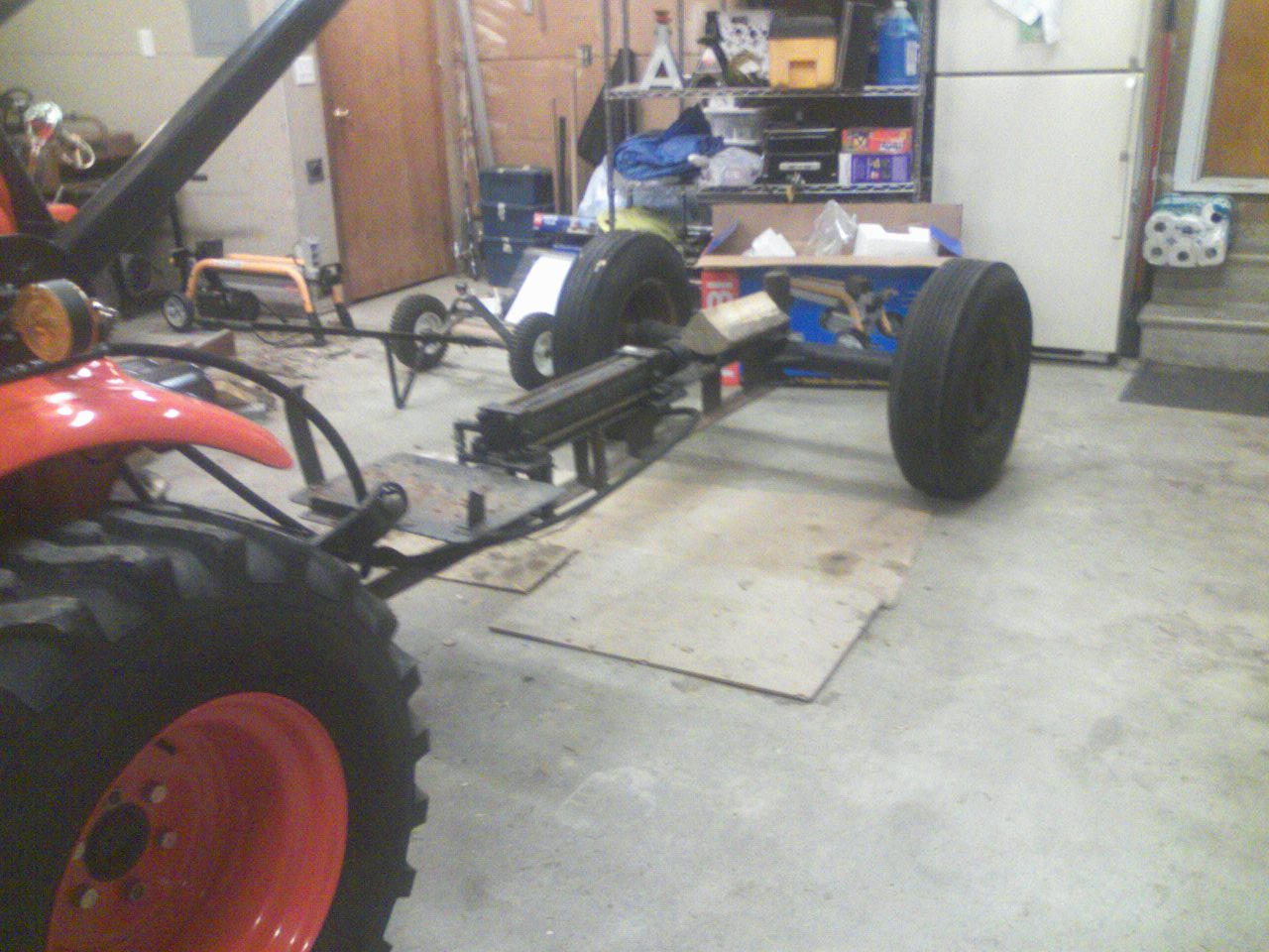

The splitter is plumbed to my rear remote circuit, which is controlled by a dual acting valve with detents in both directions. I wanted to verify the cylinder was good before buying a regen valve (and it looks like it isn't!).
It is made by the Peninsular brand Mich Iron mentioned below. It's a MMHC-505, 3.25" cylinder diameter. I've been working with Bob @ Michigan Iron on how I should proceed, he has been very helpful as always! He got pricing for a rebuild kit and it's obnoxiously priced at more than $140!
I may go the McMaster Carr/custom route, or just replace the cylinder with a 3.5". So much for the budget! Agggh.
To check that cylinder for bypassing, do this. With the rod extended all the way out, remove the rod end hose at the valve, and place in a clean bucket. Start the engine, and keep the rod extended for several minutes, and if it is bypassing/leaking past the piston seals, then fluid will continue to come out the hose. If the relief does not come on, that tells you that the fluid on the base side is not building up to operating pressure. Check the detent valve before the log splitter valve, to see if fluid is being relieved. Also check the pressure on the log splitter valve, with a test gage.
