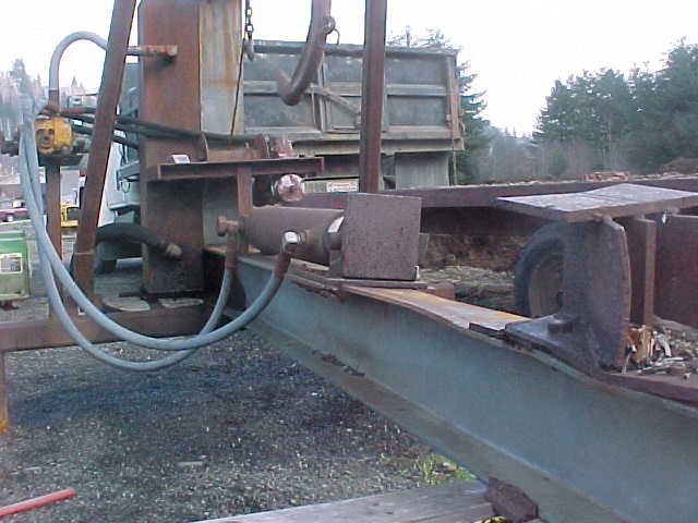

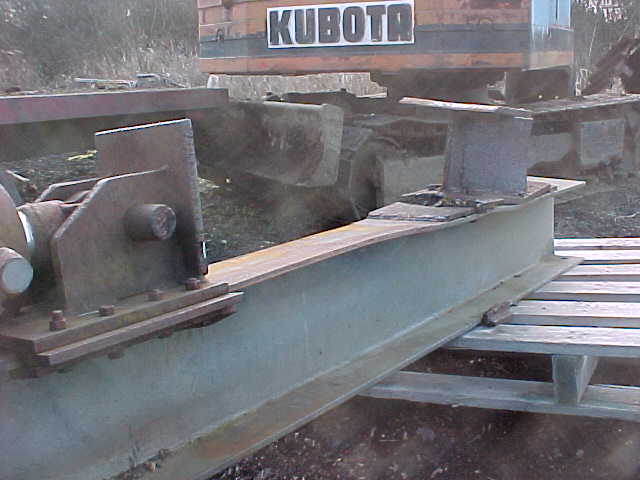

My I beam is 61/2X81/2 and the top is 1/2" thick. As you can see by the warping of the top flange it should have been reinforced. The knife has 3/4 bolts in front and I have sheared them off, as you can see I have welded a pate behind the knife to help out. I have split some pretty ugly wood with it and it has held up to time, around 20 yrs old now. I run it with the pto and it is totally self contained, is nice to take it to the wood on the 3pt and not havint to lift the heavy ones is a bonus.
Hope these piics help, if you would like some other angles just ask.

<font color="blue">the "log dislodger" ...reminds me of why I wouldn't want the wedge on the ram. </font> My total hours on the splitter are nothing compared to yours. However, I think the dislodger works pretty slick and haven't had any trouble by bringing the log back with the ram. The dislodger works every time. My maul just sits in the garage.
<font color="blue">If I have a log stuck on the wedge, I often will return the ram, and drop another unsplit piece onto the splitter, and then use it to push the stuck piece off the wedge. </font> Great idea!
<font color="blue"> the slide on the I- or H-beam tend to wear a lot and need a lot of attention to the wrap-around guide holding the pusher to the flange. </font> The slide on my unit has adjustable "gibs"...little pieces of metal that keep the slide aligned and are intended to wear and be replaced. Hopefully, they will work as intended. The adjusting bolts (2) for the gibs are just visible at the bottom of the picture attached to my post above.

<font color="blue"> maybe even laminate the top with a piece of half inch flat bar to stiffen it. </font>
The manufacturers have picked up on your idea. The picture attached to my post of 02/09 shows the laminated flat bar welded to the top surface of the I/H beam. Even when groaning on the toughest log, I never see any flex in the system. The vertical "web" of the beam may have more to do with that than the lamination.
