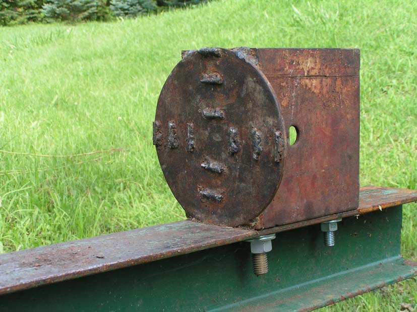

Hi! Trialsguy. The 4x4 H beam was free for me. A 4x6 will be better. BUT I think the best is a 6 in. x 8 in. Square(rect) tubing beam. More easy to weld more light more rigid and May be more strong. I seen in HD store the best Built wood splitter. They use the Square beam tube. the wedge or cutter run throw a slot in center beam. I look for a square tube beam. I join a pict of my stop end splitter. Wood never slip or go out. Good Luck ! Oldmech
