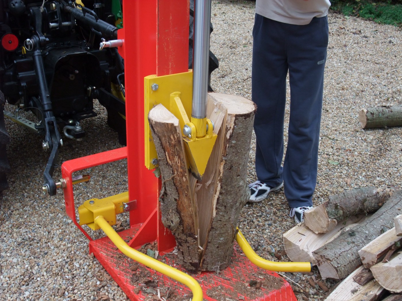

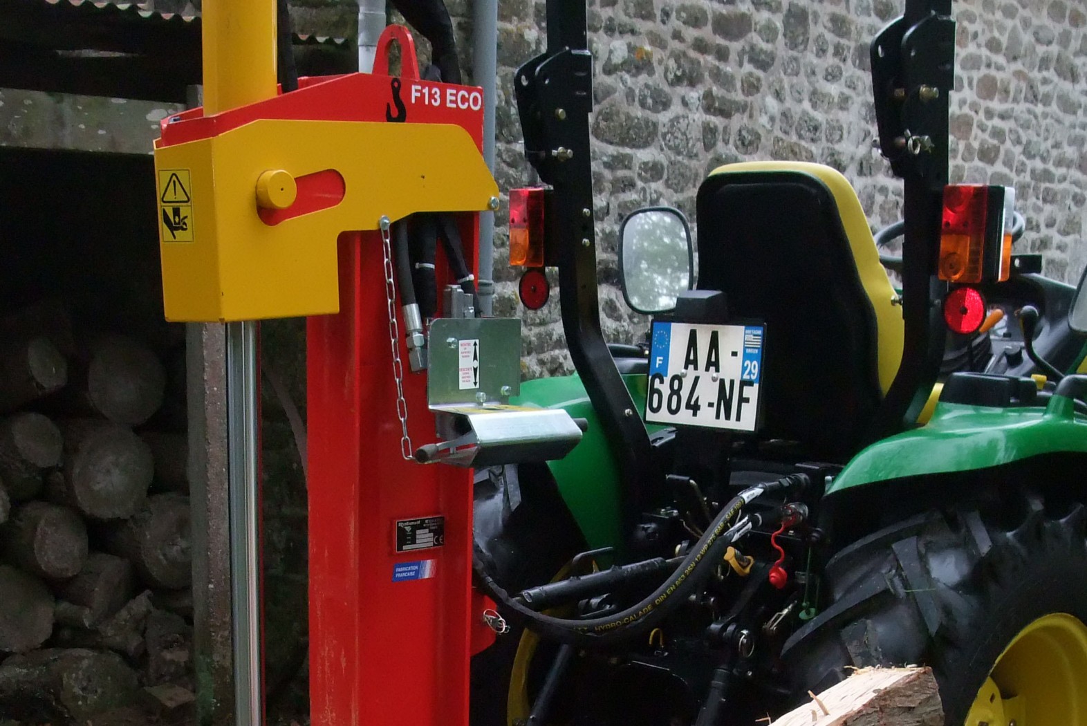

I didn't build it (not good enough at welding) but my 13 ton vertical splitter uses a fat I beam. The only thing that gives in slightly when the log is real hard is the bottom plate.
