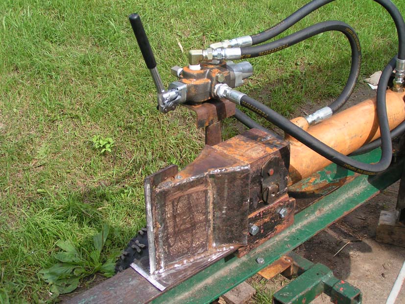

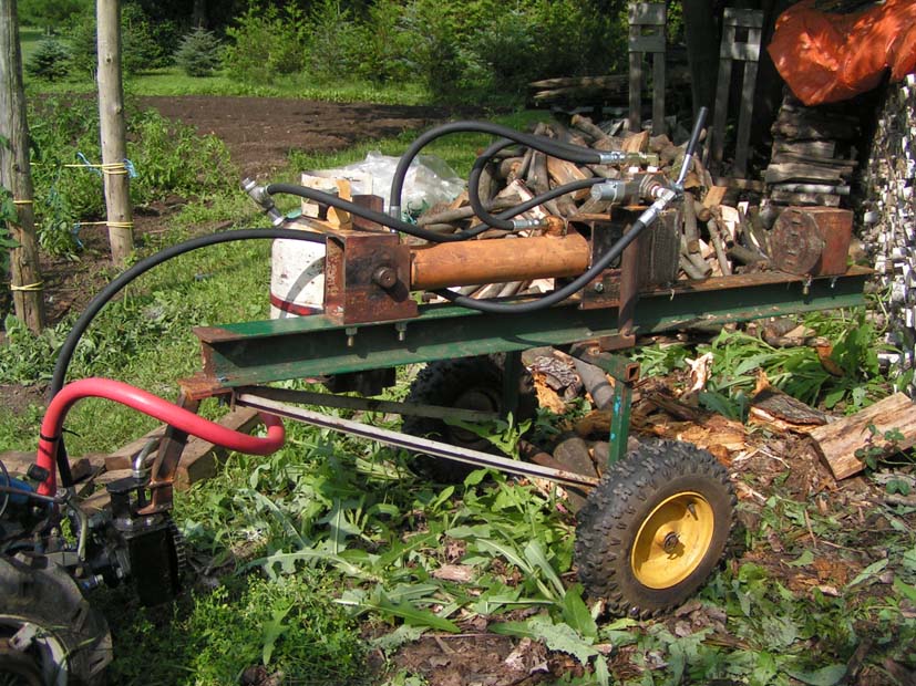

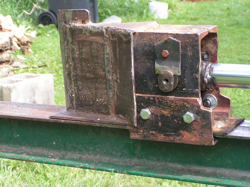

Hi! I make a wood splitter. I use 4x4 in. H beam On very hard wood the H beam bend or flex a little bit so more high beam is better as 4x6 in. I use 5/8 5grade bolts for improve later. My edge cutter work very well.I join some picts. Good luck ! Oldmech

If you look at oldmech's splitter (post #9, this thread) it looks as if he made a built-up wedge with lighter material than what you're talking about.

OldMech's splitter should be ample evidence of that.
