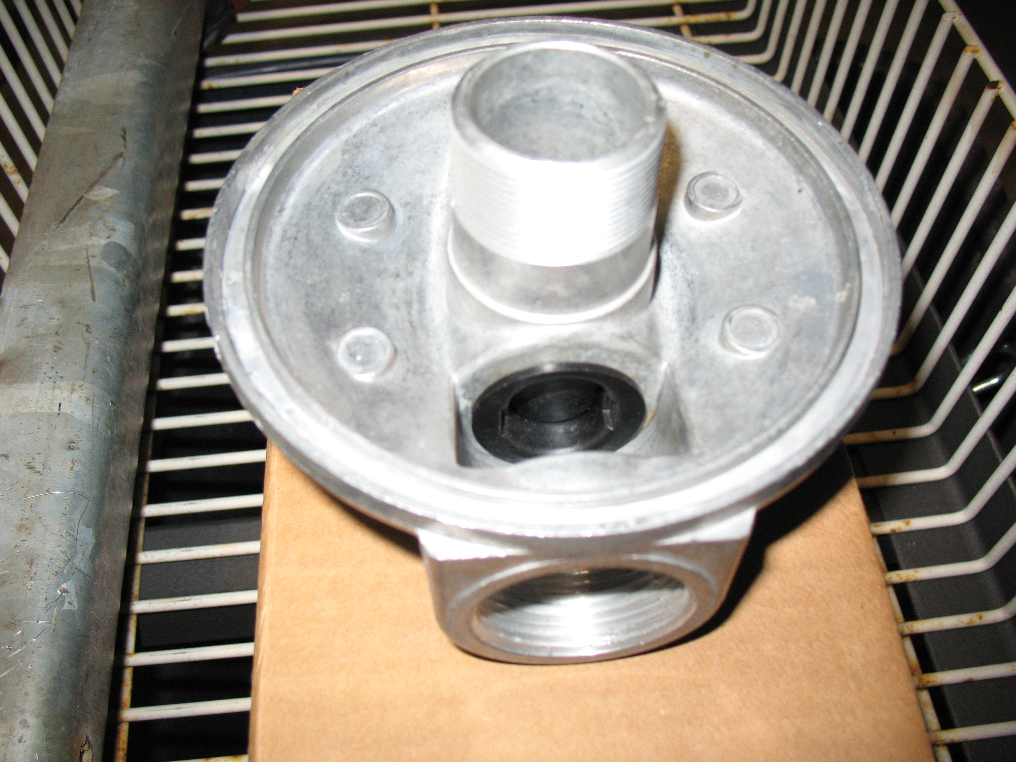

While splitting some 24" Red Elm, Nasty wet dead knarley wood, My filter would blow the gasket or when replaced and tightened, It would rip the filter case and spray fluid all over everything. It's in line to the return. Do I have something plugged on the input side? Just happened today and never before. I was splitting to its limit a lot today. You never get used to hydraulic fluid showers. Any ideas?

The filter heads usually have a by-pass valve sometimes the plastic plunger breaks causing blockage in the pipe discharging into the tank.

Spin-on filters typically fail from pressure spikes caused by flow surges. These surges can come from the cylinder decompression caused by going to system pressure and then the tree splits or from moving the directional valve from split to neutral to split repeatedly. Decompression flow is extremely high flow for a few milliseconds. This flow surge happens so fast that bypass valves typically can't respond. Amount of decompression shock depends on several variables some of which are: Amount of air in the oil, cylinder size, I.e. trapped volume, system pressure, etc.
Also adding these flow surges is the Hi-Lo pump used on most splitters. Above a preset pressure the high flow side quits sending fluid to the system. There is a sequence valve built into these pumps that allows the oil to circulate from the outlet back to the pump inlet. When the pressure drops this flow is directed back into the system.

We had the same problem with the small splitter, when the auto retract kicked off the spike was in the 1300psi range. we resolved it by taking the return line from the valve to the filter head (about 3 1/2 feet) and replaced it with a 1 1/2 tank suction line. The extra volume in the hose acts like a shock absorber taking the spike off the filter head. Jim

I have not yet cut the filter but I decided to empty the system and check everything. What I found was the Cross Filter mount has a spring loaded rod that I assume is a pressure relief? It was apart. The thin stainless disc, washer, keeper was off the rod and the clip that held it was also un connected. The disc was blocking the exit to the tank causing the pressure to blow the filters. I'n mot sure how this could un-assemble but it clearly was. I removed the filter system ( 10 micron, 22 gpm ) and hooked it up direct. Works fine. Question is, do I need that spring loaded apparatus in there or can I run it without? Also, My splitter has a Stainless steel screen filter with another very fine Stainless screen filter over it that is 3" in diameter and screws into the tank.. Its hooked to the hose coming out of the tank and goes to the pump. Is that enough filter? Thanks !

On the Cross return filter, did the disc assembly that is broken allow oil to go from the inlet to the outlet without going through the filter element? I suspect yes and if this is correct the filter is doing little or no good without the bypass valve.

If the bypass valve failed, I am not surprised the filter failed.
