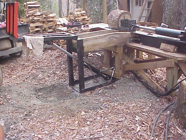

Not really a wrong way to build one.Everyone is different. Build one that suites you, and is ergonomic for you. And if built well with quality components it will bring decades of good use
Just for some diversity (*I'll be reviving my thread on the topic soon*) so just a couple of pics +...
+: I set this up temporarily as a stationary unit...I'm currently running it off my Ditch Witch* or tractor...my plan is to make it a mobile unit...along with a knuckle boom arm that will either attach to the mobile rig or to a 3PH...I made the log lift to use before I get to the knuckle boom...and I made it vertical (not just to be different)...so it is entirely out of the way when extracted...I could not ask for a more ergonomic rig...either with one or two people splitting...

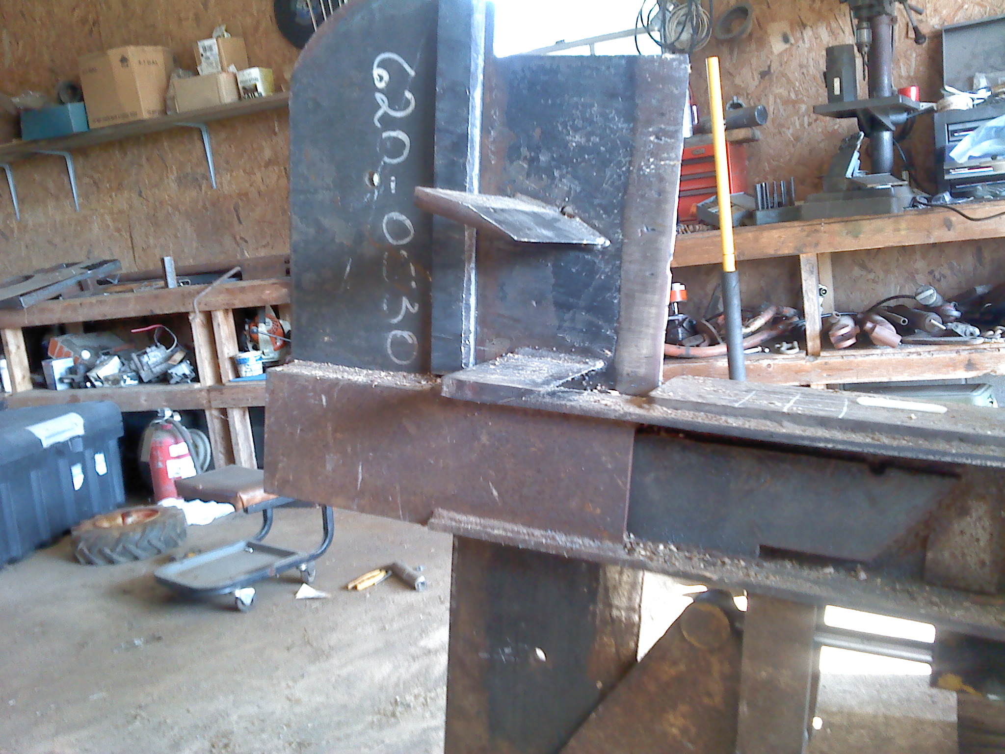

Still have to make some axle stubs but it is good enough to try out for now. I'm very happy with how this turned out. Almost looks like I knew what I was doing
/ Log splitter build #72
Looks very good. Use will tell the truth.
Understand that when you elevate the four way knife you also raise the point of maximum pressure. This translates to tremendous pressure on your I-beam and all your support elements of the knife. Did I mention tremendous pressure?? Success is dependent on the cylinder force being less than the breaking point on the knife. :thumbsup:
/ Log splitter build #73
I really like The looks of the splitter. Only thing I see that I think is questionable is the edges on the wedges. I personally like for the edges to be a little sharper. On 1 in thick plate, I like to sharpen the edges back about 1-1 1/2 inches on each side. If i am only sharpening one side of the blade, I like to taper it back about 2 inches. This give a much sharper knife edge and it helps slice thru those hard knots and crotches that dont like to just bust. I have used my splitter to shear wood that is to long to fit on the beam and you cant do that with a short, blunt knife edge on the cutting blade.

I was just thinking that, I think these need to be sharper. I have aboit a 90 degree included angle and wood seems to be just popping and flying everywhere not even getting into the 4 way. I did stall it out on the 4 way tho and nothing seems to have bent or broken, Its getting dark now I will Sharpen these up in the morning and have another go. Also I am splitting wood that we cut last year, does that make it more prone to popping?
/ Log splitter build #75
By looking at your pile, I think you've started with very easy to split wood. That's a good thing. Try to find the issues before they explode. :)

The top of the wedge is only 3/16 plate so there's only about 3 threads in it so that might have to change eventually but it is holding for now
I think once you get those blades a little sharper, yo will stop having popping pieces flying everywhere and not have as much stalling on the 4way.I think you can see the angle I used on my 6way in this pic
