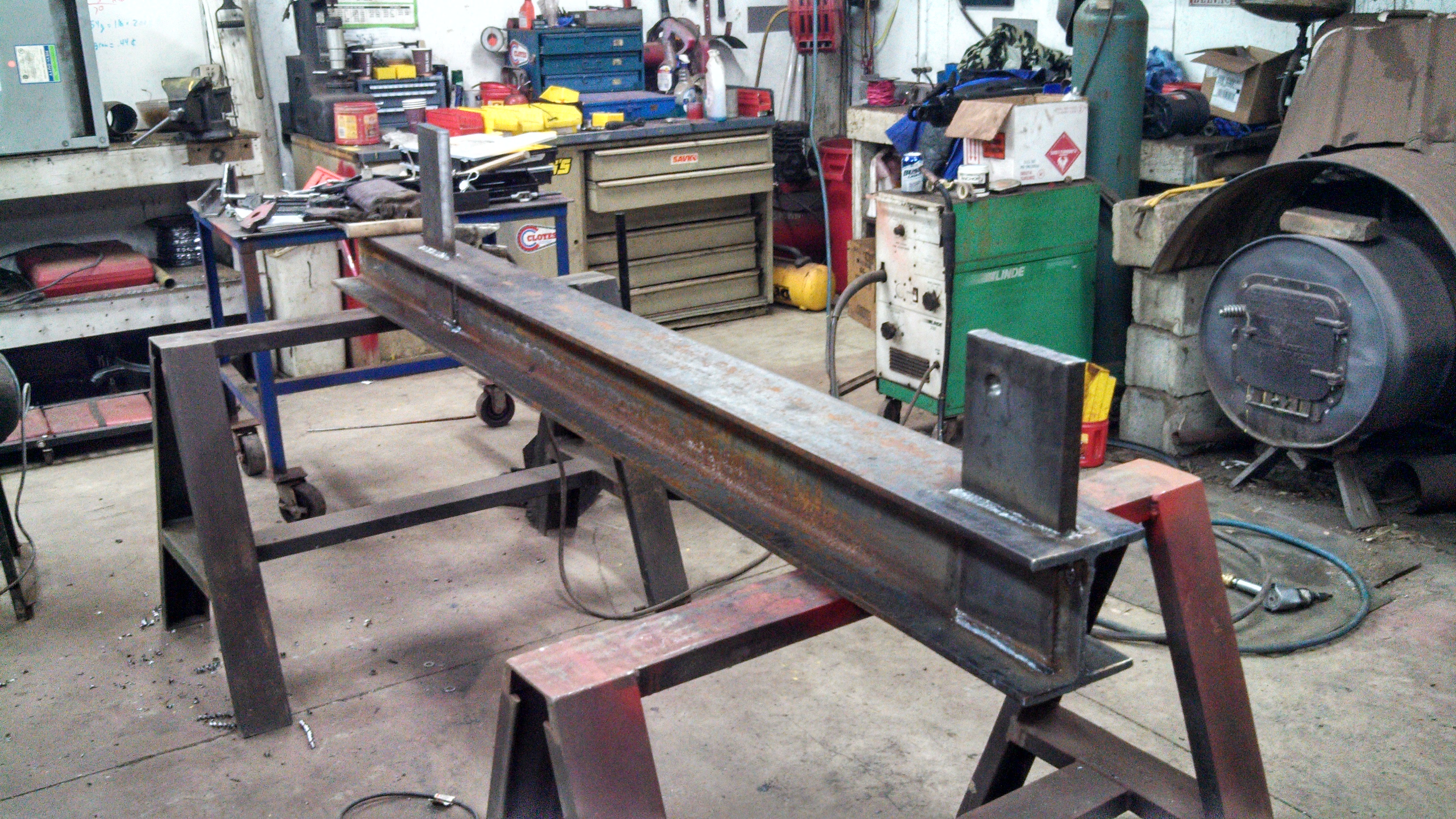

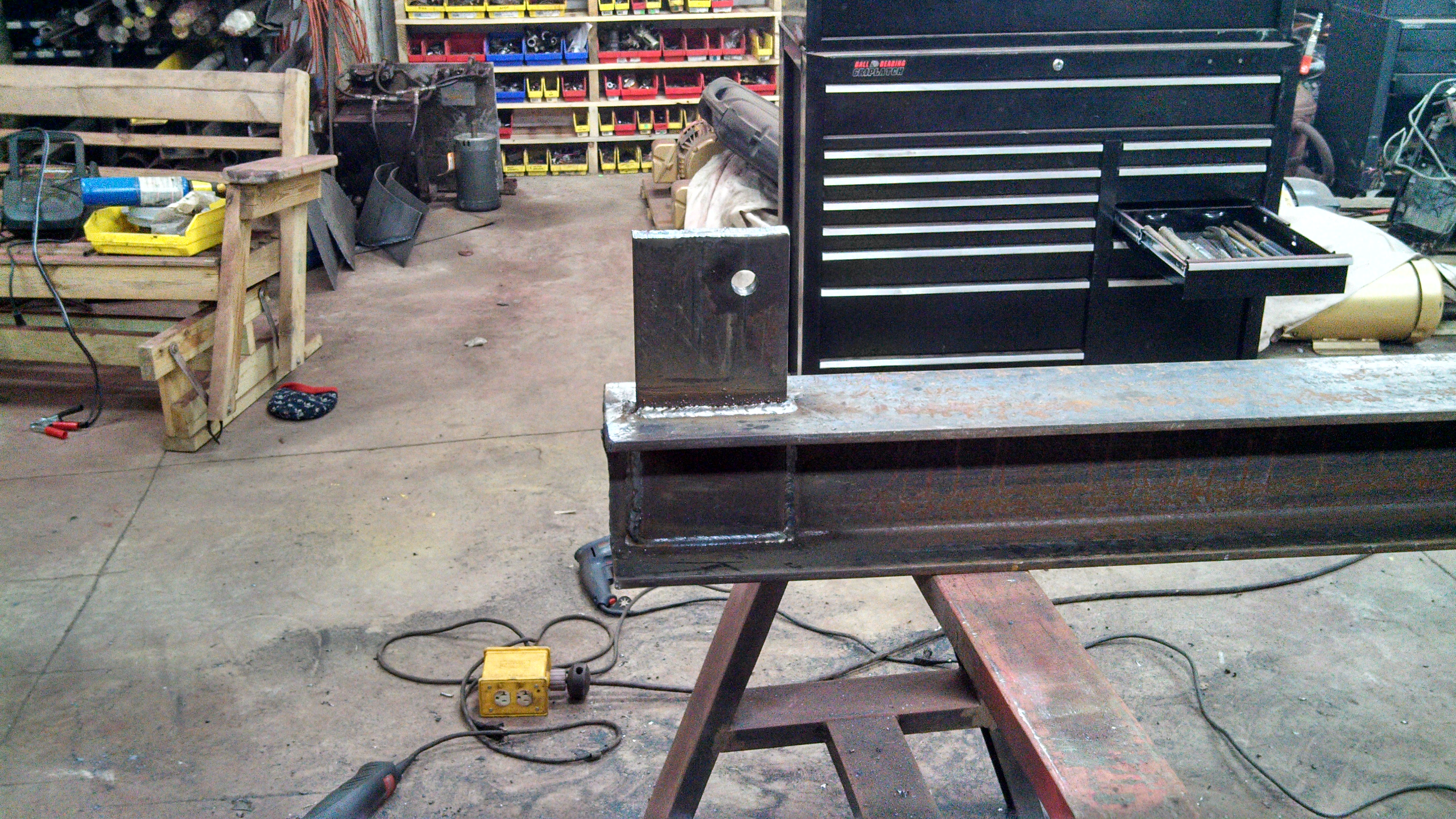

The other splitter has been like that for years, I would like to see the ram that tears out a piece of 1/2 thick I beam, it would have to be well over 50 ton

Well regardless, this splitter is maybe 20 ton so I don't have to worry about that happening. Got my tank axle tacked on, strainer didn't show up today so hopefully Tommorow I get it and I can weld the coupler in for that and then cut the spindles off the other splitter and fit them

Yes you are probably correct. My comment wasn't meant to criticize your design. It all looks well built and looks like it will all handle 20t. Just pointing out the weakest area I saw.....which I am not implying that it isn't strong enough. My preference is I do not like a surface weld like that. Rather I like an anchor block with more weld area tied to other parts of the beam. Same for wedges. Huskee has a good design for anchor blocks, but then again, they don't use a one piece beam either....Rather a welded up beam
/ Log splitter build #27
I have seen many anchor blocks welded to falt surfaces, I have seen a few fail, but not many. Weld quality always plays a big part. Cold surface welds will break every time. Do a little grinding and turn up the heat and it will usually stay.
/ Log splitter build #28
Did you ever mention what size cylinder you would be using?
A potential weak spot I see is the cylinder base anchor/eyelet. Just surface welding to the top of the beam like that. Have seen several splitters rip off a connection like that. Welds were good, it rips out a chunk of beam with it.
It isn't hard for me to imagine that a failure could occur ... after having seen how much flex there is in the beam on my splitter, when it's loaded up to 2000+ psi and trying to work its way through something really tough. And it's only 15-ton ...
My beam (W8 x 28) isn't lightweight ... but it ain't exactly heavy either ...
8x28 is plenty heavy. I believe the op is using a 6x25....same as my splitter
/ Log splitter build #31
How do you think they compare in terms of rigidity ?
I know my flanges are slightly thicker ... but the web is thinner and spans a greater distance ...
/ Log splitter build #32
Web thickness adds little to a beams rigidity. The moment of inertia (usually listed as I4 in a beam spec chart) is a direct indication of its stiffness.
Double the i4, and you double the stiffness. IE: same span, same load, a beam with double the i4 will deflect half as much.
I'll see if I can look up some specs
/ Log splitter build #33
8x28 beam has an i4 of 98. The 6x25 is 53.4.
Also worth noting....that the height of the cylinder mount, and wedge play a big role. That 20t cylinder....not a lot of that force is trying to deflect that beam. The taller the wedge, and taller the cylinder anchor...the more leverage it has to bend a beam, and more leverage it has over the weld.

The possibility of failure of that cylinder support has NOTHING to do with the static strength of the support/beam joint,,,
The failure mode will be fatigue failure.
I built a splitter, and a friend at work nagged me into selling it to him.
Well 3 years later, the buyer managed to push the ENTIRE end off of the splitter (it was a moving wedge design)
The guy was using it as a fund raiser for a church. They were only splitting leftover knots from logging operations.
ALL of the men members were volunteering time to split wood, which they sold.
The guy said almost EVERY stroke was full power, tearing through the knots.
He figured they split at least 300 cords like this,, free wood was free wood.
The reason I heard about it was he asked if the repairs were covered under warranty!!:laughing:
Repeated cycling can break anything,,, usually a weld joint will fail first,, the material is a different hardness.
