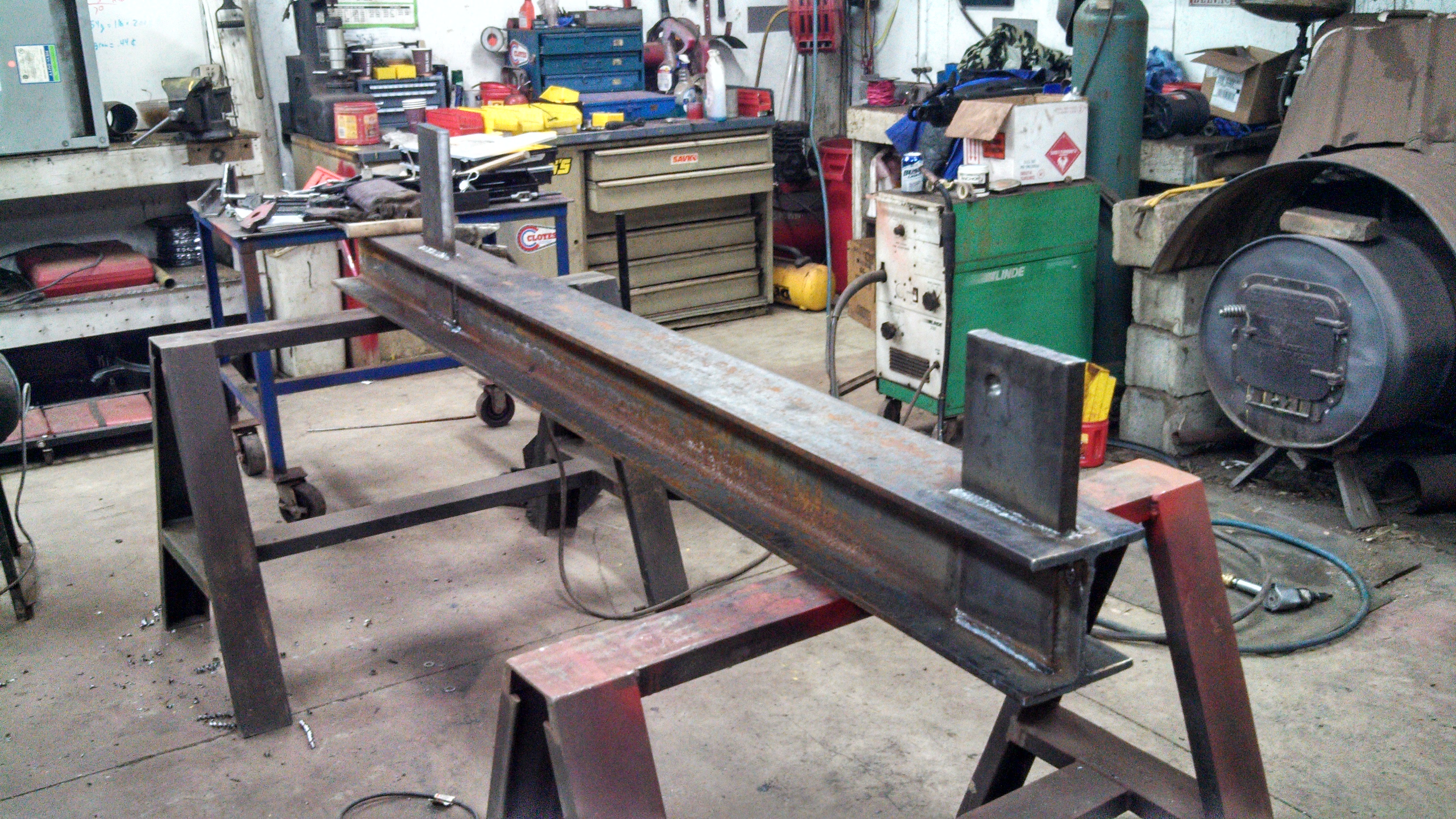

#58
Welded the end plates on the rear of the beam and thr receiver underneath, made a stand and added some hose clamps underneath

I was thinking a log lift would be handy as a table either way. Now that the tongue is on and it has some weight I'm going to try and cheat the hubs forward, as of right now I have 14" from the cutting edge to the tire
