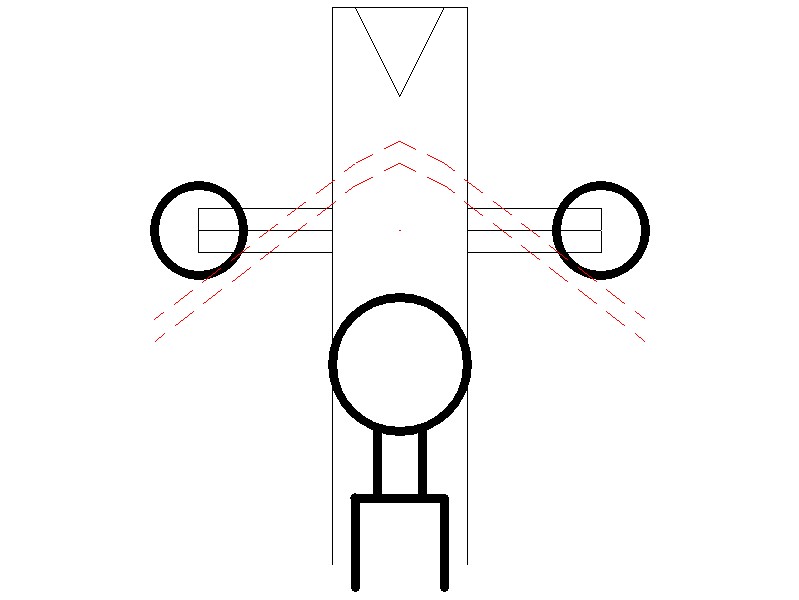

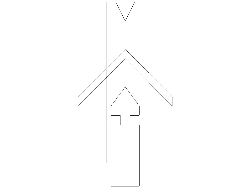

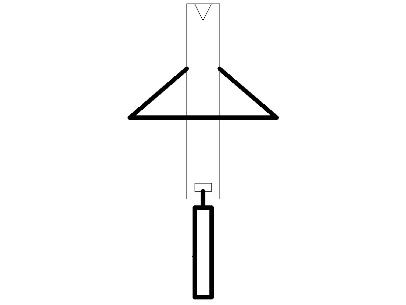

This is my feeble attempt to show a log splitter being used as a pipe bender, a tire bead popper, and an angle bender looking down on the log splitter. There is a third one, very faint.
