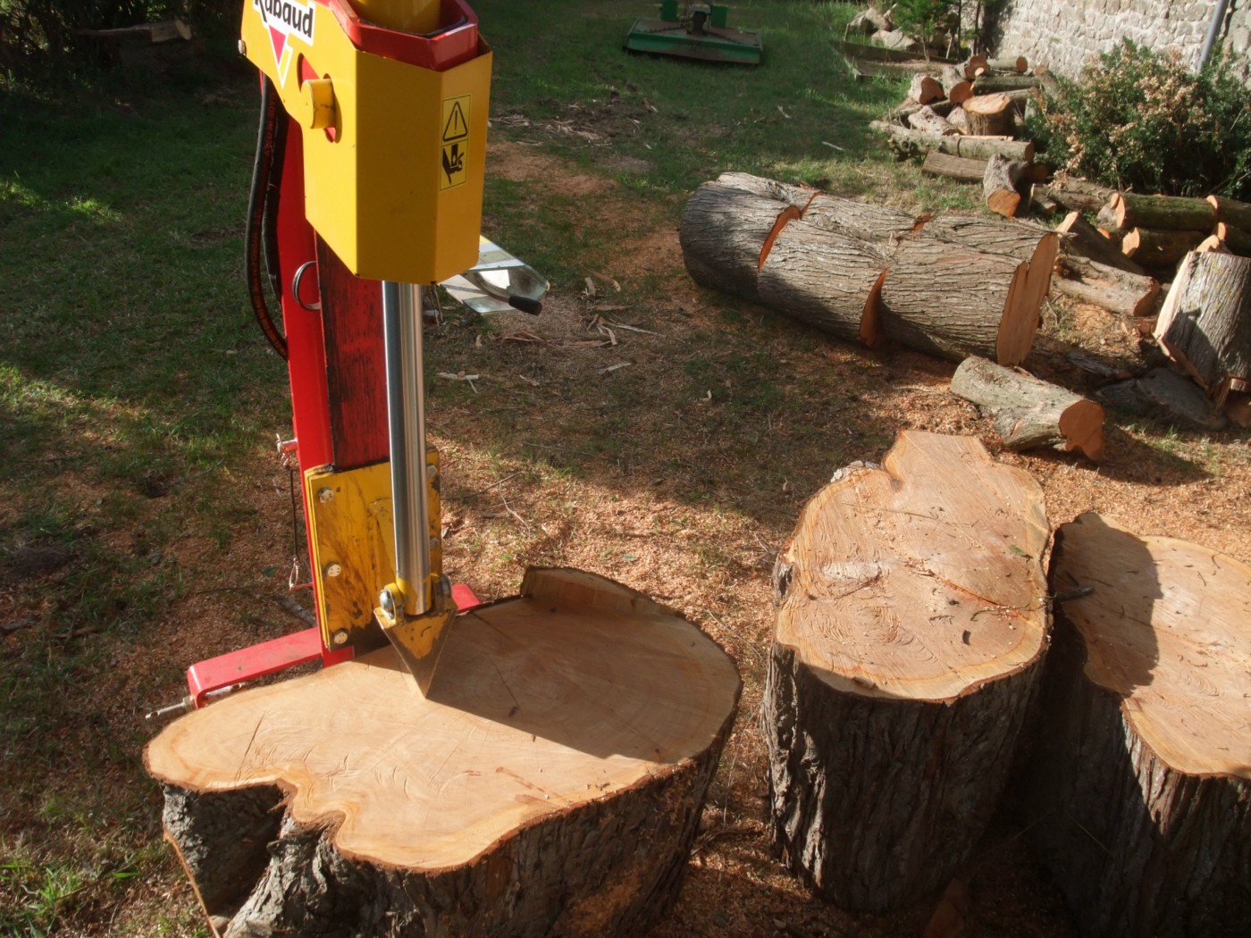

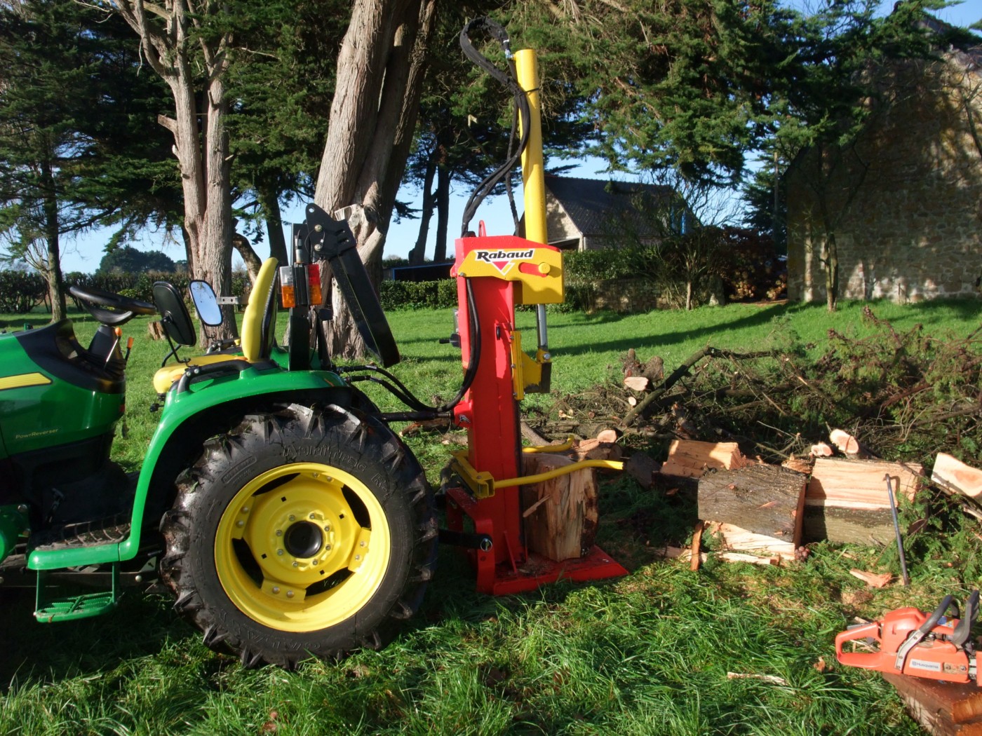

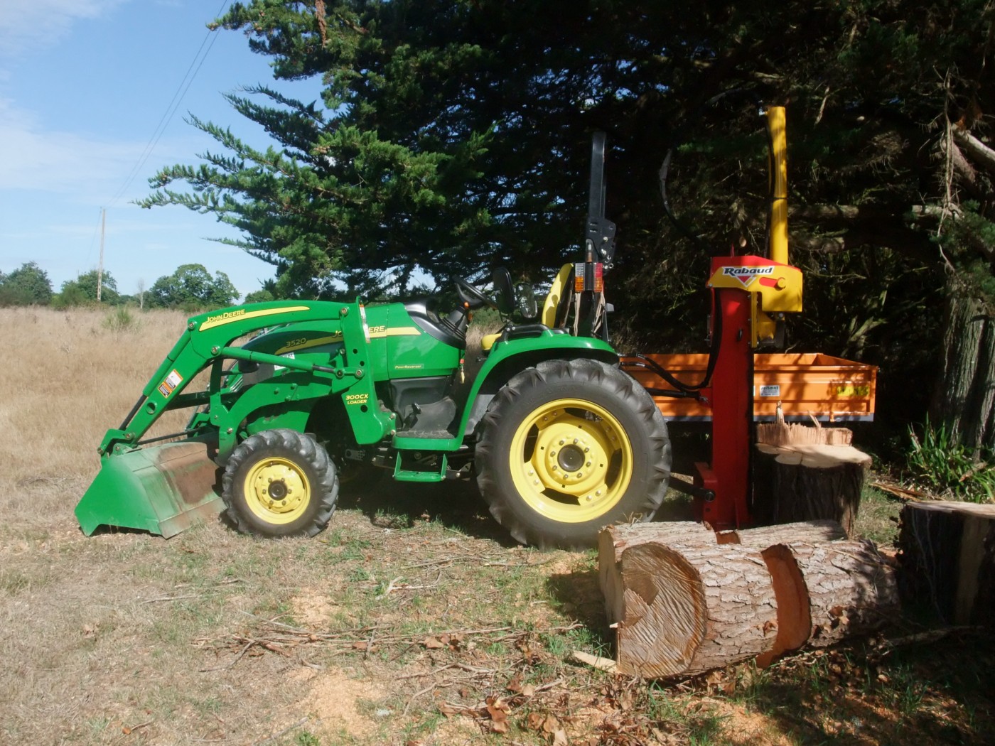

I bought a 3 pt hitch log splitter for my 4200 JD. this season and really love it. While splitting some fire wood I got to thinking, "I do that sometimes", how bout making a cider press to work off this thing. I have many apple trees and I really like cider so I just might build something this year. A log splitter has to have more than just one use, as you have shown us here. Any other ideas out there?

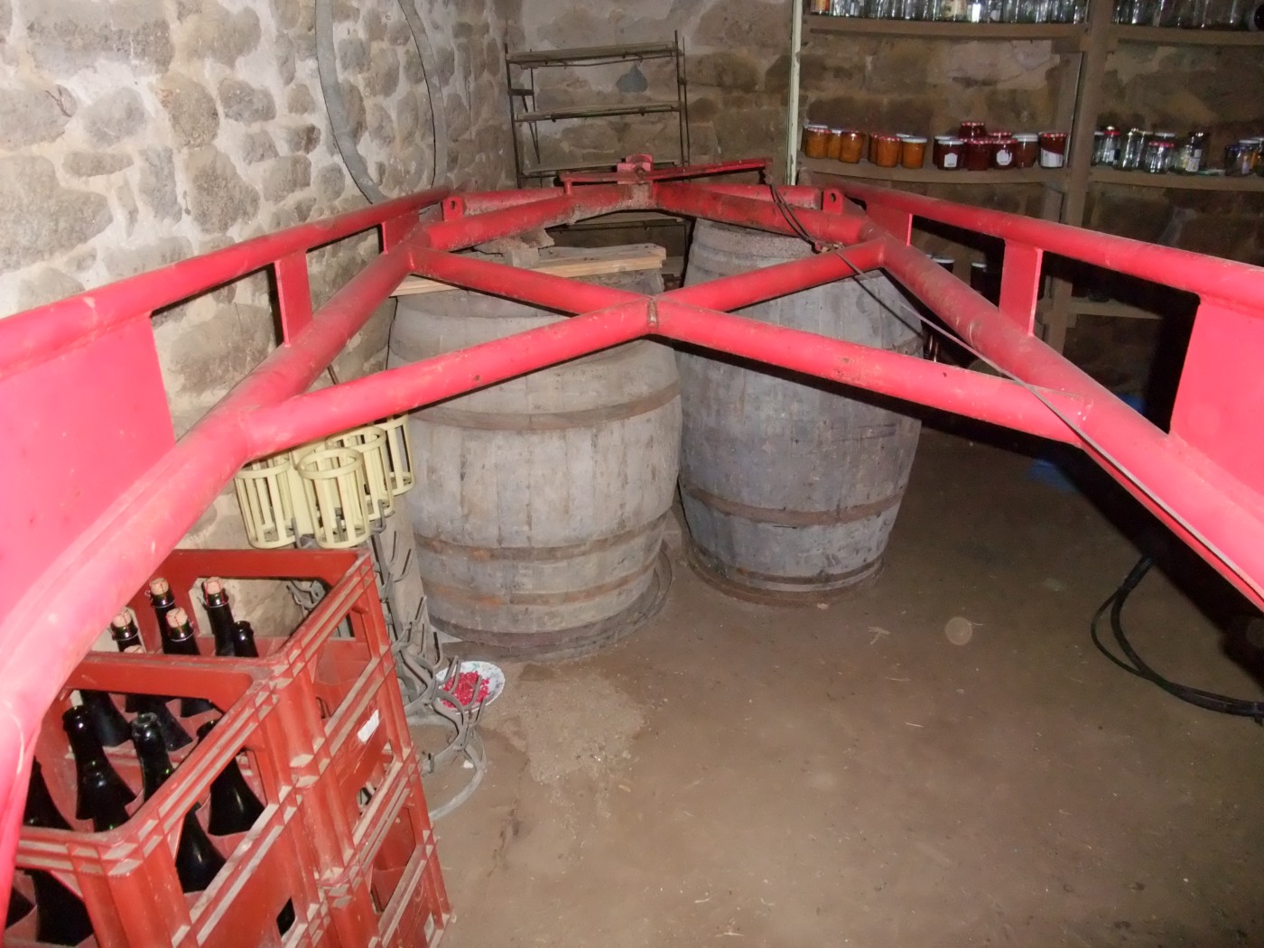

That's a great idea. I love cider (1st pic) and have a lot of the right kind of apples. My splitter is a vertical splitter, shouldn't be too difficult to adapt. Would be extremely interested if someone developped the idea.

Yep. My splitter is on the 3pt hitch of my 4200 JD. It will swivel horizontal or vertical. I'm thinking the vertical will work best for a cider press. I may have to park the tractor on something higher so the cider can run out the bottom of the press into the jugs. I used to have a hand crank type press, so I have an idea how to go about this project. When I come up with an idea, I will post in in here.

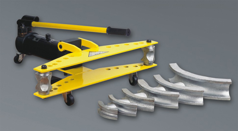

This is the idea that I have. Mount the bending roller assembly on the frame and use the splitter cyl to bend tubing, flat stock, bar, etc

Jake 98,
The Pipe Bender is a great idea.
All you need are some used dies and your got it!
Thks
J_J, thks for starting this one !

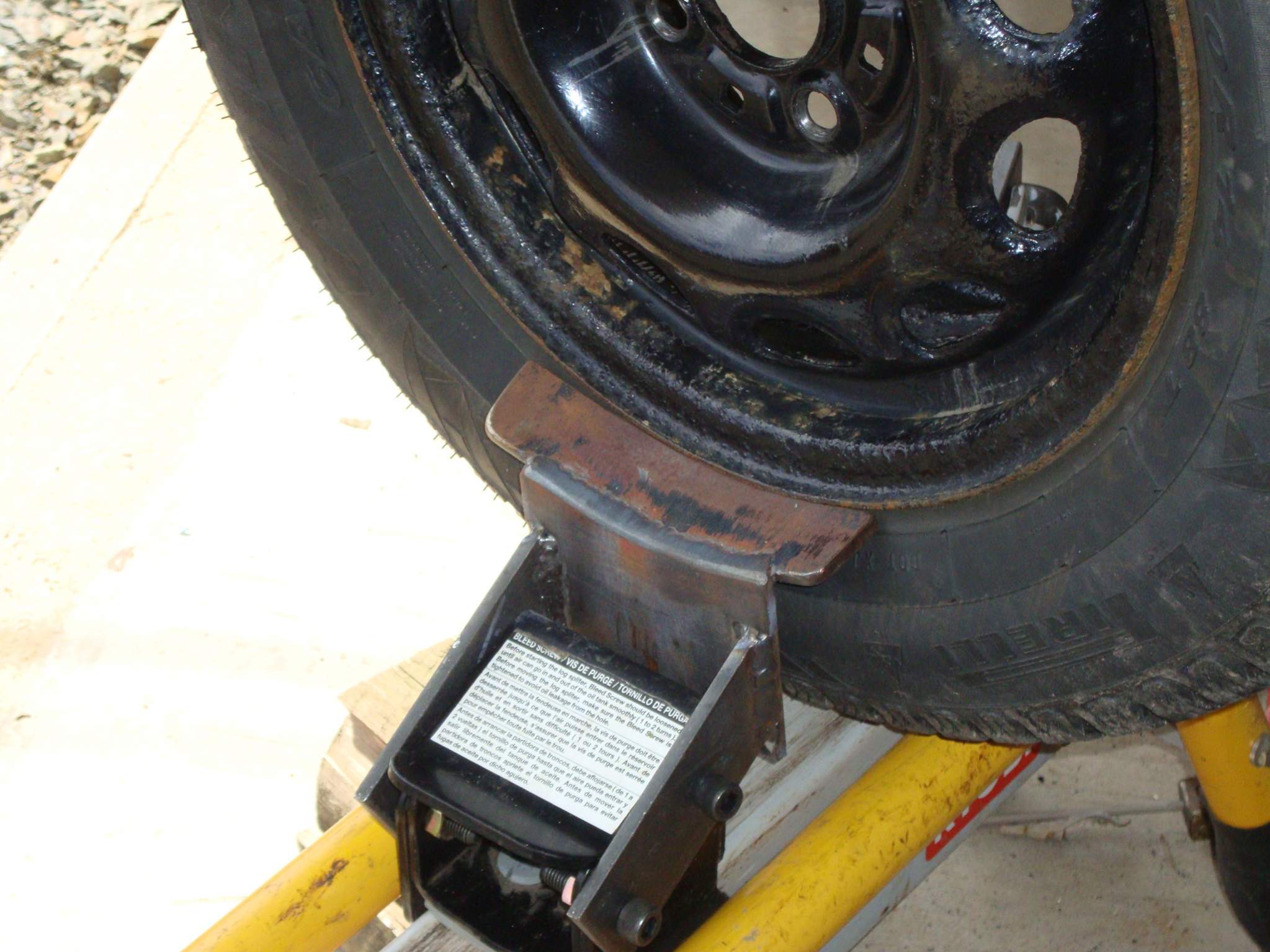

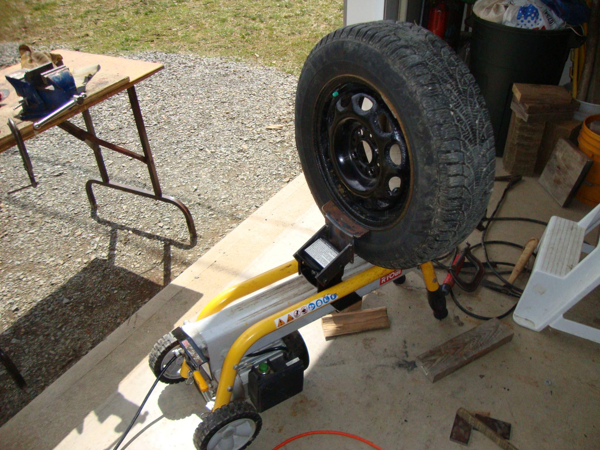

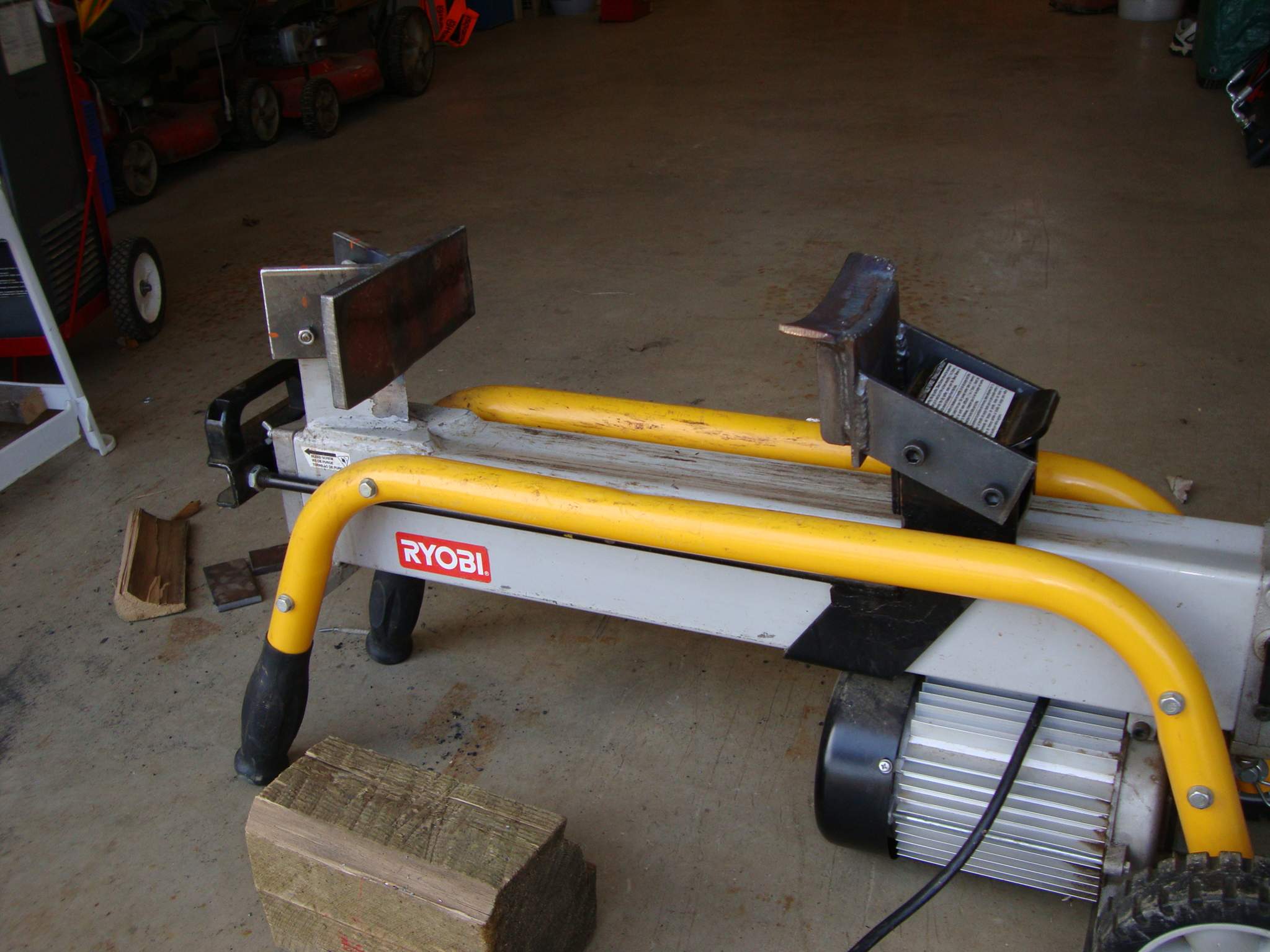

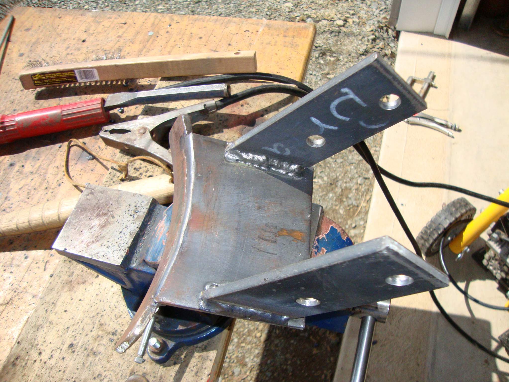

I finally got around to building the tire bead breaker today. Now all I need is a tire that needs to be broken down to try it on..;)
Sean

Chilly807,
Nice work.
Is the bead popper adj for all type tires, like large fat ATV tires, and smaller lawn tires?

Chilly807,
Nice work.
Well, I built it to fit 14-16 inch car tires, so it should handle anything close to that size. The radius is exactly right for 15 inch rims, trial and error will show how good it is for other sizes. There's 6 inches of clearance between the popper and the bed of the splitter.
