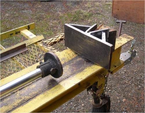

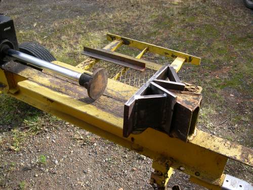

Thought some of you might be interested in this setup. Make an adapter to use you splitter as a press.

Yup, heard about it before, great idea and you show some good starters tooling.

That's what's needed, all specific tools, dies etc. I'm surprised Northern Tool has cornered the market yet. Seems like something you would see in their pages.
The depth of the work is limited due to the beam though. Probably why it hasn't really caught on.
Pipe, bar, tubing like jake mentioned should be ideal with the right dies.
Wonder if they would work to shear steel like those iron worker machines.
JB.

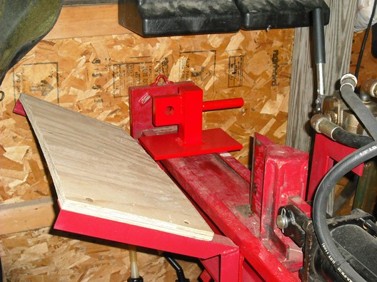

I have the same setup. Could you post a picture of the press piece? How thick is the material?
Thanks.

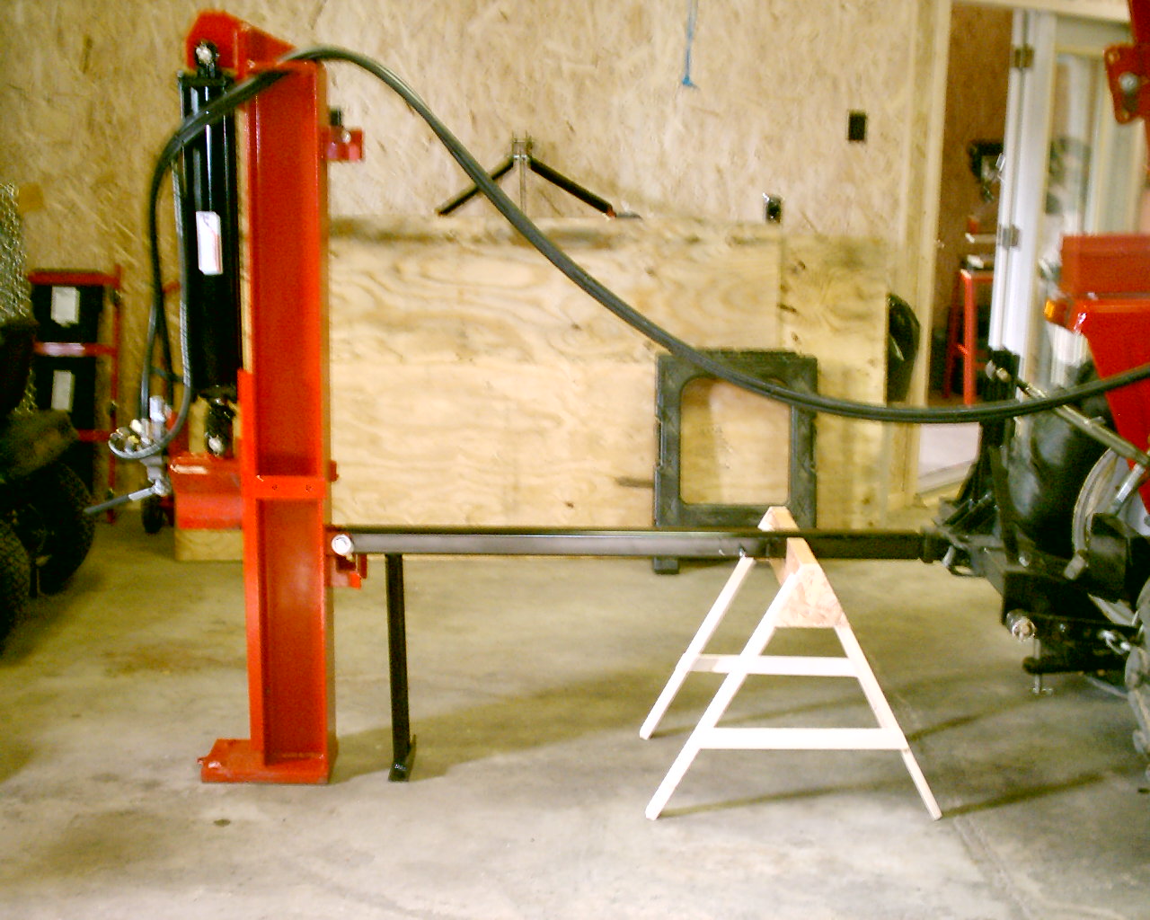

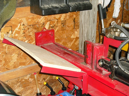

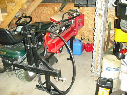

I built this splitter a few years ago. Could not find what I wanted on the market. Anyway, here are the pics. You can see it with the later built press adapter sitting on it. Total cost was $450
The press adapter is a 1/2" plate for the bottom, a solid 2x2 for the upright, and a piece of 1" round for the press part.
Chris
Chris
Thanks for the quick reply and pictures. Need to find a place to buy small pieces of plate.
J.J., thanks for posting your solution.

No, that is not my splitter. If I were to use mine as a press, I would just use the end that is on the cyl rod. A large flat surface. The sliding block of metal is connected to the beam. Very little chance of bending. The shaft in the picture, could perhaps bend.
