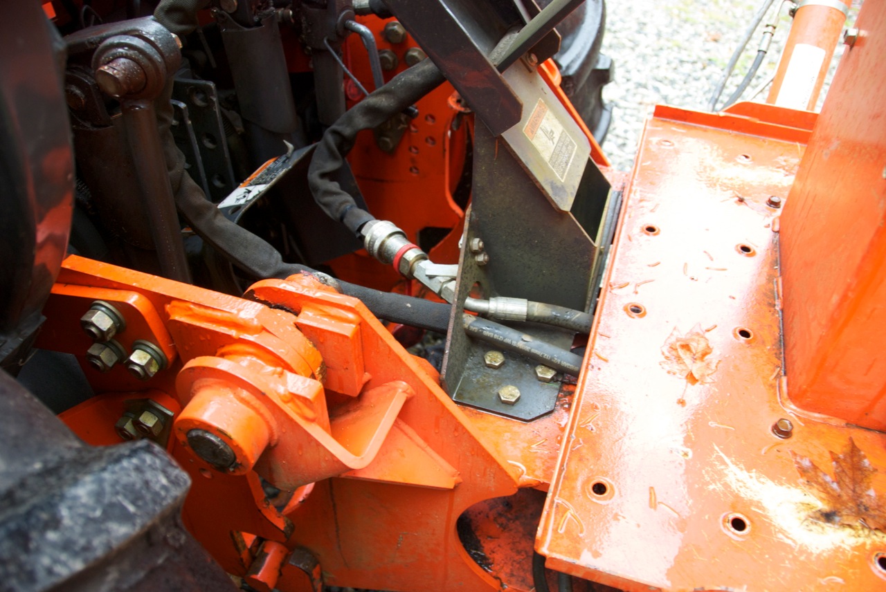

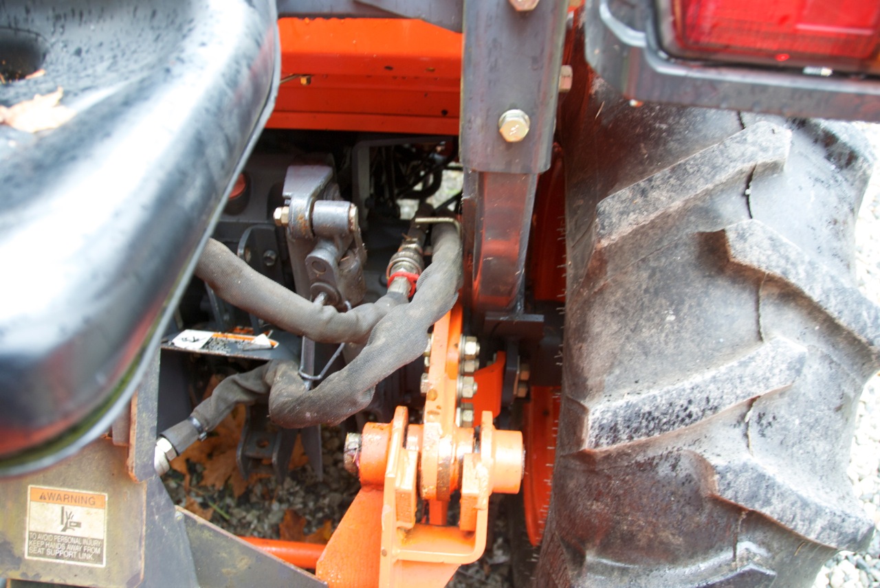

So your BH does not have a PB port?
Please show pictures of the OUT port of the BH valve.

inveresk,
Is your 3pt valve the last valve in the hyd path with the splitter installed.?
I believe so but can't be sure.
Is the OUT on the splitter going to the 3pt valve?
I believe it bypasses the 3pt valve.
If using no attachments, do you couple the two rear hoses together?
Yes.
No.
Here are those shots.
   / Log Splitter and Backhoe Question #15
The first two answers conflict each other.
Let me ask it this way. Does the OUT fluid of the log splitter valve go to tank?
If so, you have no 3pt utilization.
Once you remove the log splitter and connect the two hoses together, then you have 3pt operation.
Correct me if I am wrong.
   / Log Splitter and Backhoe Question #16
Three point hitch works fine with log splitter attached. It is not disabled. Once I disconnect the bh or log splitter, I reconnect the hoses to complete the loop. Hope this clarifies.
