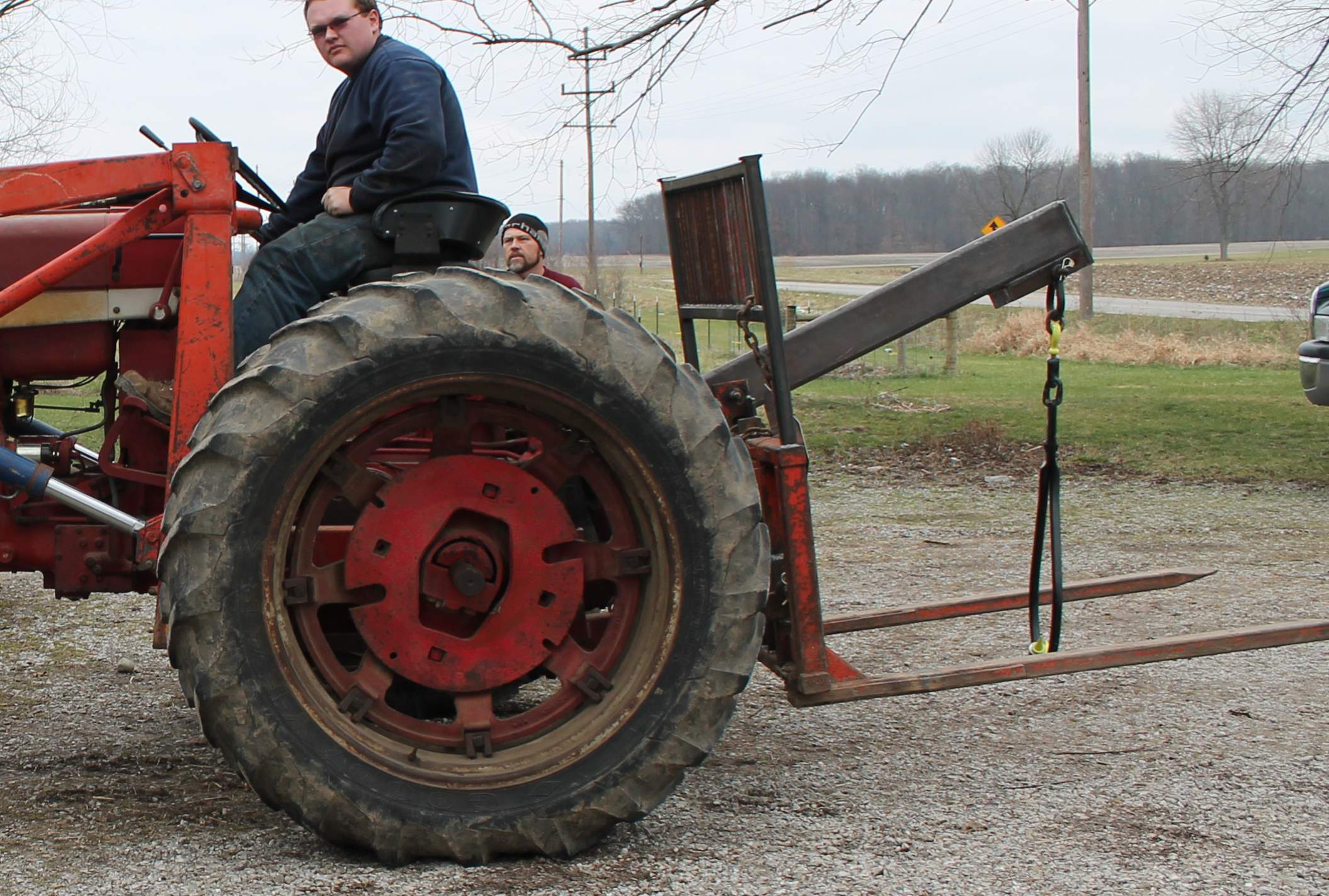

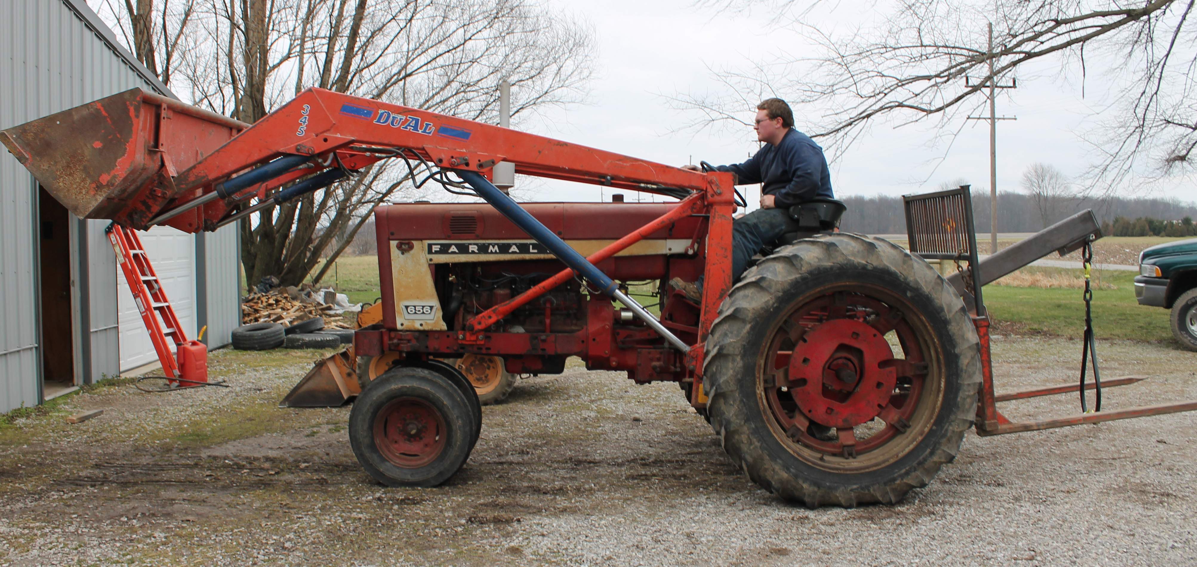

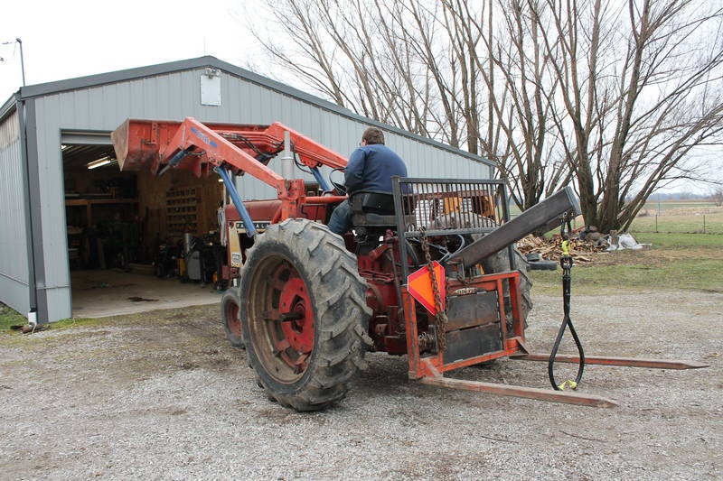

She's an ugly beast, but works great minus the wide front we need to add. The bale carrier was converted to skidder attachment that I welded up. My son has skidded 24" x 60' whole oak trees. We added the loader yesterday. Should keep him from lifting the front end up as bad. He had 400 lbs. of weight on the front for counterbalance before the loader. He still was bringing the front up on some trees. Good old equipment!:thumbsup:

Chinese stuff! So far they have held up. We skidded around 40 trees with them. USA made tongs were $250. I hate buying foreign, but $80 was a no brainier. They make replacement inserts for the spikes, probably need to get a set for future repairs!

Just wondering if those bale forks are intended to prevent backflips or ?? Several years ago friend did that skidding with his 8N and luckily only broke his leg. Another guy a few miles away did the same but wasn't as lucky.

If you don't raise the log up very high from the ground it's really stable. Just need to keep your hand on the 3 point lever to drop her quick, if you think your in trouble.

It's just a 3 point bale attachment modified with a piece of 2x6x3/8 walled tubing made as a top link. It's easy to hook up. We skidded out another 15 trees today, the loader made a big difference on stability. We have a wide front we are rebuilding to replace the narrow front.

We have been using the tongs to lift the log enough to hook a chain around it. Our tongs aren't the best you could buy. The trees that are larger than 20" across are hard on the tongs , if you are pulling through heavy brush. I welded 1/2 plate spaced to hook chains in. We run the chain through the clevis on the end of the lift arm to the log. Works really well on the larger trees. The forks of the carrier are in the way since we added the lift arm. I may end up making them shorter.

The tubing is 5' long. I welded a heavy duty nut and threaded part of a top link end into the tubing. Then reinforced it with 1/2" plate. The assembly is adjustable like a regular top link. If you need any pics let me know.

The old fords were noted for being light in the front. We used one for a few years back in the 80's that thing loved comming off the ground. Pulled pretty decent but we had to really watch what we were doing.

Just thought at some point adjustment may be necessary. If you want the forks to be adjustable as far as tilting up or down, you would need the top link adjustable.
