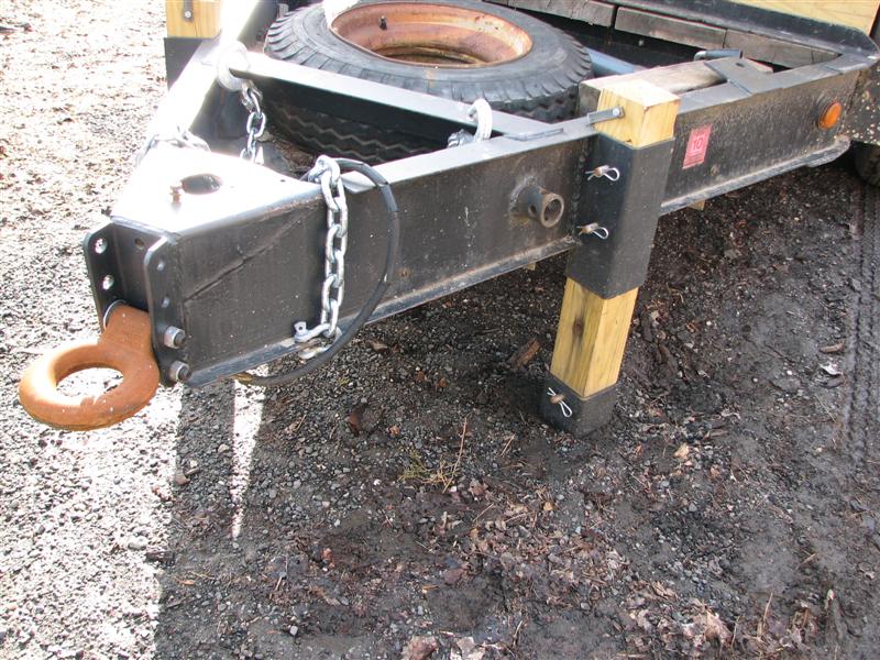

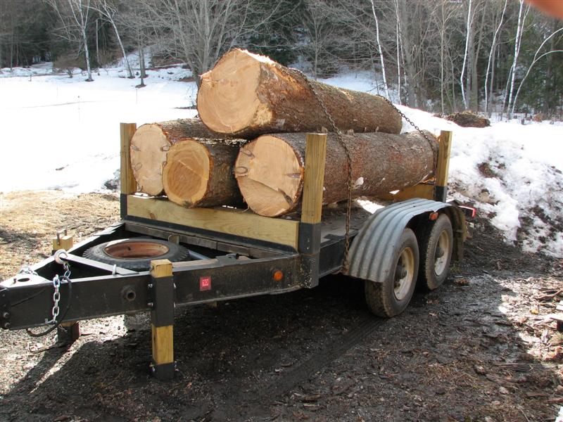

My solution to the braking problem is some "stakes" I carry to hold the tongue up when I'm loading logs. The stakes are 4x4 pressure treated pine with steel caps on the bottom (so they don't split, or wear too much). I can set how high they sit in the sleeves on the triangle.
I pull the trailer with a clevis hitch on the back of my winch. So, if the diesel won't hold the load back, I can lower the 3-point and let the stakes dig into the ground. My hills aren't too steep but are in a few places. That's the best thing about a diesel tractor in my opinion- hill braking.
I've never had to drop the tongue, and really aren't sure it would work, but assume it will help. I know the winch can ride up, but the trailer is loaded biased toward the front so the tongue is pretty heavy.
