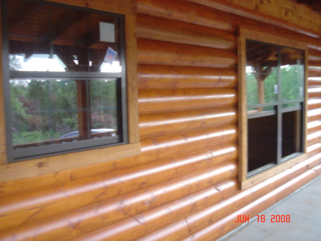

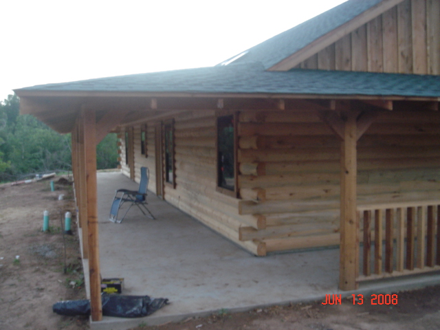

I kinda disagree with this and with others who mention extensive maintenance. The maintenance on my cabin is less than on my Hardiplank house which needs power washing at least yearly. Trim has to be painted every 4-5 years. The cabin, on the other hand, has needed next to nothing. We've touched up the window trim once in five years. And believe me, I know every inch of this structure and there is nothing about the logs that is time consuming or extensive compared to anything except maybe brick.
There are lots of reasons to prefer one type of house verses another, and I personally think brick is the best, but for me, logs are a close second. And I've lived in brick, vinyl, wood, masonite and Hardi-plank. I seriously considered stick built for my cabin. It probably would have been easier and maybe cost less. But I'm thrilled with my logs and so far they have required less care than anything else I've ever lived in.
And there is no rot. No mildew. And, my logs have not settled appreciably. They do check, which is normal. And I'm sure they change a bit with the humidity. But no measurable settling. I chalk that up to kiln dried logs fastened with Oly-logs. (I'm sure the whole house settled some, but I can't see any evidence of it.)

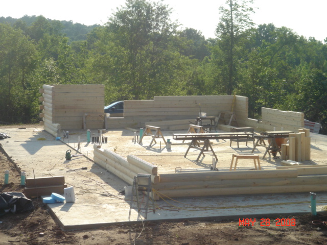

Once again i agree with you N80. And I also do next to no maintenance on my log home. I stained it 3yrs ago for only the second time.
I also have very little, if any settling. But like N80 I spent the extra bucks for kiln dried logs and they are fastened together with Olylag screws.
I have a family friend that bought the "Air dried" logs and he has had substantial settling issues and even had his cabinets fall off the wall because of the logs shrinking. He has also had doors that are very hard to open etc...

G, go see the logs & talk to the guy. The logs for my first home came from a guy (Aaron Zedlitz/Tyler Tx) who built his own hydraulic mill from scratch. he also cut & skidded his own logs getting free beetle killed trees from the local timber companies. The guy was a wellspring of information & gave me the confidence to build my own house. If you don't like what you see or hear...walk away.
800 mile trip? What a great excuse get away!

Now that you mention it. We have those adds running in the locals out here in Arizona too. Seems, I remember that they had an 800 number. Almost the same wording.
The homes I have built are "scribe and cope". I would be real leary of the ones with the milled channels in the top of the logs like Eddie posted the pictures of.

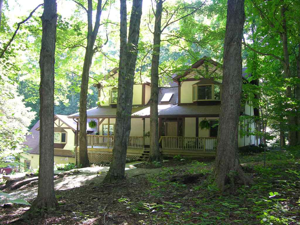

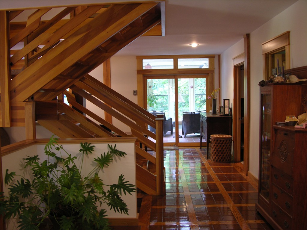

I have really enjoyed building our Timber frame home, but I'm glad to say we are selling it and close on Friday. We are building an all concrete home with massive amounts of insulation.

It sounds like you've jumped into a thread without reading it. My logs, as are many, were kiln dried. I've had no shrinkage at all. I recently inspected my cabin based on this thread. Five years old, in an area with high humidity and wide humidity extremes. No visible or measurable shrinkage. All doors and windows work the way they did when I installed them.
In fact, my cabin exhibits FAR LESS dimensional change than my stick built home. Far less.
It takes a mighty large overhang, Full porches all the way around, to keep driving rain off the walls.
That is true of any home. Obviously.

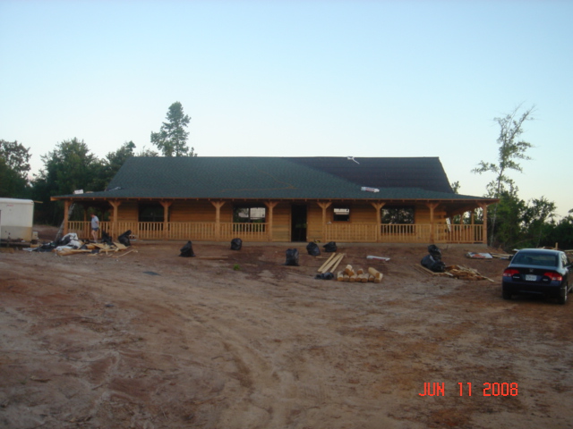

But even when all of this is said and done. The OP is talking about a WEEKEND CABIN!
