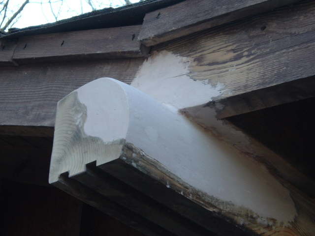

I'm not putting down log homes. They are awesome. I just like to caution those who are building them that there are some very serious issues with maintenance that must be done. Here in my area, rot is a huge issue. The log home companies and builders tend to gloss over these things and then years down the road, the homeowner discovers some very fatal flaws to the home.
Selling a log home in my area is also very dificult. Most home buyers get a home inspector and they find all sorts of issues. I'm called to give a bid on what it will cost to repair and then never hear from them again. They don't want the headache.

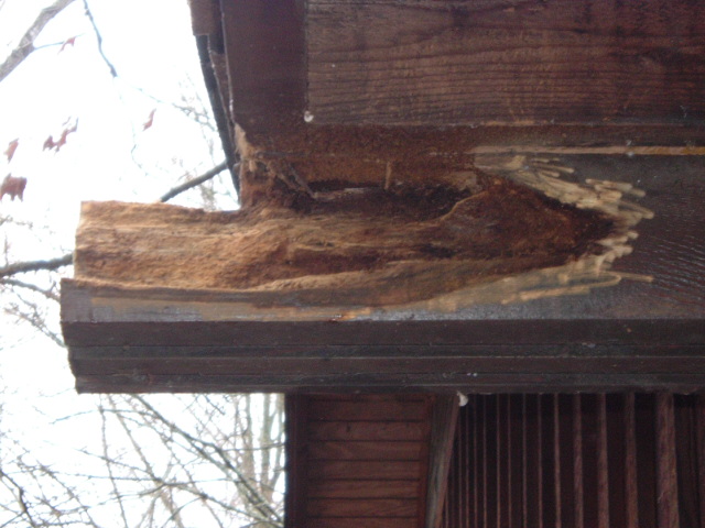

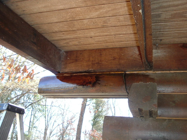

Satterwhite is the only log home that I've evern worked on. They really have the market cornered here without any real compition. I've been to their place North of Longview a few times, and they are very helpful if they think you are buying, but terrible if you are looking for informtion on repairing their homes.
The biggest problem and the first place that I look is those logs that stick out the ends. On several homes, they have a roof that changes pitch for the porch. These are not wrap around porchs, as I don't remember seeing one of those on a log home. The water comes off the roof at that transistion and soaks the logs. Due to the humidity and moisture that we have here, the logs really have to be sealed up better then they are. I've done it with bondo, and I've done it with silicone along the wood ridges at top so water will shed off of the logs.
Another area is at the base of the building. The bottom row of logs. If you don not have gutters, then water coming off of the roof will splash back up onto the logs. Again, this takes time to hapen, but I've had to patch and replace a few logs because of this.
I haven't seen termite damage, but won't say it's not there. Just not something that I've dealt with. I really don't do much work on log homes, it's just something that's come up from time to time, and it's always the same thing.
If you pay attention to it and do a realy good inspection after it rains, you should have an idea of where your problem spots are. There is no such thing as the perfect house, every house built either has problems, or will have them. Log homes just have some specific ones that more traditional, stick built homes, don't have.

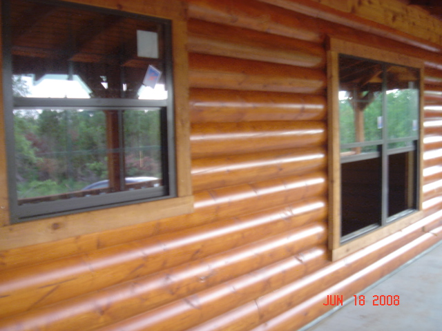

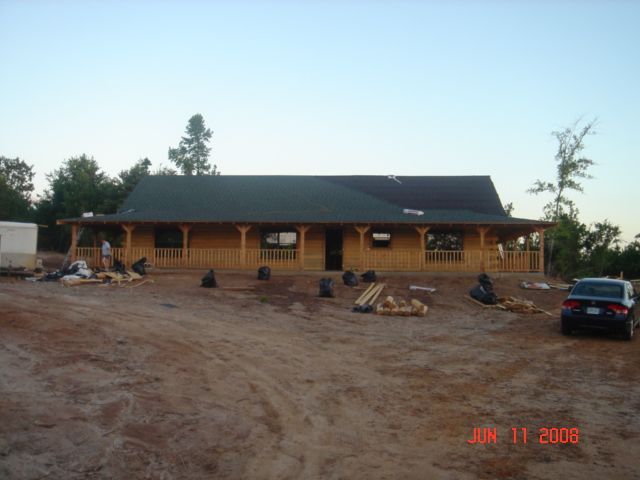

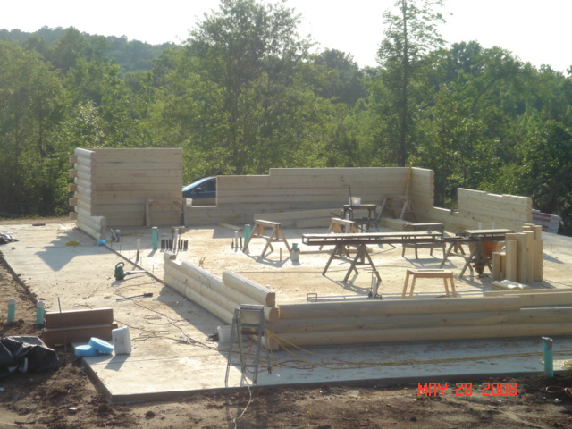

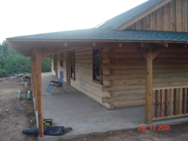

A crew of 4 from Satterwhite had mine dried in in just 14 total days.
All logs, roof decking (minus shingles) porches, windows, exterior doors, and stud walls were completed in this time frame. Shingles were added 3 days later.

MPrewitt, that is a fine looking house. And hey, I had mine dried in in 5 months!

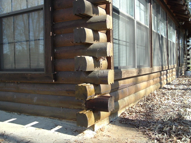

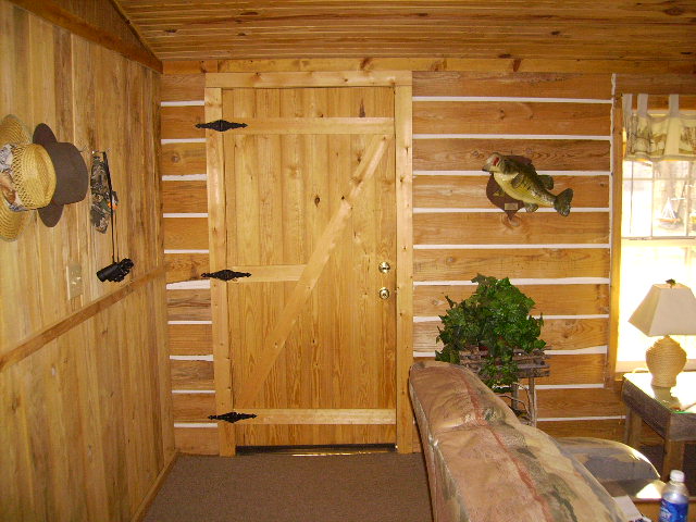

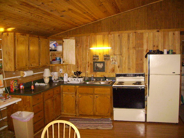

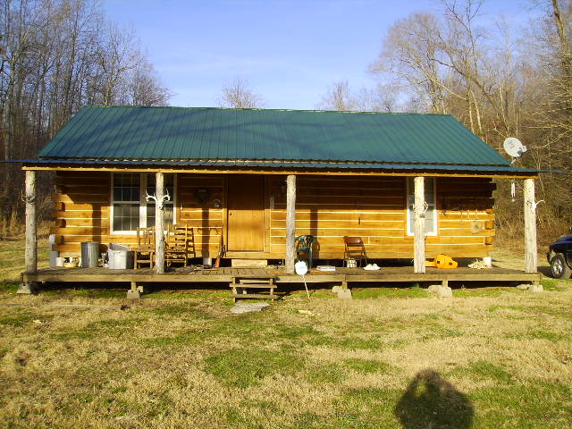

Here are a few pics of mine. Nothing to look at, but like a momma with an ugly baby...it still looks pretty to me. I think the interior looks alright. Everything in it, including the stove, fridge and all the furniture was stuff people were giving or throwing away. Of course my garage and attic looked like a yard sale until the cabin was done....we'd been hoarding stuff for years.
By the way, how do you guys post your photos as clickable thumbnails?
