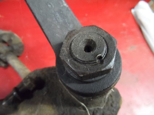

I can't think of another thread that has rambled as much as this one. It's great! Does anyone else remember "staking" threads? It used to be seen as an instruction on engineering drawings. You would strike a gash in the exposed threads with a chisel. It would not vibrate loose but you could still remove the nut with a wrench.
Or stake it with a center punch:
