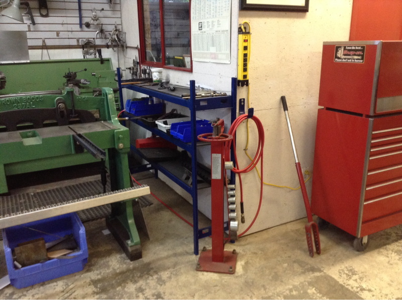

I mounted mine on an "outside" corner of my office in my shop. It is secured to the floor with 5/8" concrete anchors. The stomp shear can be moved out of the way with a pallet jack when I am bending longer pieces. image-819619165.jpg Terry

I mounted mine on an "outside" corner of my office in my shop. It is secured to the floor with 5/8" concrete anchors. The stomp shear can be moved out of the way with a pallet jack when I am bending longer pieces. View attachment 388127 Terry
Thank you BB for posting that pic! That is exactly the situation I was thinking with it being on an outside corner and I have a cabinet on rollers that I could move if necessary.:drink:

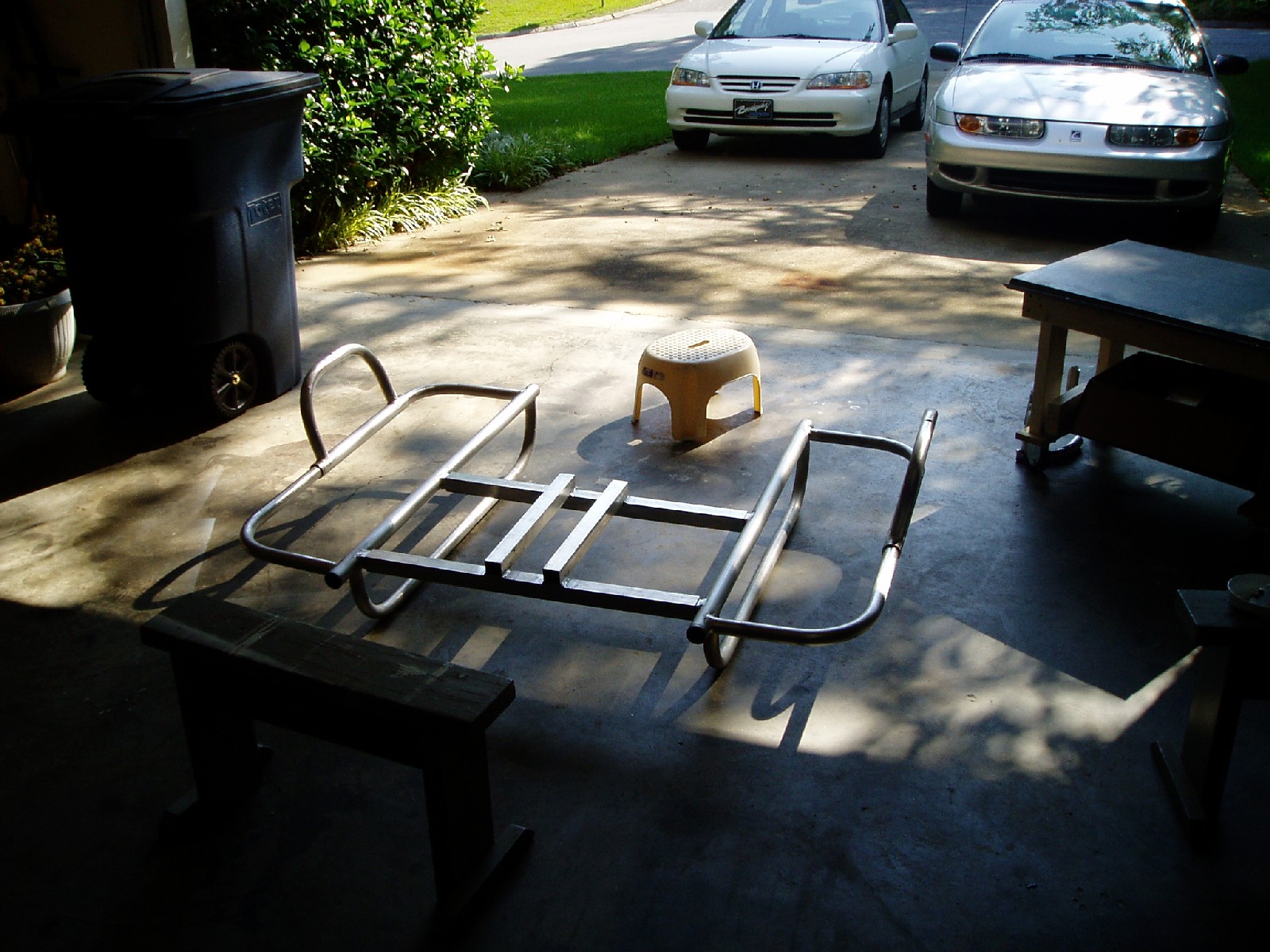

Well, I thought it only just... to post a pic of my first scroll. Was pretty easy actually. The little idea/pattern book that comes with... is handy for set up for different scrolls and sizes. I used the optional scroll attachment. Time to make some planter pot stands for the better half!

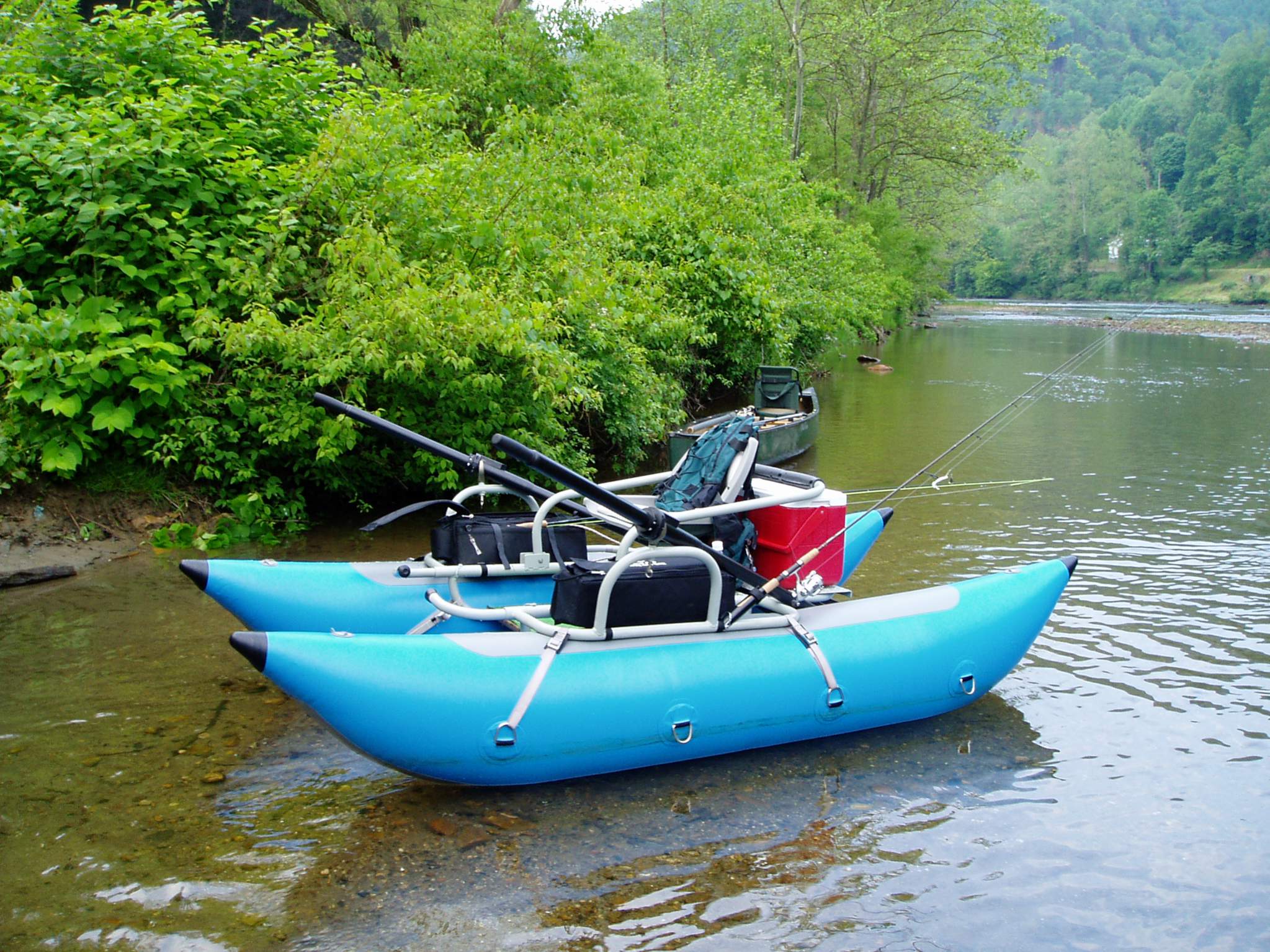

I bent a lot of 1" EMT and discovered I sometimes needed to reposition the work and block my base up due to the length and location of the bends. A rigid base would not have been useful then. I finally just made a good heavy wood workbench with enough of a lip that I could C-clamp my Harbor Freight bender to it on the corners and get to bending. Don't fence yourself in. When thru I just removed the C-clamps and set the bender and its assorted pieces on a shelf in table and had a clear 36" square tall work table to use for other projects in the meantime. I'd take a pic but I don't have any of it anymore.
