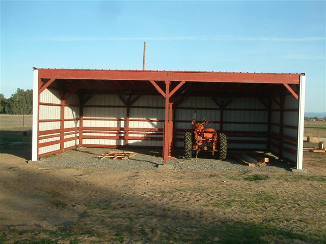

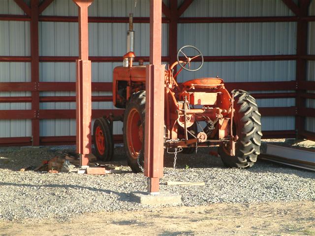

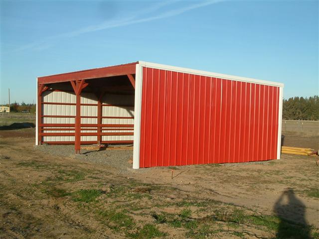

/ Loafing Shed #4
I am in the process of getting ready to build a 12' x 24' pole style loafing shed for some cattle and I was wondering if I should use 4x4 or 6x6 for the posts. It will have a 10' eave in the front and slope to a 8' eave in the back. Just wondering if anybody has any opinion on which to use?
I used 4x6 PT posts for my 20x28 ft equipment shed, which is pretty much like a loafing shed. Used 18"x18"x18" footings and Simpson post bases to set these posts. My shed is 10 ft high sloping to 9 ft.
