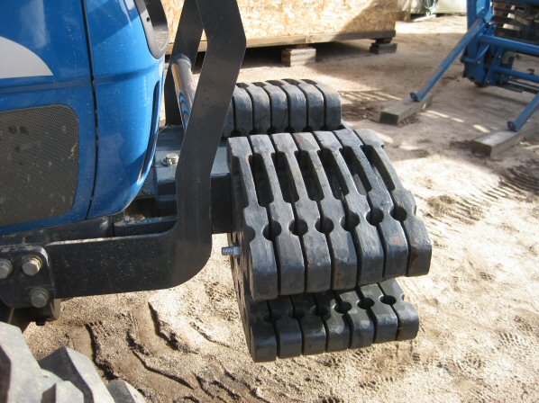

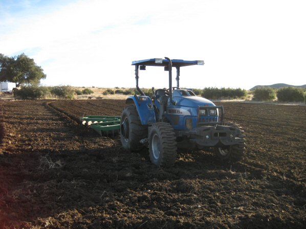

I would load all 4. It helps support the weight when the loader is used at it's max capacity. Really cuts down on the tire bulge. If you are one of the few that removes your loader as I do when doing field work, it is really nice to have all the weight that you can get. I even doubled up on my front end weights. Having the additional weight up front has made a HUGE difference with how well the tractor does out in the field. ;)
