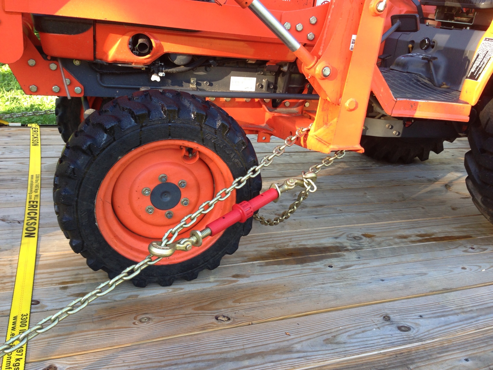

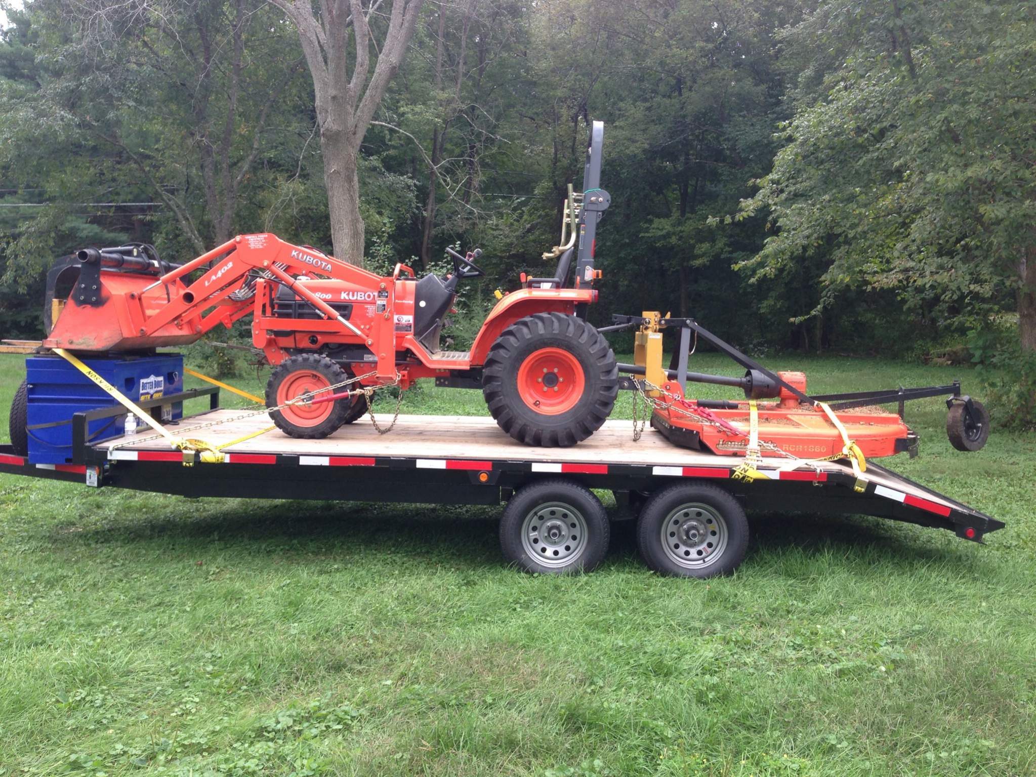

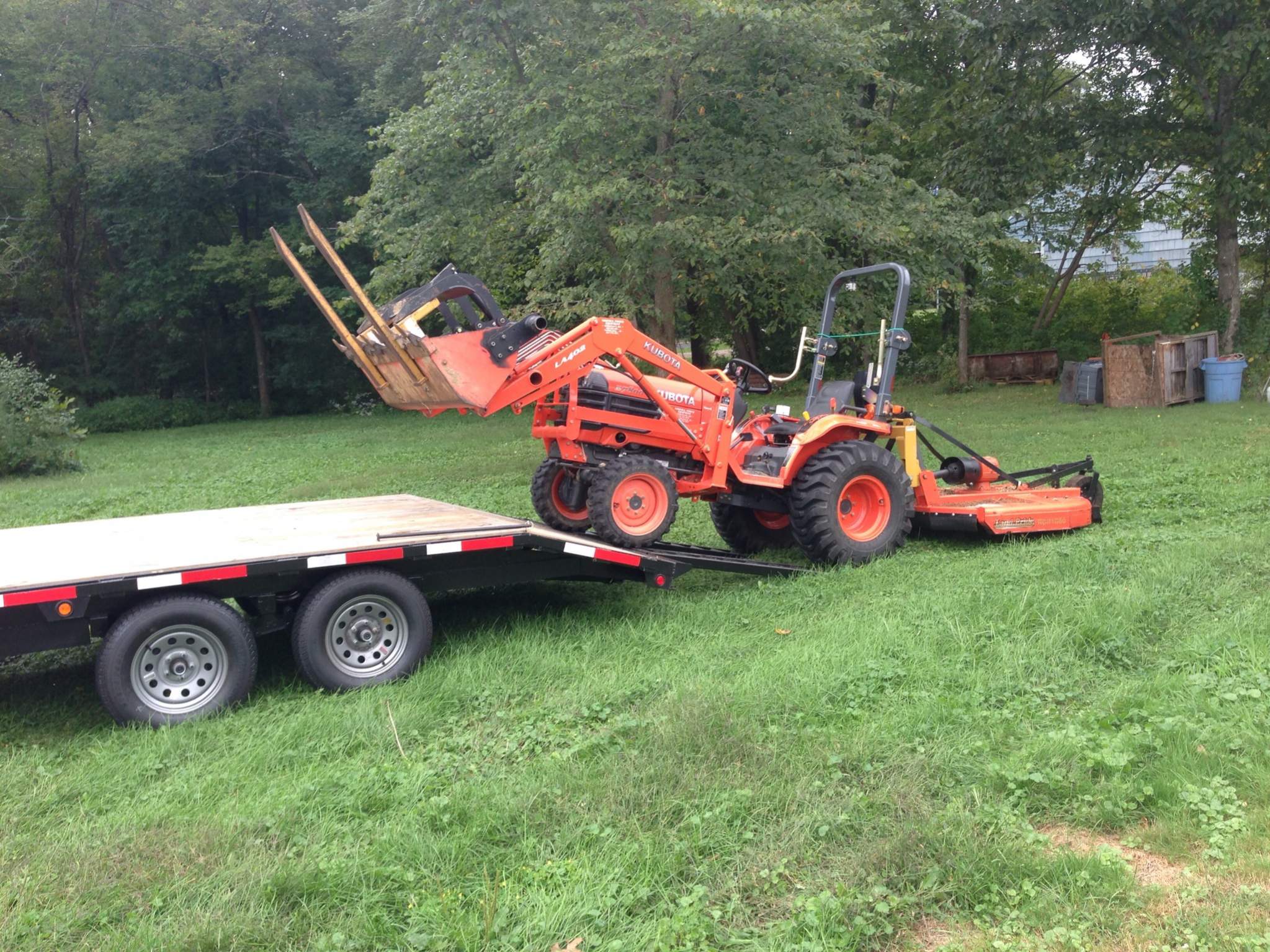

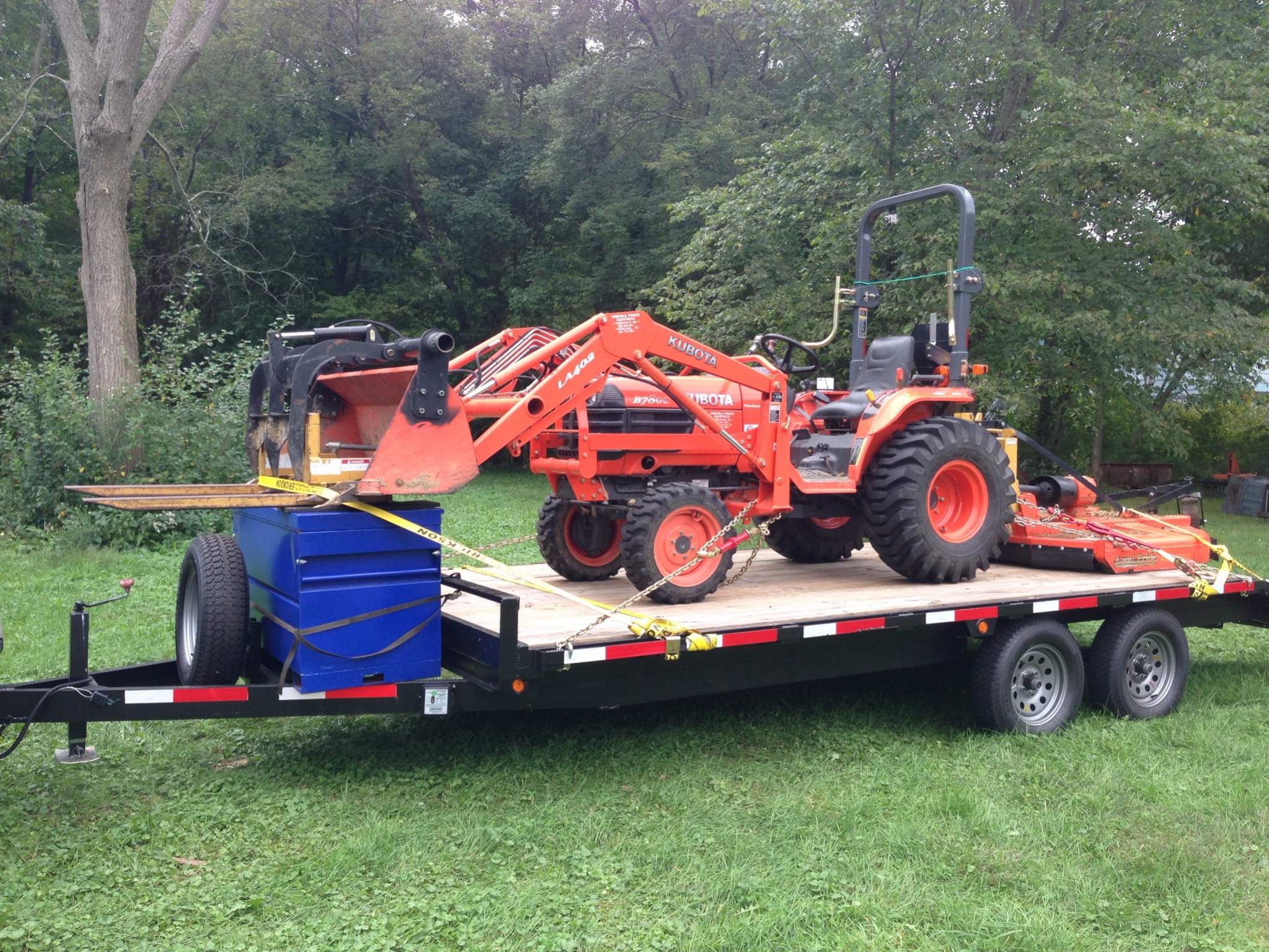

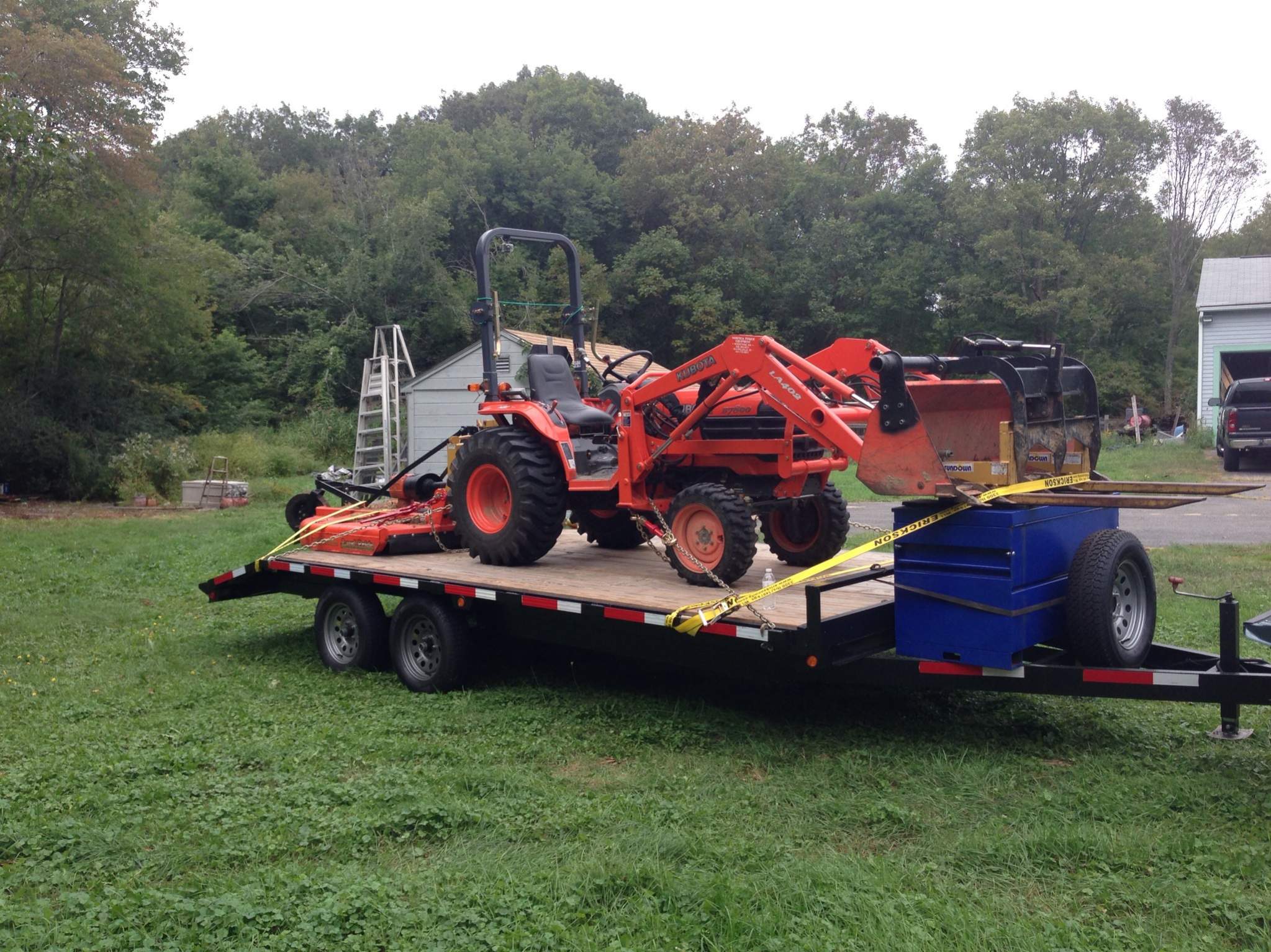

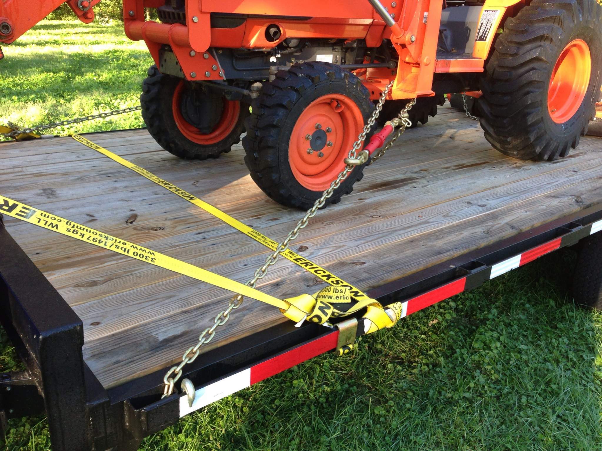

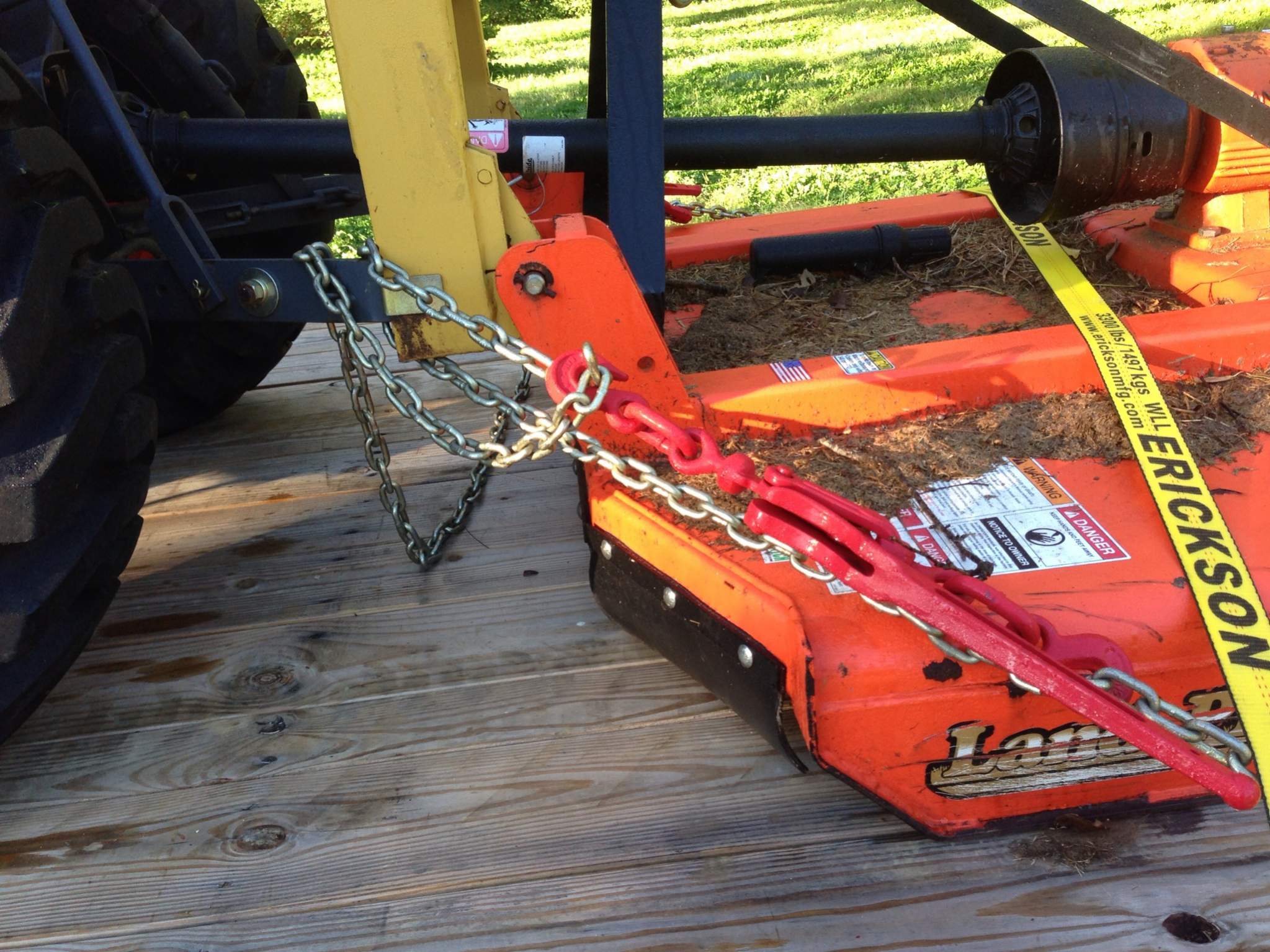

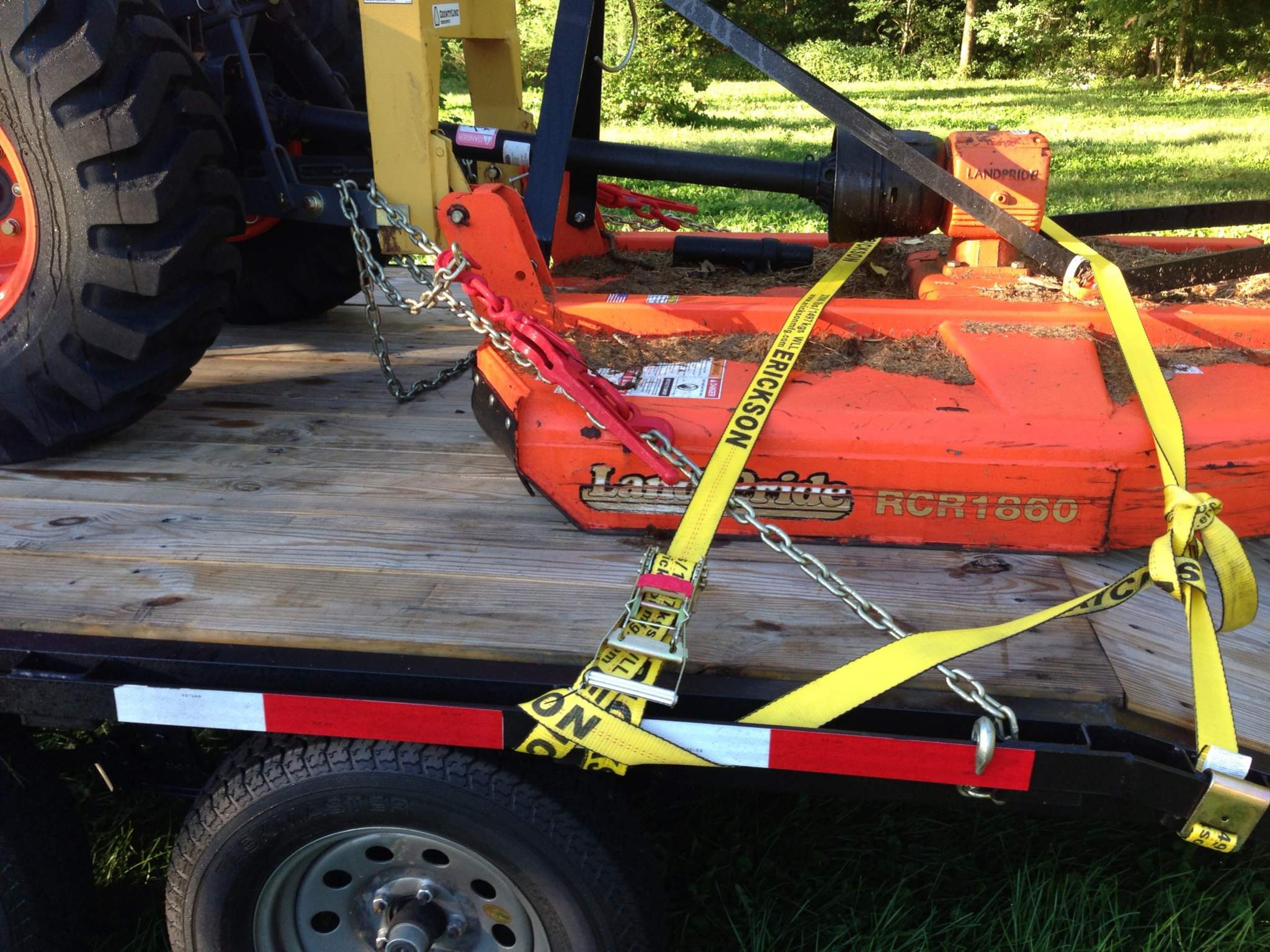

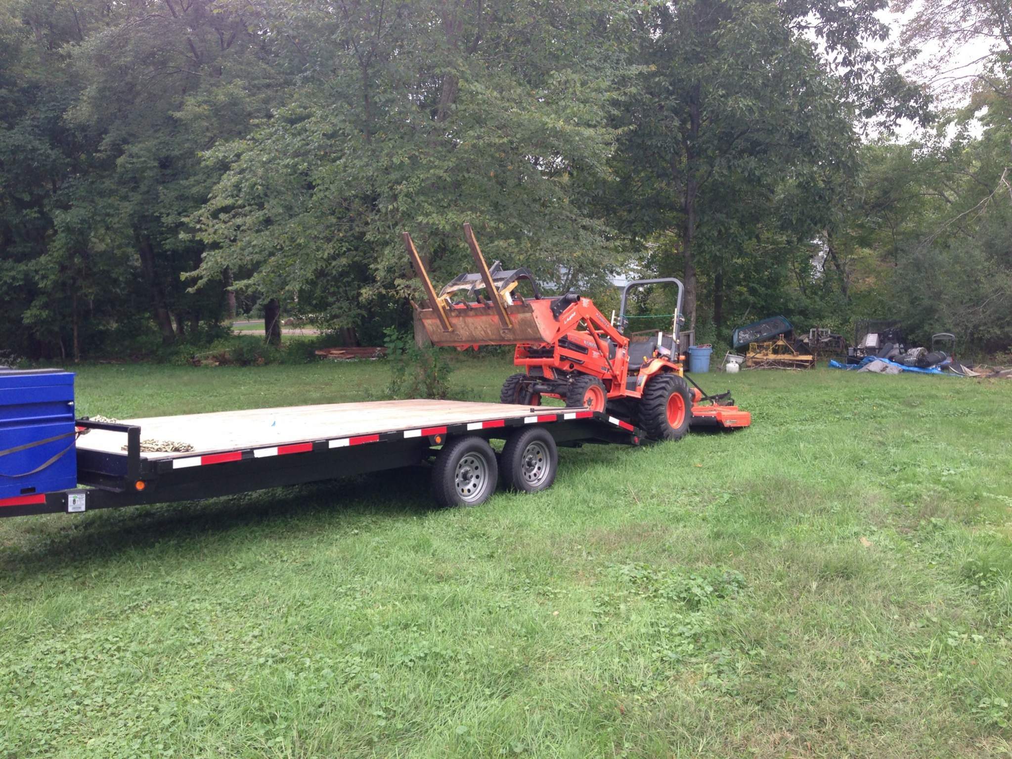

I have to move a shed for a guy tomorrow morning. It's a rather small building, I'm planing on lifting it a putting it on rollers and simply pushing it with th tractor

Hopefully that toolbox is very stout. Would it have been better to back on having the forks on the back? Lots of rocking forces going to the toolbox.
/ Loading and binding down the tractor to my Deck Over #7
Looks good to me. The only thing that could shift might be the curl cylinders on the FEL, but I guess that would only tighten the strap across the forks maybe.
I would probably fold the ROPS, just because.

I would have put a strap on each rear wheel to take the load off the 3 pt hitch.
The chains and binders are the only things that have any real tension. The straps are just snug over the loader an brush cutter. There is no tension on the 3 point hitch as the mower is on the trailer deck. Most of the time I never strap them down whe they are attached to the tractor but the job I was doing was for a local cop

The only thing that I would change is to put a large shackle on the draw bar and put your rear chains to it in lieu of chaining to the three point.

Chaining to the 3 poing hitch with a quick hitch is likely about the least stressful thing I put my 3 poing hitch through. I use a lot of ground engagement implements with my 3 point.
I do have shackle through the draw bar but never used it for binding the tractor down. I would consider it if there was nothing on the back of the tractor. I prefer binding from 4 corners rather than a single point. I would never trust a strap to hold the tractor on the trailer, after being in the trucking industry for the past 20 plus years the failure rat on straps is very high.
