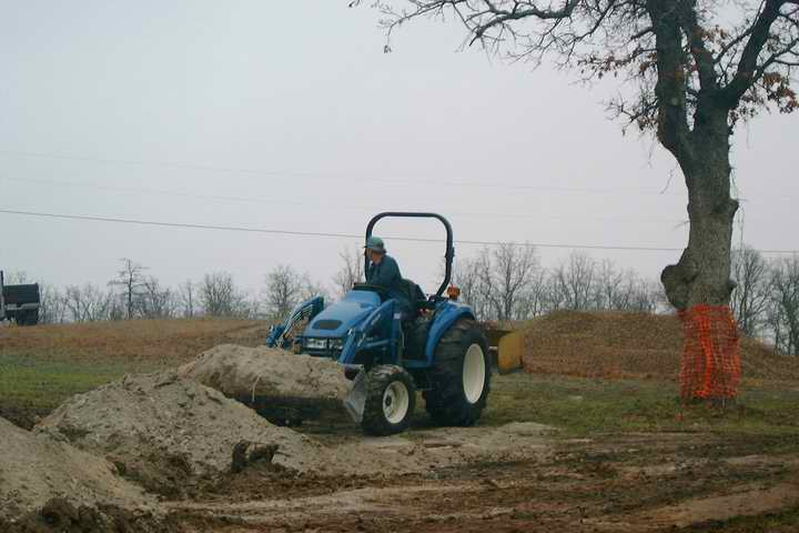

Nuru & JM-III: Thanks for the kind sympathy for my dad. That incident was forty years ago when I was 14, but I still remember it very clearly. The injury didn't slow him down much in the long run and I had to beg him to stay off that tractor when he was 84. He loved his little Ferguson TO-20 and used to brag about how much better it was than a Ford 8N. He passed away when he was 85 and was very active right up until two weeks before his death. He wouldn't/didn't want anyone feeling sorry for him.
Nuru, thanks for having a sense of humor about my "illustration"./w3tcompact/icons/shocked.gif We are all the "donkey" at some point in our lives./w3tcompact/icons/blush.gif Just last week we did a groundbreaking on my new house and I was helping move dirt with my NH TC45D. I have a 72" loader bucket, and I had it heaped with sand most of the time (attachment). Even with my boxblade on the rear, as I approached the dumpsite going downhill, the nose of my tractor wanted to take a "dive" and lift the rear wheels. My "pucker muscle" got plenty of exercise. It's amazing how much a full bucket of dirt can weigh. When you get your scoop, just please be careful. It's okay to brag about how much you can lift with your tractor, but it's also okay to feel good about how safely you can operate your tractor. If your rear scoop is full, the same rule applies as for a FEL bucket. Keep your load low, and if the tires come off the ground, drop the load to the ground and get the situation under control. Good luck.
