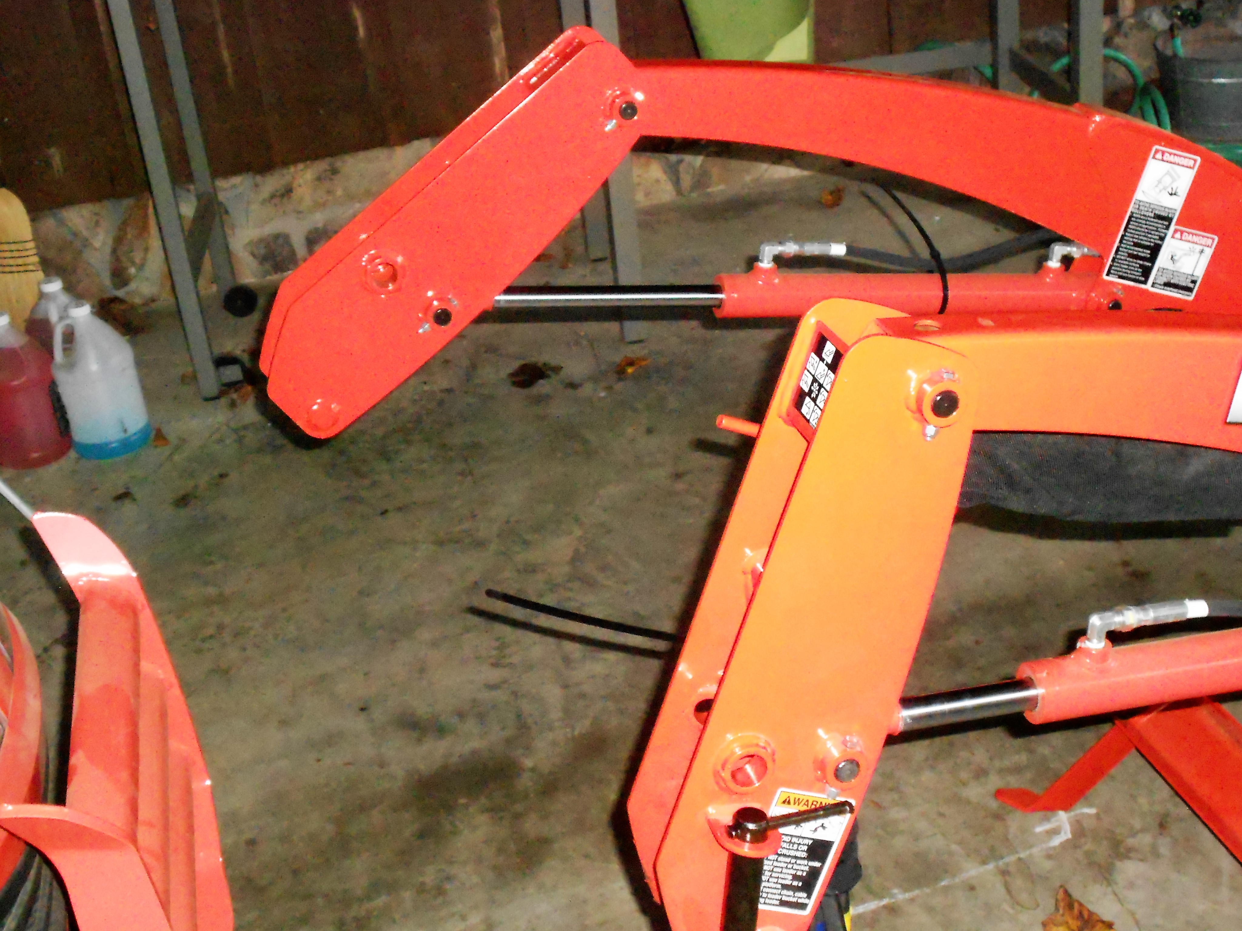

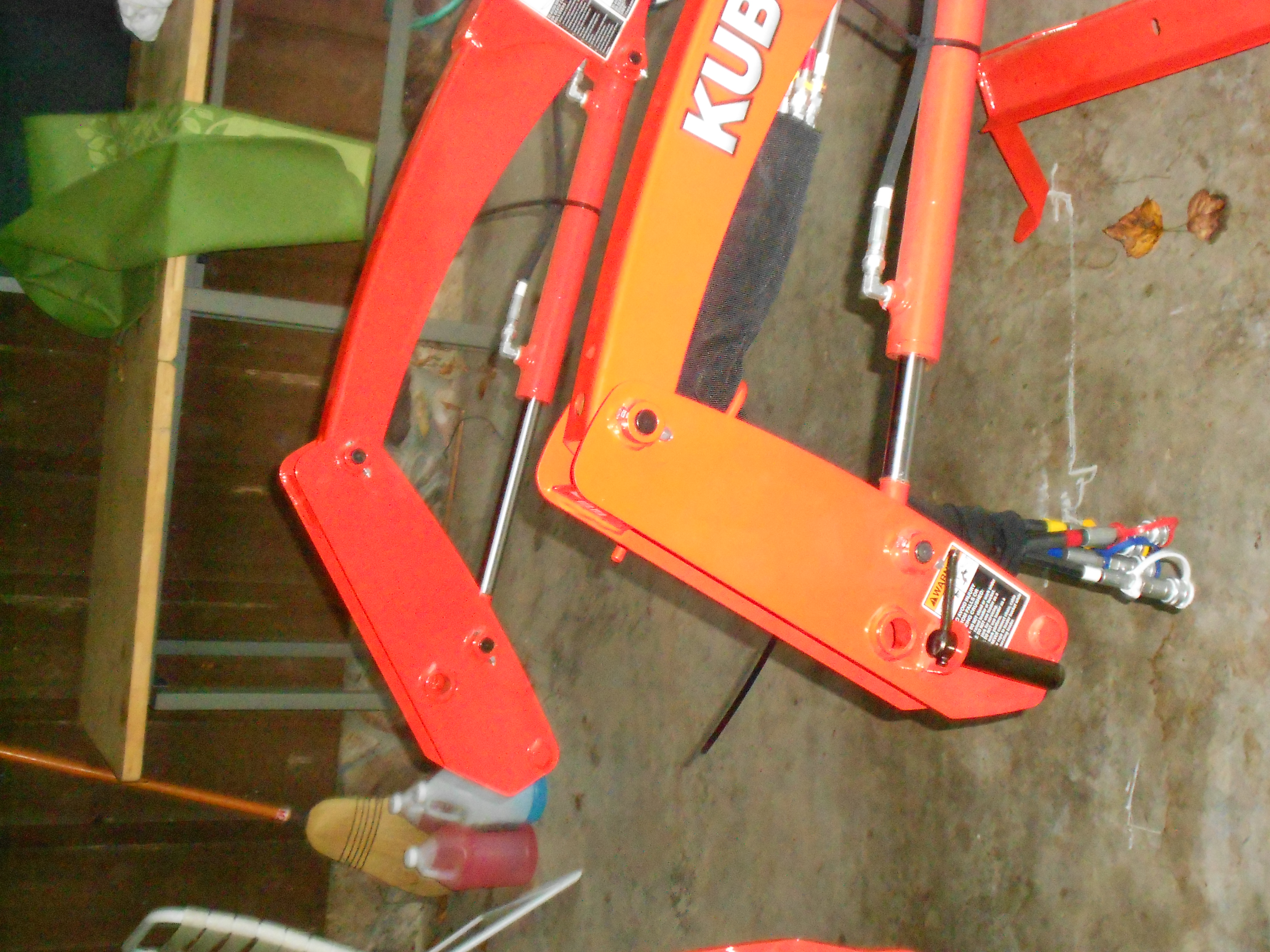

Second problem is that somehow the loader pistons are of unequal length on each side. Not sure how I did that. When I go again to hook up the loader I will probably only be able to hook up on one side since the other side is shorter. Has anyone ever had this happen and what is the fix?

No doubt its a safety switch issue. PTO lever completely disengaged, seat safety switch,sit on tractor while starting. tractor in neutral.??? Cylinder being shorter then other ??? did you know that when removing and installing the loader that when you use the joy stick lever to move the arms out of the way that one cylinder will move in or out before the other one does. Read your manual on how to install and remove your loader I'am sure you'll figure out how it works etc:
/ Loader pistons different length problem
I didn't know one cylinder moves out faster than the other. This is the first time this has happened. I'll try to attach some picures. I wasn't sure if that is a problem or not. It will just be hard/different to put the loader back on when only being able to attach one side first DSCN0255.JPGDSCN0256.JPG

Just drive into the loader, they will equalize. You can probably push it back in by hand!!
Haha yes you were right. I was able to push it back in. Thank you, I have much to learn ha.
