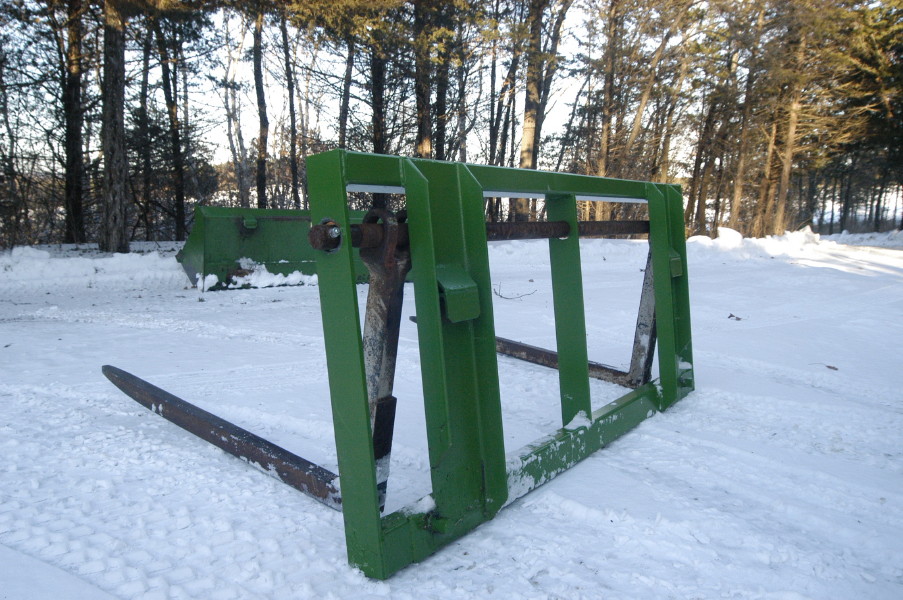

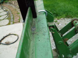

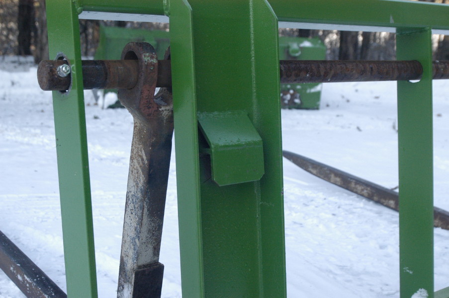

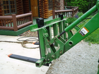

Just a note guys, the hooks and pins can be made very easily from 1 1/2" angle iron and CAT3 pins. Take a look at these pictures below:
