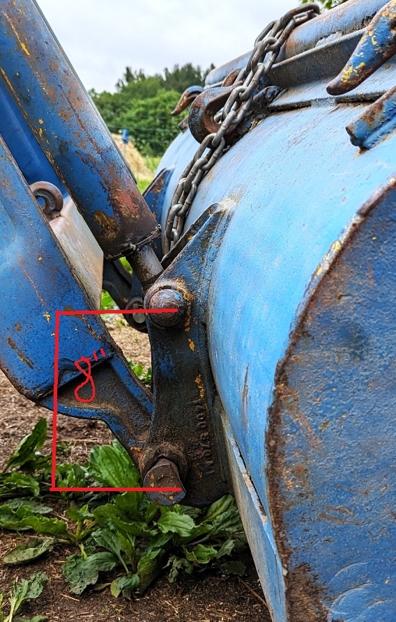

That depends entirely on how you mount the skeleton plate. I just did one on a pretty new Kubota B series FEL. I ordered and received the Kubota 2 pin SSQA loader end and a correct skeleton plate. I removed the original welded on bucket ears, ground the back face of the bucket to remove the rest of the left over welds and welded on the skeleton plate and the bucket is actually closer to the fulcrum point than it was pre SSQA. Customer wanted all Kubota parts so don't ask what it cost because you don't really want to know but I will say the Kubota 2 pin SSQA was 100% plug and play. Very easy install. I have both the OEM Kubota SSQA as well as the ATI SSQA on my tractors and while I prefer the ATI 2 pin because it's more robust, either one works just fine and I can mount either of my buckets or forks on either one, no issue.
Looking at the image that the OP posted, I'm not seeing how the SSQA FEL bracket and the plate for the attachment could fit in between the pins and the attachment and be closer to the pivot point than what it is now. He's only got perhaps 3-4" at most from back of bucket to center of bottom pin as it is.

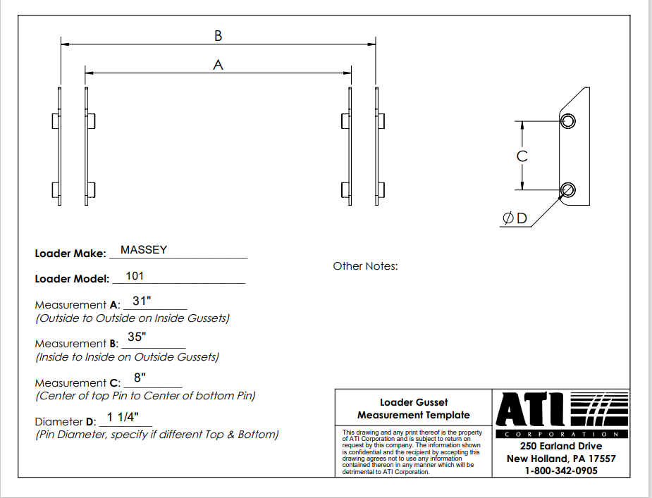

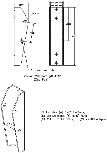

There's a few hundred SSQA plates available online but they don't have brackets, probably because there's 1 bazillion bracket configurations. Which leads us pack to my post, cut off and weld on my original bracket or is there a pin bracket available I should weld on?
As popular as the Fords were you would think a bolt on (Pin On) option would be available.

I have an adjustable pin-on SSQA adapter that'll fit all kinds of FEL widths with 1" pins. I never used it and sold the tractor I bought it for. Cost ~$600 years ago but it's worth $50 to me now. PM me for pics or measurements. It's in the barn somewhere.
I also have a SSQA adapter/plate that welds onto a bucket. Cost a couple hun but I won't be using that either. Another $50 if I can find it a home. I need the storage space, and I'm not far from Ann Arbor. Just sayin'.
It won't be closer. More parts... Although probably not that much different from what he has.
However, he also posted that he has some bale spears attached to the old bucket (which likely contributed to the stress on the old bucket).
pxl_20240527_135415509-jpg.872352
So, using a dedicated forklift/spear plate rather than the bucket will save a lot of distance hanging out.

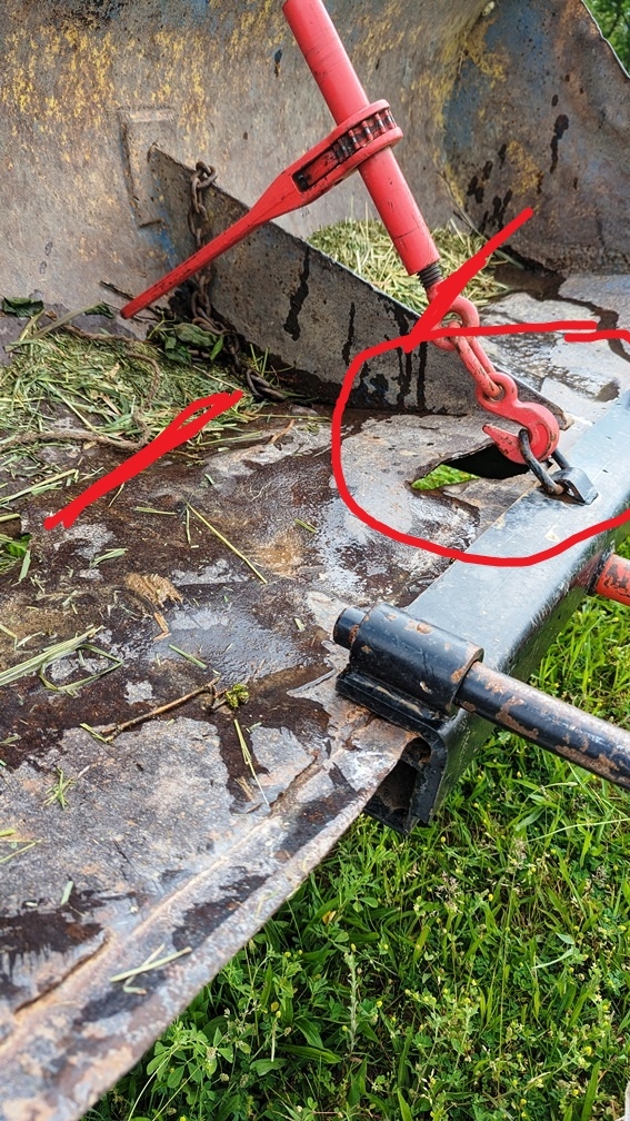

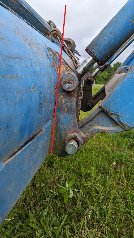

Not a great picture but circled is a massive split in the bucket and those lines I drew are where the bucket is so thin it's collapsing also.

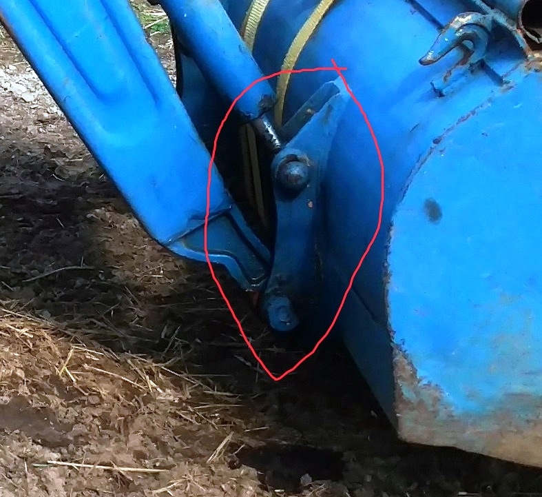

I'm wondering about using the existing bracket because it would to be in a straight line to weld onto a SSQA adapter. Thoughts on cutting it straight?
pxl_20240527_135434777-1-jpg.872351
You could probably cut it out straight enough, and that may not be a bad idea if you are 100% planning on scrapping the old bucket. You could add some more material if needed.
However, I'm not sure I would choose that.
It looks like the lower pin hole is already hogged out a bit. So it would need to be reamed and bushed to make it useful.
If you don't have a self leveling bucket, then it is possible that the distance between the upper and lower pins could be adjusted somewhat to suit the application (put them where the stress will be on the bucket mount).
Do you have access to any machine shop equipment? Milling Machine, large reamers? Etc?

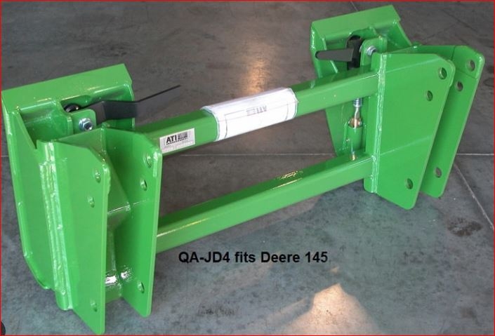

There are 3 kinds of QA loader interfaces: Skid Steer, JD, and Universal. You have to decide which one works best for you AND what attachments & features you think you will be using. I bought the JD system because I saw so many problems with flimsy plates, disconnections, handle levers not engaging, and fitment on Skid Steer stuff. I bought a new bucket, forks, (have yet to put the bucket on !!! after 2 years because forks are so handy), and some extra plates which I used to mount a front hydraulic post hole digger. The Deere interfaces are cast steel, not stamped/ folded 1/4" stock. The kit was not intended to fit my loader, but a little grinding let me set the cylinder ends into the castings. Lateral span is not an issue because the cross rod used to keep the brackets in sync is infinitely variable. I now wish I had a self leveling loader. Anyone ever tried a leveling control valve instead of the usual multi-link mechanism ?
Right,
I'd research the different adapters and the implements that one is most likely to use.
This was posted a while ago with a brief discussion about different types of quick attach implements.
I'm wanting to start interchanging attachments on my CAT, but ultimately it will be easier to make and maintain the pin mounts than to try to find a very heavy duty quick attach from an old bucket loader.
   / Convert 70's tractor to quick attach plate, use original mount? #31

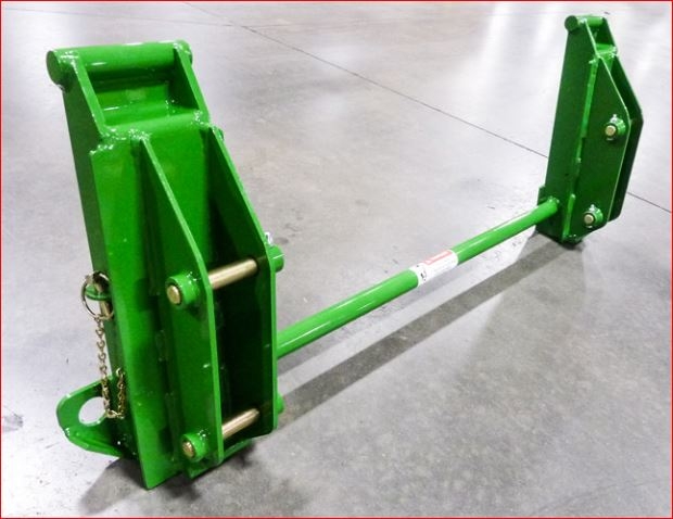

Turns out that my 'universal' is way wide for a tractor that isn't older yet, say 8" or more too wide for OP's. Shortening the main bar would make the QA pins out of position.
The red guy would need brackets welded on to pin to the arms and cylinders. You can see that it's not much wider than a std implement plate, .. which is 3/16" metal and would need backing plates to put something on it. I bought red for my TC33DA's 14LA and went another route with a pin-on kit that I could at least find.
